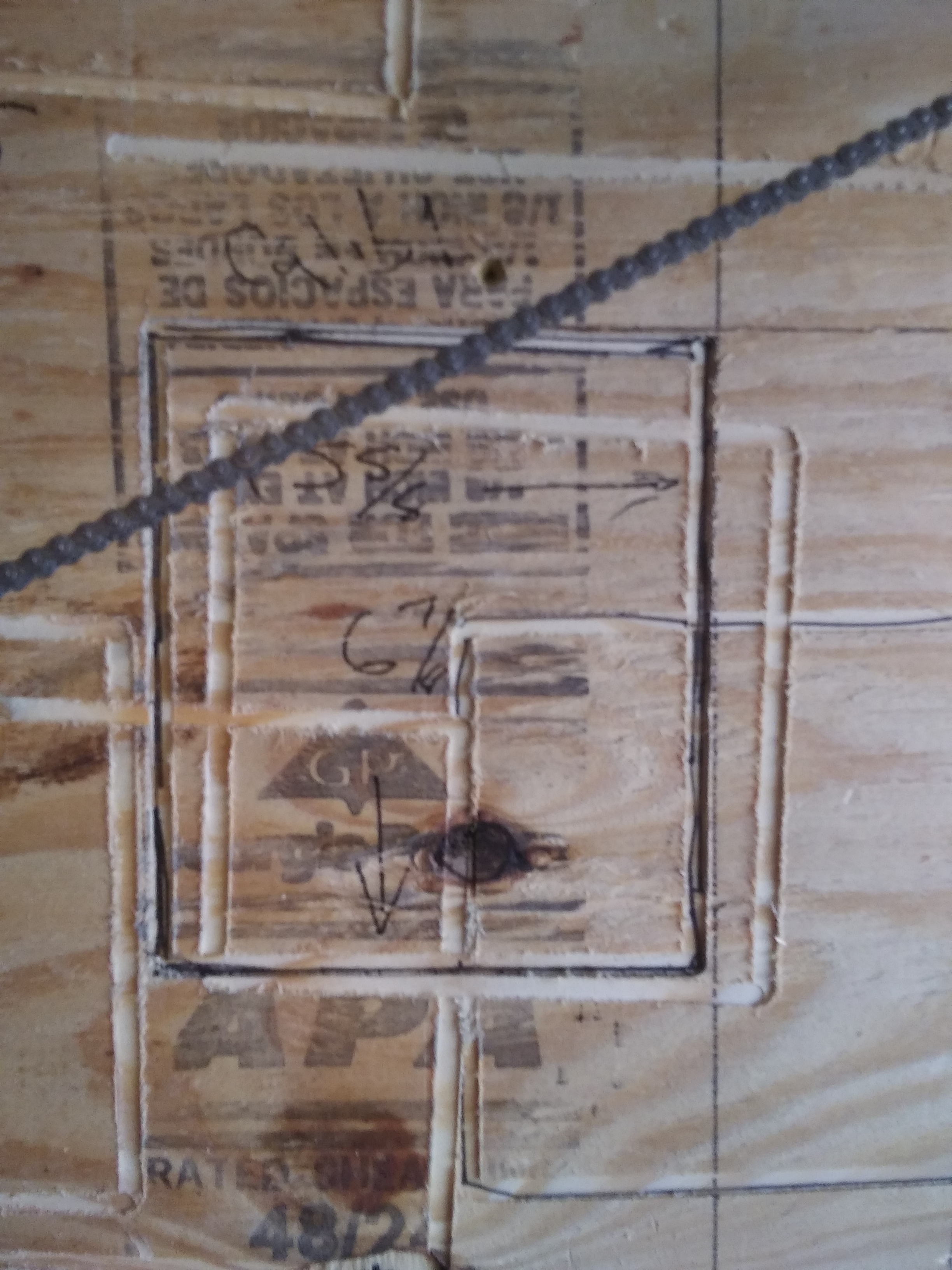

Okay I ran the calibration. Twice.
I have attached an image of the 6" square it cut.
it cut it as a parallelagram. 5.75" wide x5.125" tall with a slope on the x axis of 1/4" over the length of the cut.
I mean this is a better result than no motors at all. But something is still off.
Previously when I was running 1.26 I had to upgrade to 1.27 to stop the parallelagram cuts.
I appreciate all the hard work surely we must be getting close now.

That’s pretty poor results. Did you double/triple check your measurements and that you entered them properly? I don’t mean to be insulting, but it happens to the best of us.
You also clicked ‘Accept Results’ at the very bottom after doing the ‘Calculate’?

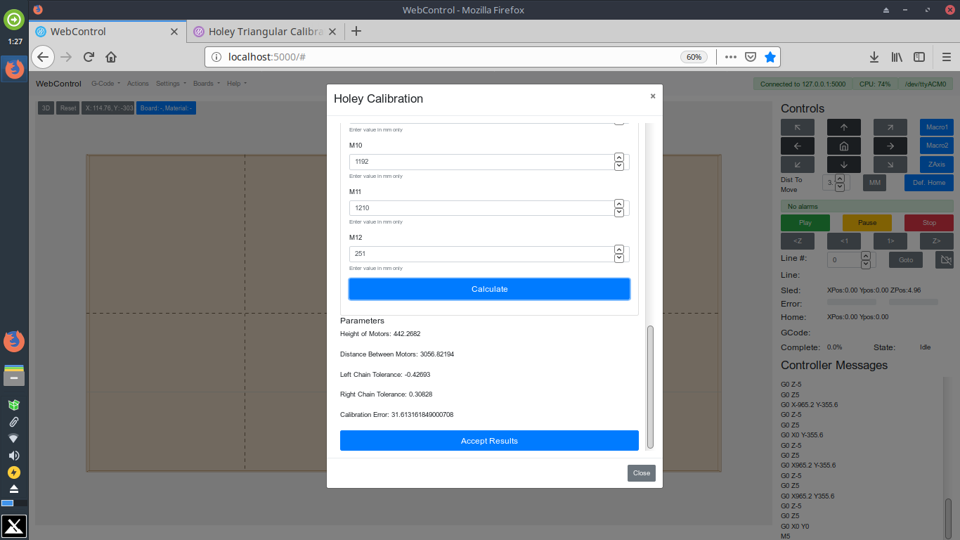

Okay ran holey calibration again. Cut. Measured. Calculated and accepted. Here is screen shot:
 ![Screenshot-11](https://canada1.discourse-cdn.com/flex031/uploads/maslowcnc/original/2X/7/7617c1b8af3b5ff2b4944060be9bbd26af327791.png)

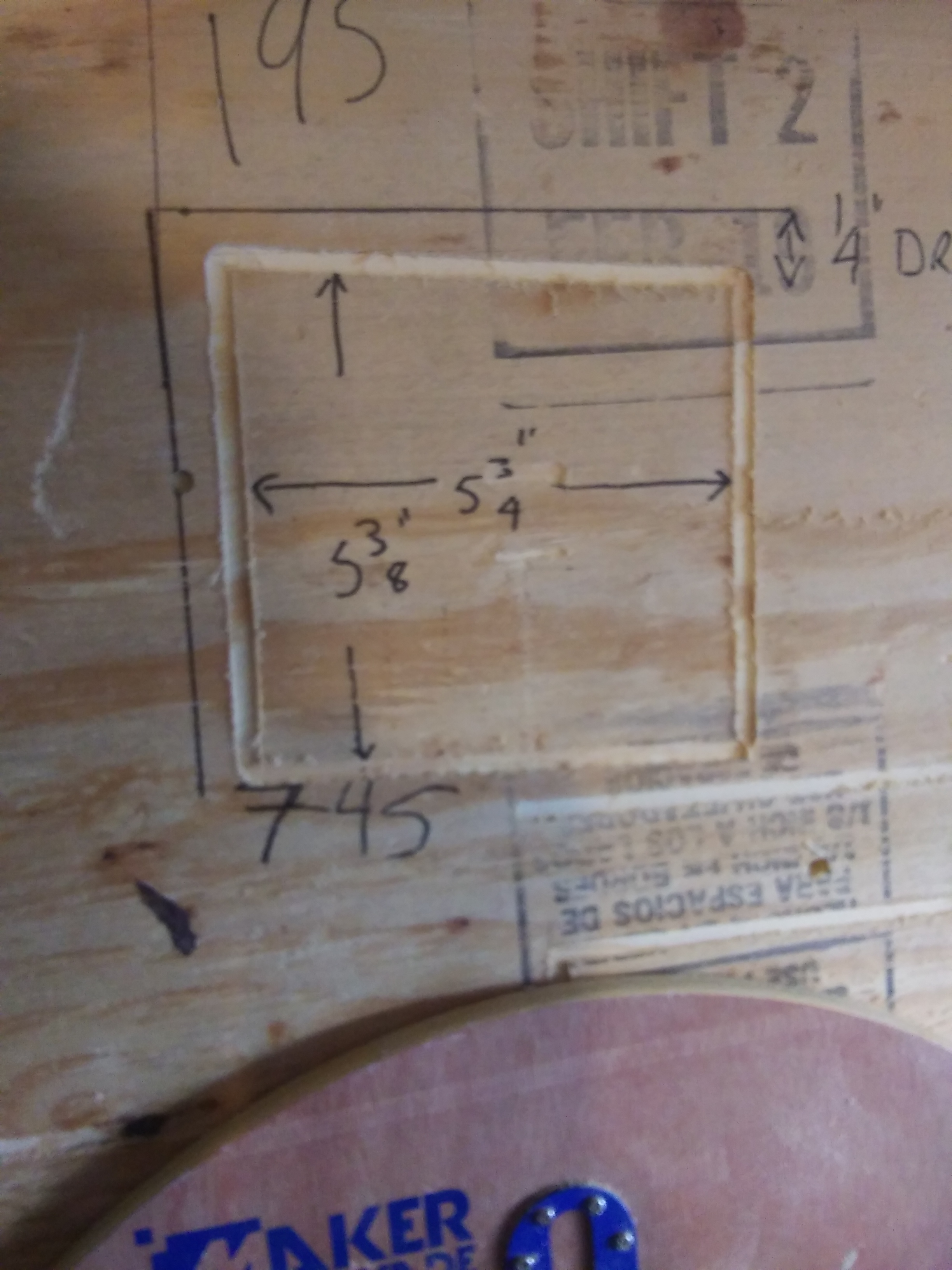

Afterwards I ran D Lang’s 6"square code and got this:
 ![20191015_133815](https://canada1.discourse-cdn.com/flex031/uploads/maslowcnc/original/2X/6/62ee7c54f773ff89102c4312236e5309e93acdcc.jpeg)
As you can see the cut was square. But the measurements were 5 5/8 wide x 6 7/8 tall.

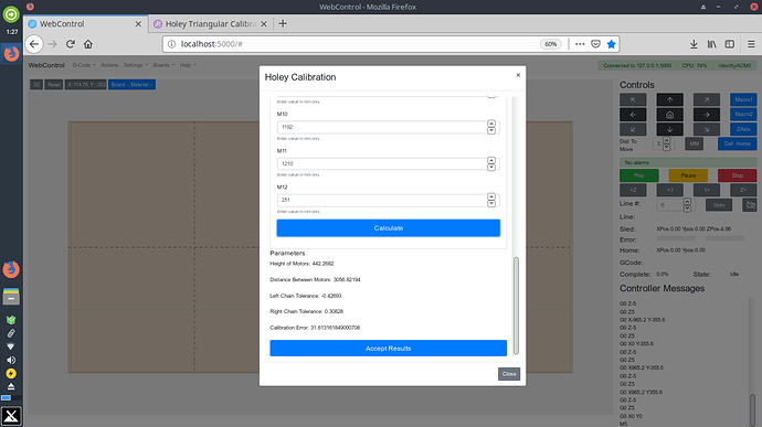

So I ran the holey again. Recut. Measured. calculated and accepted.
 ![Screenshot-12](https://canada1.discourse-cdn.com/flex031/uploads/maslowcnc/original/2X/2/2128b189f26fee91d14e5984af4fad845655ad30.png)

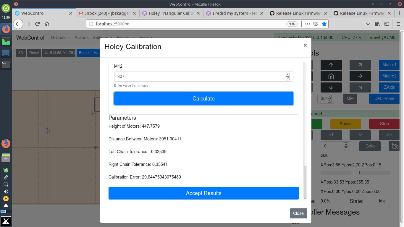

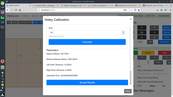

Ran Dlangs 6" square again. And got this:
 ![20191015_133822](https://canada1.discourse-cdn.com/flex031/uploads/maslowcnc/original/2X/c/c9a4fa8865dbd20431b7433fde62f5d94df487b0.jpeg)
The square dimensions were 6" x 6" but as you can see it is now slightly rotated.
So what do I do now?

At this point, I think it’s a calibration/setup issue… not a webcontrol issue. You may want to start a new thread asking for help to get a wide audience. But, if you could, go to Actions-\>Download Diagnostics File, and email it to me at madgrizzlemaslow at gmail dot com. I’ll take a look at the webcontrol.json and log files to see if I see something odd.

**Post date:** [October 16, 2019, 1:01am UTC](https://forums.maslowcnc.com/t/i-redid-my-system/11365/60 "2019-10-16T01:01:11Z")
having it be angled is odd, I’m wondering if one chain skipped a link and the
calibration is making up for that error but not the angle (the calibration
doesn’t gather enough info to detect the angle error)
