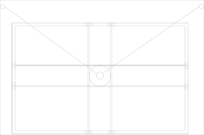

So since I’ve gotten into the idea of the Maslow I’ve felt like one of the largest limitation is that the cutting tool has to slide across the surface of the material, which limits mounting options and makes things a bit trickier. One solution I thought of was to set up the motors and router into a separate layer with cross-members that roll along the X and Y axes. This would mean a frame with a sort of clam shell design and lifters.
I’ll draft up this idea soon, I just wanted to see what feedback I could get on it.
Another potential advantage of this could be that with rigid enough cross-members it may be possible to mount a waterjet head or plasma cutter. My company mainly works with metal, so I want to find a way to maximize the potential of this machine towards that goal.
With that said, has anyone experimented with cutting aluminum? I would think with an added coolant line the Maslow should be able to cut soft metal.
Thanks!

I don’t understand what you are proposing here. diagram very much needed
people have talked about using rails before, and that could be made to work, but
would no longer be a maslow.

![MASLOW](https://canada1.discourse-cdn.com/flex031/uploads/maslowcnc/original/2X/b/b849c99aa67db31b2094f831f6a45cc679c300c3.jpg)
Here’s a quick sketch I made. The idea is to leave the rails unpowered on rollers and to simply have them restrict Z movement of the tool so that the sled doesn’t have to travel on the surface of the media. The motors would attach to the top the same as a normal Maslow, but that whole layer would be able to pivot up with lifters or something.

I’ve had this discussion with @dlang before. There is concern is that at the sides, the sled will “rack” due to angle of the forces and it won’t be reliable. @dlang, I’m sure, will say that if you go through this process, you might as well consider switching to a [COREXY](http://corexy.com/theory.html) system and eliminate calibration issues.

If you are going to have rails, and something to keep the rails parallel,
there’s no reason to have the chains going at angles (with all the complex math
that is involved with doing this), just put the motors in the corners to power
the things you have there to keep the rails parallel and you have a COREXY
machine ([http://corexy.com/theory.html](http://corexy.com/theory.html)) much simpler, widely supported by
existing software (LinuxCNC or grbl).
It would be a better machine, but a fair bit more expensive.

The wheels aren’t on the workpiece, they are riding on the backerboard. The problem would arise if you had divots in the backerboard, that is, you had used it previously to cut “normal” projects. You would want a fresh unblemished surface for the wheels to roll on. In a pinch, I would slip in a piece of masonite on top of the cut-up backerboard, giving a smooth surface and not changing the chain angle much.
The point of the ball transfers is that they are omni-directional, pretty low friction, and as long as the outriggers can be about 2x the width of piece being flattened, they allow the sled to twist pretty much just as if it were resting on the workpiece, per usual.
