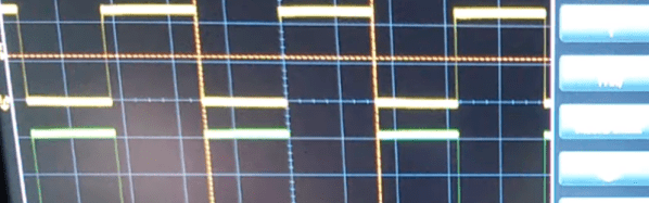

No idea if this is related, but HackADay is reporting an output bug in the pwm library
> **[Roll Your Own Arduino PWM](https://hackaday.com/2017/11/12/roll-your-own-arduino-pwm/)**
> Most projects are built on abstractions. After all, few of us can create our own wire, our own transistors, or our own integrated circuits. A few months ago, \[Julian Ilett\] found a problem using th…
**Author:** ![krkeegan](https://yyz1.discourse-cdn.com/flex031/user_avatar/forums.maslowcnc.com/krkeegan/32/17443_2.png) [@krkeegan](https://forums.maslowcnc.com/u/krkeegan)\
**Post date:** [November 12, 2017, 4:03pm UTC](https://forums.maslowcnc.com/t/increase-controller-update-frequency/744/15 "2017-11-12T16:03:13Z")
Interesting find. We don’t invert our output, so I think we are okay, but worth keeping in mind.
