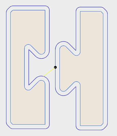

Hey All,
Received my maslow in the last shipment and have been tinkering with it ever since. I’m trying to do some wikihouse stuff and have come across something that is completely blowing my mind.
Whenever I try to do a puzzle piece like joint the piece that goes inside the other is way larger than it should be. I’m using fusion 360, I have double checked the measurements probably 1000 times and they look good. I’ve looked at the simulation in fusion and it seems perfect. I’m still thinking this is some issue with what i’m doing in fusion more than the maslow at this point, but since i’m completely out of ideas anything would be much appreciated!!
I was going to attach some files but since i’m a new member i’m not allowed to, sorry! Here some information that might be useful?
- standard frame
- final sled w/ ring system
- using a 1/8 inch bit
- 1/4 ply
- 20 ft/min feed rate
- the puzzle piece is relatively small ~.5"
Thanks!!

Are you adding an offset or tolerance parameter to one or both profiles?
> **[wikihouseproject/Wren](https://github.com/wikihouseproject/Wren/wiki/CNC-Manufacturing-Guide)**
> The language and rules for the Wikihouse structural system for 1-3 storey buildings, initially developed in the UK for European contexts - wikihouseproject/Wren
Their guide suggests .25mm - .5mm, which sounds bit big to me, but probably a good place to start.

@Jamtek Hey, thanks for looking into that! I don’t really have any tolerances setup besides the default in fusion360 (i can’t remember what it is) but if it’s all the same I would still expect the pieces to be far more similar than they are. Unless I’m misunderstanding?
**Author:** ![Jamtek](https://yyz1.discourse-cdn.com/flex031/user_avatar/forums.maslowcnc.com/jamtek/32/12604_2.png) [@Jamtek](https://forums.maslowcnc.com/u/Jamtek)\
**Post date:** [May 30, 2018, 2:13pm UTC](https://forums.maslowcnc.com/t/issue-with-cutting-puzzle-piece/4115/15 "2018-05-30T14:13:20Z")
I pulled in your model did an extrude and join in Fusion360. It looks spot on which is good in the modeling realm.
 ![image](https://canada1.discourse-cdn.com/flex031/uploads/maslowcnc/original/2X/c/c5fe8767c92f7d43cc09c537fbdb51a25bf1e40b.jpg)
But in the CAM side, I believe you have to add a clearance. I did a sketch offset of -.25 mm on the male puzzle piece contact edges and then did a push pull all the way through to cut it out of the model.
 ![image](https://canada1.discourse-cdn.com/flex031/uploads/maslowcnc/original/2X/7/7b01b1ed65daca52478ccfb50136bd91e9678f67.jpg)
You can now see a small gap between the pieces,
 ![image](https://canada1.discourse-cdn.com/flex031/uploads/maslowcnc/original/2X/1/13c344be2c9c4051858b0788e4e504695d94a8c0.jpg)
Im going to have to disagree with @Dru on unchecking ‘Rough Final’ in the CAM setup. Milling a profile on plywood probably would not benefit from a finishing pass and will add extra steps to your gcode, but I could be wrong. Im fairly new to CAM and Fusion myself, hope this helps.
Also, my want to check out Lars Christensen You Tube channel. He has covered the topic of clearances in a number of videos.

Thanks @Jamtek I will check out what you did and try and run it through some 1/4" ply! It is still odd to me that the piece matches exactly like you said but the measurements were literally .1355" (at the largest part) off from each other. I’ll let you know what i see though! Thanks again!
**Author:** ![cbcoolbox](https://avatars.discourse-cdn.com/v4/letter/c/bbce88/32.png) [@cbcoolbox](https://forums.maslowcnc.com/u/cbcoolbox)\
**Post date:** [May 31, 2018, 2:31am UTC](https://forums.maslowcnc.com/t/issue-with-cutting-puzzle-piece/4115/19 "2018-05-31T02:31:00Z")
@Jamtek i just cut it out and besides a little wonkieness I think is more because my sled isn’t slick enough it worked out great! thanks! I guess i thought their tolerance test was accounting for this! So for offsets I will be making one side all have a bit of an offset. THANKS A TON!!! I was super confused!

Try this post proscesser. It made a big difference for me. More can be found in the fusion 360 tag of the cam forum
[https://cam.autodesk.com/hsmposts?p=maslowcnc](https://cam.autodesk.com/hsmposts?p=maslowcnc)
Also consider measuring your bit with a caliper and entertaining that size into 360. Your bit gets smaller as you use it and so your parts get bigger.
