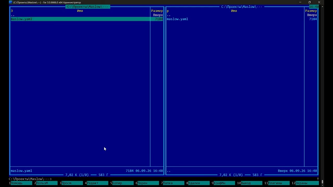

**Author:** ![airjt](https://yyz1.discourse-cdn.com/flex031/user_avatar/forums.maslowcnc.com/airjt/32/31540_2.png) [@airjt](https://forums.maslowcnc.com/u/airjt)\
**Post date:** [September 6, 2026, 9:58pm UTC](https://forums.maslowcnc.com/t/issue-with-decimal-separators/26143/8 "2026-09-06T21:58:07Z")
Hello.
I updated the firmware from your repository, which can be found here
> <https://github.com/MaslowCNC/Maslow_4/actions/runs/32983586499>
I recorded a video, but unfortunately, the problem hasn’t been resolved.
Basically, this bug doesn’t interfere with the software’s operation, but it’s still a bug.
You can watch it here.
[![](https://img.youtube.com/vi/dMqaBlNFkAE/maxresdefault.jpg "Maslow Issue with decimal separators") ](https://www.youtube.com/watch?v=dMqaBlNFkAE)
**Post date:** [September 10, 2026, 7:02pm UTC](https://forums.maslowcnc.com/t/issue-with-decimal-separators/26143/9 "2026-09-10T19:02:43Z")
That is super interesting, good catch! I’m not able to replicate it but I believe that is because it is language specific. My browser is setting the . at the divider instead of a ,.
It seems to me like the real solution is to remove the up and down arrows from those input fields. I don’t think that those are numbers we want to be incrementing by arrow usually anyway
