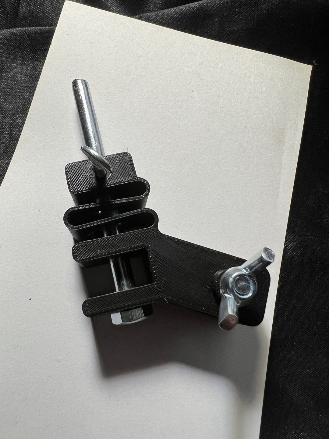

**Author:** ![Martha](https://avatars.discourse-cdn.com/v4/letter/m/c4cdca/32.png) [@Martha](https://forums.maslowcnc.com/u/Martha)\
**Post date:** [February 21, 2024, 12:39pm UTC](https://forums.maslowcnc.com/t/just-bought-an-m4-and-had-some-questions/19921/9 "2024-02-21T12:39:37Z")
I purchased an adapter but the length is more than the maslow4 can handle. Would have to modify adapter or add a additional sled to the maslow for thr needed height. Someone reported that sled smears pen before it drys . Sled using coasters might work and blowing air instead of vacuum might also help. Wanting to try. But right now trying to learn software. But i do believe it should be possible
Martha

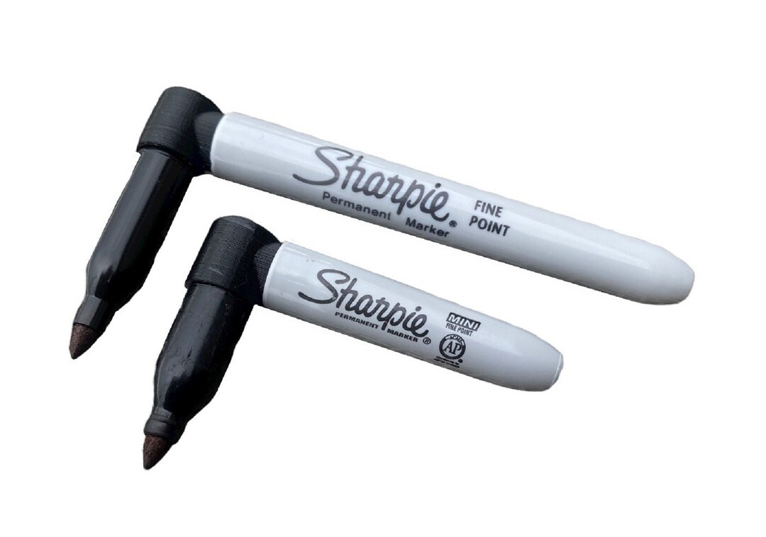

Here’s another interesting option:
> **[5 Right Angle Sharpie Adapters - Etsy](https://www.etsy.com/listing/1236541726/5-right-angle-sharpie-adapters)**
> This Tools item by DirtChurchIndustries has 99 favorites from Etsy shoppers. Ships from Sutherlin, OR. Listed on Feb 20, 2024
Edit: Those are a 3d printed part…if we just made the same thing but with a 1/4 inch part that comes up to go into the router I think it would work great
Edit2: Something like this, but with the 90 degree adapter built in:
> **[Cnc Pen Plotter for Router Sharpie - Etsy](https://www.etsy.com/listing/1631510201/cnc-pen-plotter-for-router-sharpie)**
> This Tools item is sold by XrayCustomCreations. Ships from Dearborn, MI. Listed on Feb 19, 2024

The etsy is the version i bought. But z azis connot compensate for the needed height. It fits great in the router. But needs about 3.5 inches. The bolt is 1/4" bolt with threads cut off. So fits in. Collet. I am wondering if a design jind of N shaped wher leg would fit in collet. Jog upward around nut on collet then install pen at angle would allow pen holder to fit maslow. Spring would still have to be on 1/4" bolt. Would be tight fit but might work. The also make mini pens that are shorter
