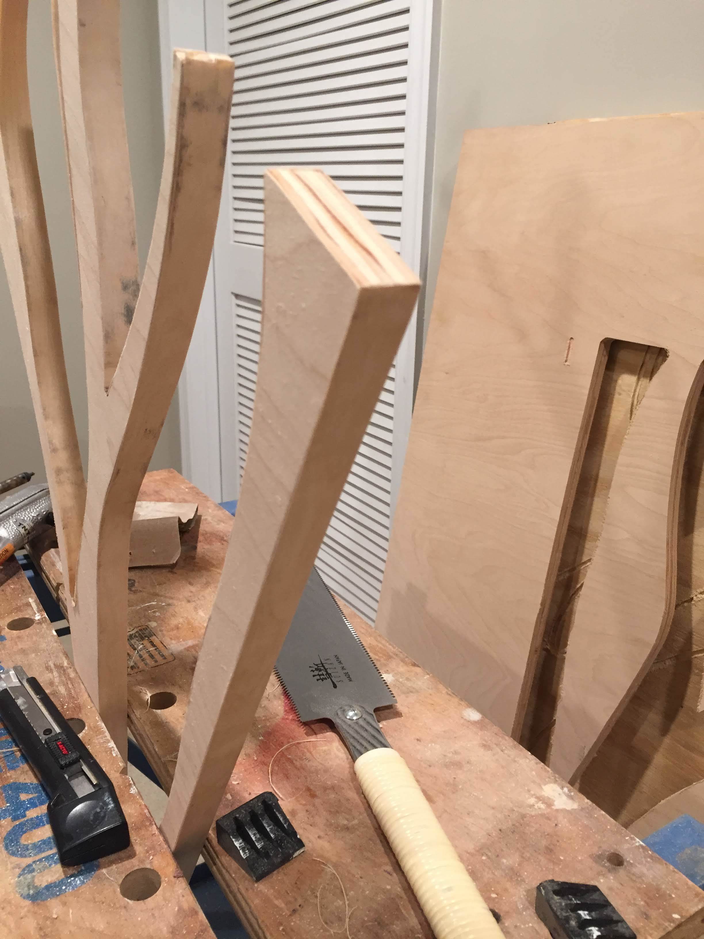

And finally, here is one mostly finished leg stack as of early last week. I only have a few hours a week to work on this project, so progress has been slow to say the least.
 ![20180508_213005](https://canada1.discourse-cdn.com/flex031/uploads/maslowcnc/original/2X/b/b68d6cdba406077dc7d452833e28d54e51ba5d10.jpg)

I’ve started applying the hot-melt banding to the edges of the legs, and I expect this part of the project will take about a week to mostly complete:
 ![IMG_2374](https://canada1.discourse-cdn.com/flex031/uploads/maslowcnc/original/2X/6/69bb6886a770866dd9d7bfcb94f182194cdee49b.jpg) ![IMG_2373](https://canada1.discourse-cdn.com/flex031/uploads/maslowcnc/original/2X/5/59f5f1e06b41cc96ed4d49dd27608b1ce5fc79ea.jpg)
Using a soldering iron to get into the tight corners and a banding iron for the rest.
