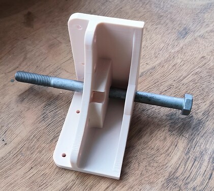

Can you shed more light on what flexy anchors looked like versus your rigid anchors?

**Post date:** [June 10, 2024, 10:49pm UTC](https://forums.maslowcnc.com/t/m4-calibration-results-from-flexy-to-rigid/21465/4 "2024-06-10T22:49:49Z")
**Flexy anchor**
It’s basically a spacer. The real support comes from the bolt going through the frame.
The inside of the aluminium box section is reinforced with some timber.
 ![IMG_20240608_134935~2](https://canada1.discourse-cdn.com/flex031/uploads/maslowcnc/original/3X/6/0/60caff4ee2bb983d8b89c61d5c2d6958b7cf8cf3.jpeg)
So in effect the bolt that runs through the cable end is only supported on one side. This would be similar to floor mounts for some people.
**Rigid anchor** (before being mounted onto the frame)
It’s screwed in place on three sides. Although not every screw hole was used.
 ![IMG_20240608_135043](https://canada1.discourse-cdn.com/flex031/uploads/maslowcnc/original/3X/6/6/66ecfb19587e4142079f9e318d928381c05e4ba0.jpeg)
Now the bolt is supported above and below the cable end, and it just doesn’t move.
