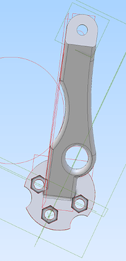

V2 of the Upright Adapter
 ![image](https://canada1.discourse-cdn.com/flex031/uploads/maslowcnc/original/3X/a/9/a93c41ca454ccd622be6e3c5853fd839a6d21531.png)
[M4\_UprightAdapterv2.stp](https://forums.maslowcnc.com/uploads/short-url/rfvnxF1fds9AdDwtiybS5IlI6UR.stp) (200.8 KB)
