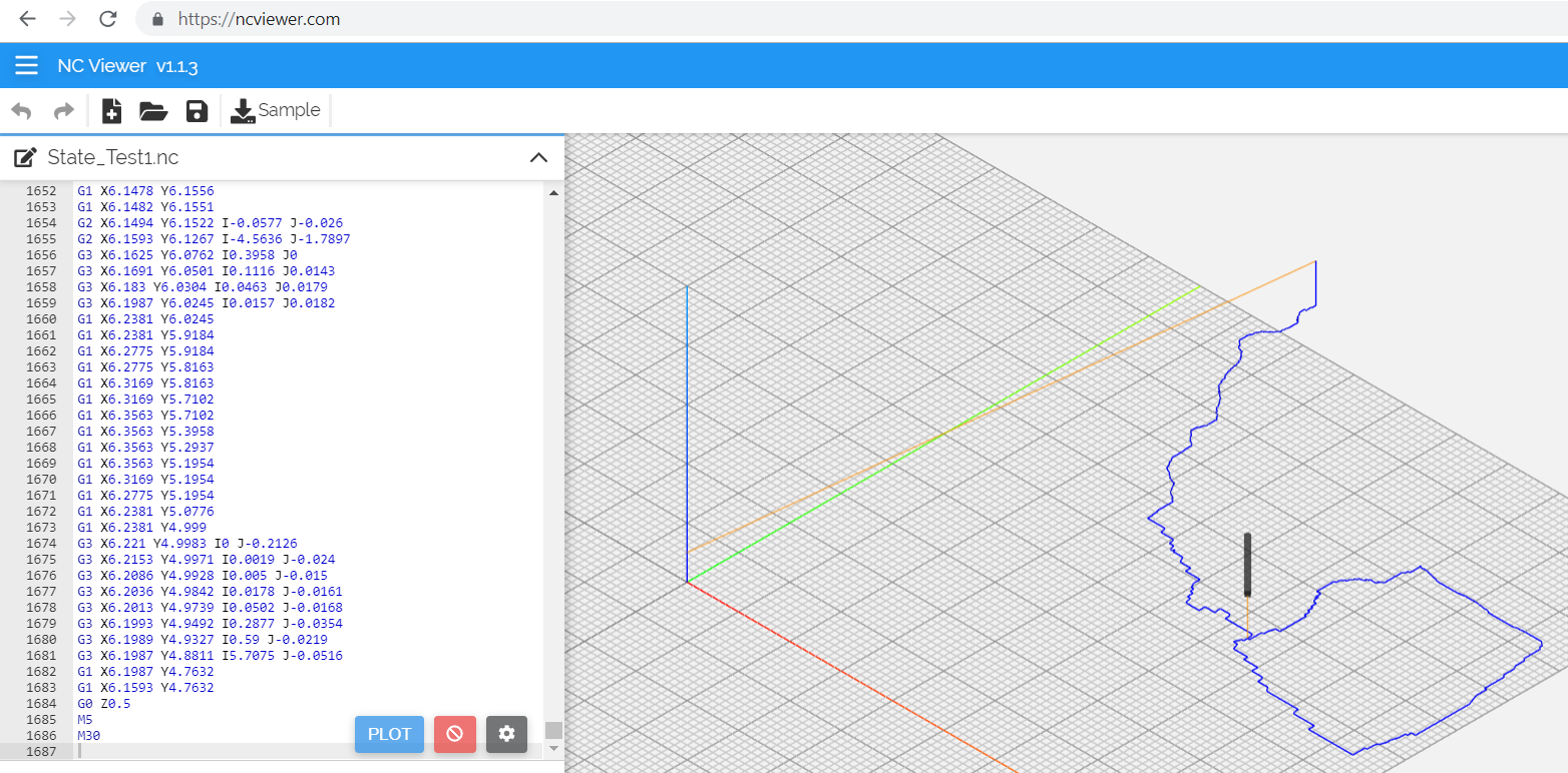

I’ve been using makercam and wanted a little more features and just started using jscut. I’m getting some odd gcode output from jscut that makercam does not do. I’m wanting to make a puzzle map of the US and I’m learning how to draw the map. I’m using Inkscape to trace state borders on a google map with freehand lines. In this example I started at the NW corner of CA and stopped at the SW corner of NV (click mouse button, draw one line, release mouse button).
**In makercam:**
Makercam does exactly what I expect by starting and stopping exactly where I started the freehand line. I’m wanting to cut out each state so I selected the “follow path operation” with the following settings:
 ![image](https://canada1.discourse-cdn.com/flex031/uploads/maslowcnc/original/2X/b/b58ea21789268c7fe198bf15c377c34c7578eccd.png)
[State\_Test1.nc](https://forums.maslowcnc.com/uploads/maslowcnc/original/2X/1/1f6096dd17f63c0dad36afa75316dc38ec33b82a.nc) (45.5 KB)
The gcode looks good in [ncviewer.com](http://ncviewer.com); 1687 lines:
 ![image](https://canada1.discourse-cdn.com/flex031/uploads/maslowcnc/original/2X/8/86da3e46cadfd812eb427b94387c1c5f83008771.png)
