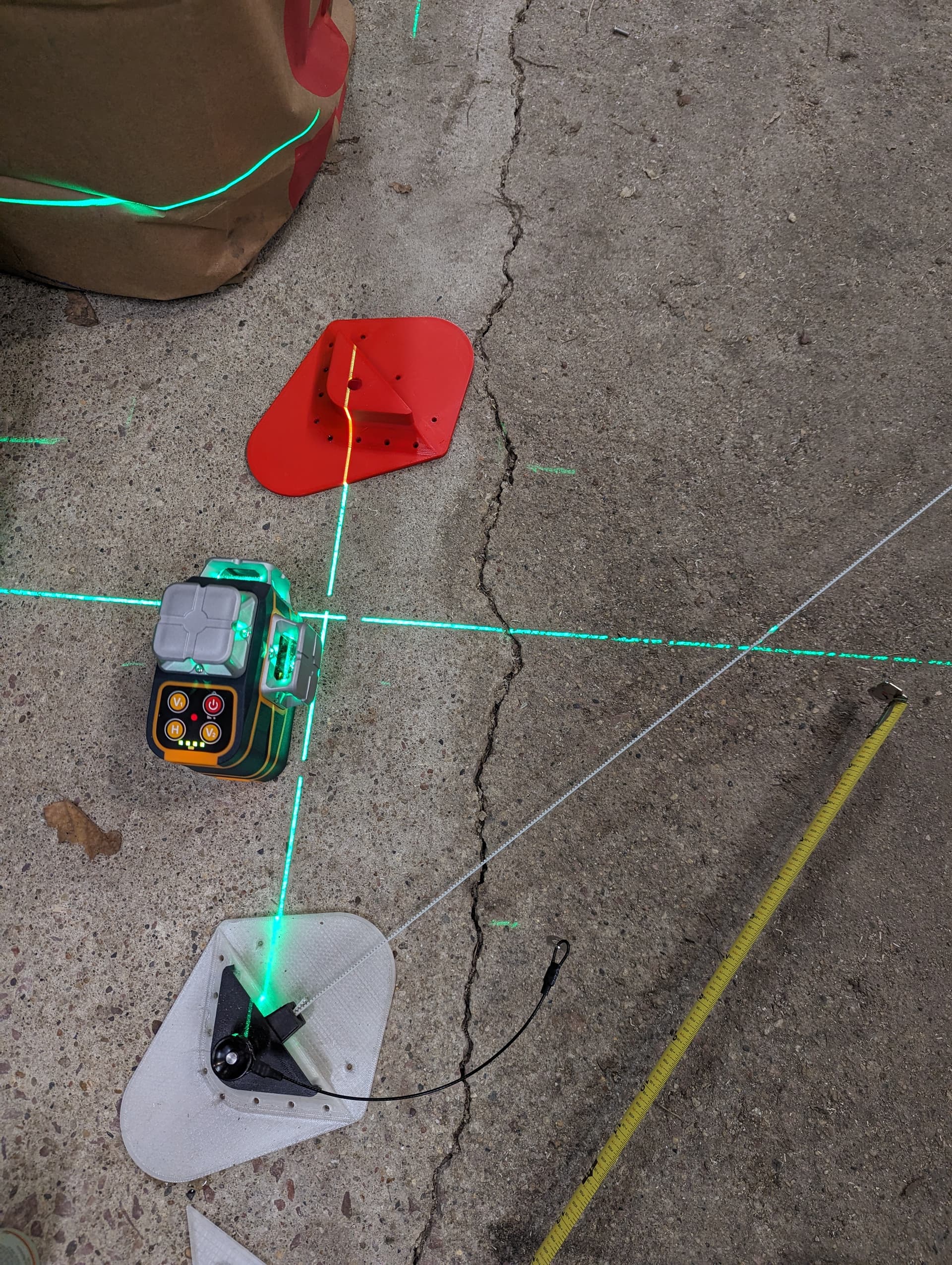

Well I’ve got 2 sets of anchors gluing overnight roughly 16" inwards. Will test tomorrow sometime.
 ![PXL_20240404_014334305](https://canada1.discourse-cdn.com/flex031/uploads/maslowcnc/original/3X/c/e/ce132aeb137f15736e819e3ccb9fdd6cc27ec741.jpeg)
**Post date:** [April 4, 2024, 2:40am UTC](https://forums.maslowcnc.com/t/maslow-29-buildlog/20077/163 "2024-04-04T02:40:29Z")
Unfortunately @ronlawrence3 tried a different dimension frame and still had the same issue so I’m not holding out too much hope…100% worth a shot though.
I’m continuing to rack my brains for what it could possibly be.

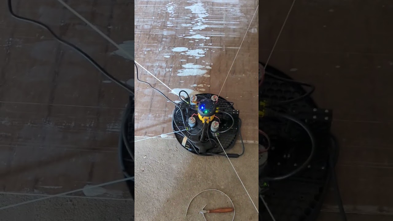

However having made the frame smaller I did notice something on the last point.
[![](https://img.youtube.com/vi/xE0dVqARd8M/maxresdefault.jpg "April 4, 2024") ](https://www.youtube.com/watch?v=xE0dVqARd8M)

I think that you are right that is an issue and when we fix that things will be better, but mine does that too 😕
I think that is the kind of thing which takes us from a 0.8 calibration to a 0.7 but I don’t think that could take us to 0.02.
I am going to work on trying to make the calibration work with just three belts (I think it is possible) and then run the numbers for each set of three belts and see if we can track the issue to just one arm.
I was also wondering (I literally had a dream about your calibration issues last night 🙄 ) if it might be worth fully wiping the firmware and starting fresh in case there is some funky configuration bug.

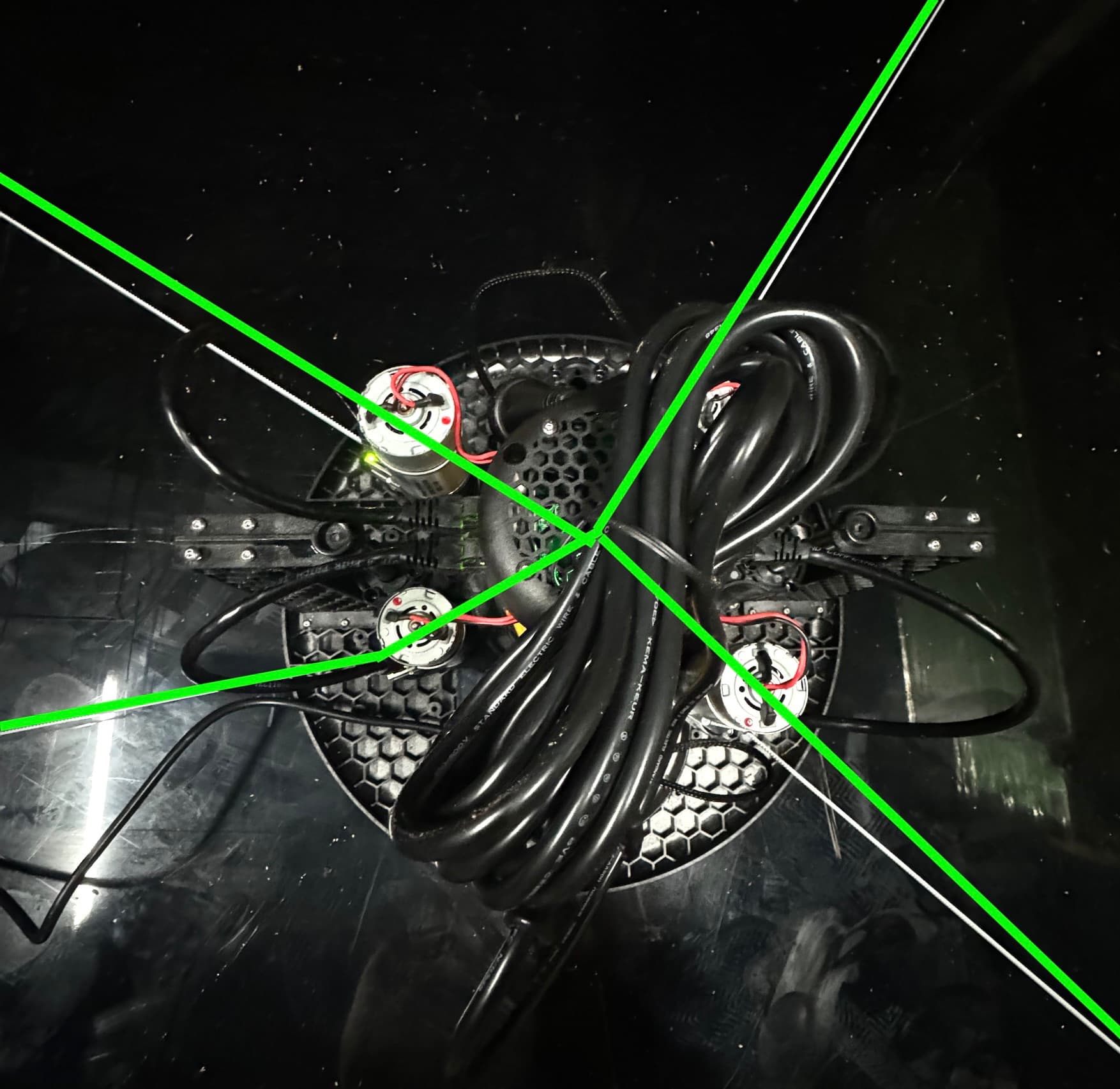

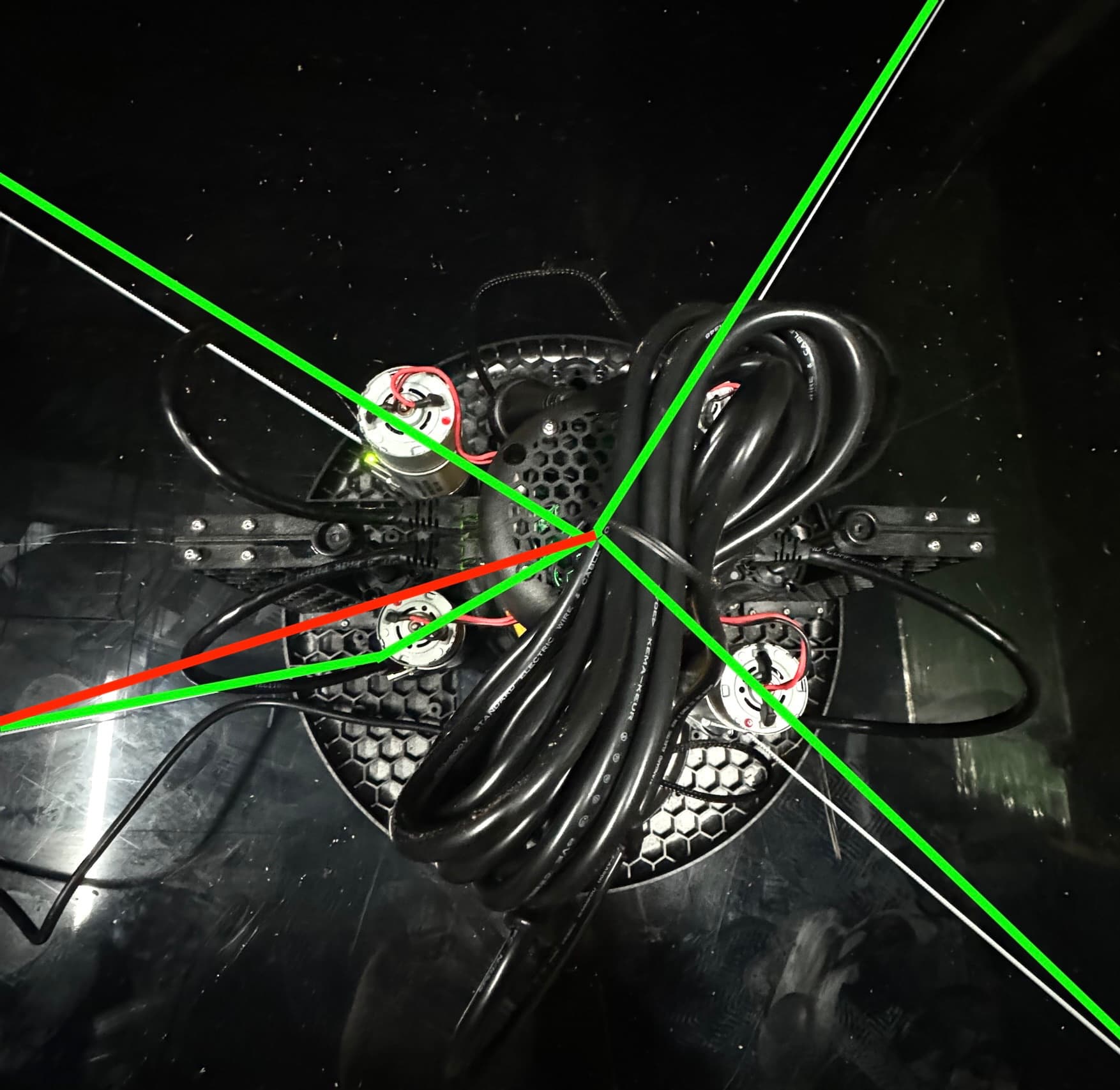

I could be way off here, but I notice in your video the bottom left arm has also run out of angle like mine does (I also have a large-ish frame, 4000mm wide)
 ![Screenshot 2024-04-05 at 5.20.39 am](https://canada1.discourse-cdn.com/flex031/uploads/maslowcnc/original/3X/2/0/200f35e7b8673e81a38b3c670ed56f3f1c731a2d.jpeg)
Does the calibration correctly account for the "extra’ belt length due to the bend at the rollers?
**Post date:** [April 4, 2024, 8:23pm UTC](https://forums.maslowcnc.com/t/maslow-29-buildlog/20077/169 "2024-04-04T20:23:57Z")
for reference, what is the frame size you expect?
This is ~13’x8’ and that is too wide, you don’t have the angles and so the arms
are going to be hitting the frame at the top and bottom centers, giving you
inaccurate results.
**Post date:** [April 4, 2024, 8:33pm UTC](https://forums.maslowcnc.com/t/maslow-29-buildlog/20077/170 "2024-04-04T20:33:12Z")
no it does not, that will result in readings that don’t match the others.
but doing a smaller pattern may avoid hitting the stops

**Author:** ![Scuba\_Shan](https://yyz1.discourse-cdn.com/flex031/user_avatar/forums.maslowcnc.com/scuba_shan/32/22722_2.png) [@Scuba\_Shan](https://forums.maslowcnc.com/u/Scuba_Shan)\
**Post date:** [April 4, 2024, 9:01pm UTC](https://forums.maslowcnc.com/t/maslow-29-buildlog/20077/173 "2024-04-04T21:01:30Z")
even though the distance from the spindle to the anchor is different because of the arm hitting the upright ?
 ![Screenshot 2024-04-05 at 5.20.39 am](https://canada1.discourse-cdn.com/flex031/uploads/maslowcnc/original/3X/3/a/3a7bf50a4da020a05f08edd4425a4204d2649dcb.jpeg)
**Post date:** [April 4, 2024, 9:04pm UTC](https://forums.maslowcnc.com/t/maslow-29-buildlog/20077/174 "2024-04-04T21:04:13Z")
Oh no I misunderstood, that is not taken into account. If the arm is hitting the upright that will impact the measurement. @dlang had it right.
I’m 99% sure that isn’t causing the issue that we are seeing here though with getting results like 0.04…I think that will have an impact, but not to the extent that we are seeing.
I could be totally wrong though.
The way to test that would be to run a smaller grid say 600mmx600mm so that it’s not a concern and see if that works the way that we would expect it to.
**Post date:** [April 4, 2024, 9:18pm UTC](https://forums.maslowcnc.com/t/maslow-29-buildlog/20077/175 "2024-04-04T21:18:22Z")
that assumes that the arm is in-line with the belt. If the arm has hit the
frame, instead of that being a simple addition, you have two arms of a triangle
and don’t know the angle or 3rd size so you cannot possibly account for it.
