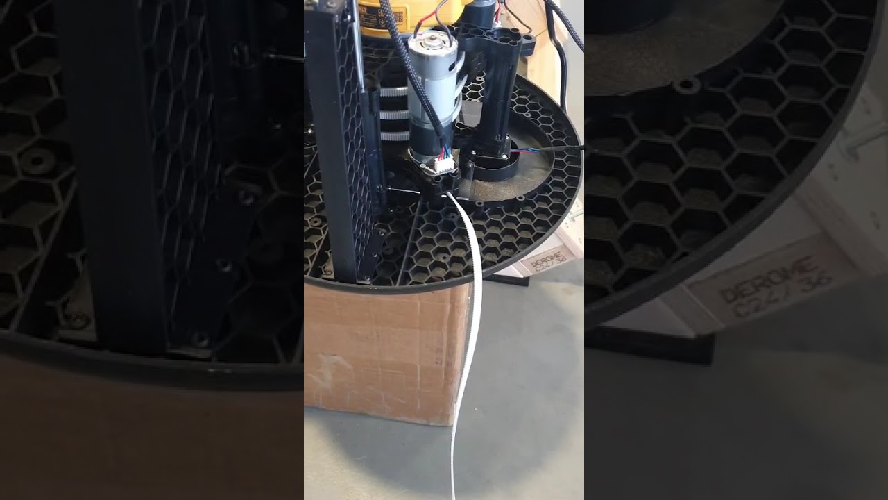

I am currently having an issue with the bottom left belt motor.
When pressing retract all, the bottom left motor will only retract about 2-3 cm each time, even at 2100 retraction force.
After reinstalling the firmware update, the belt did retract all the way, but now it stopped working again.
I have changed the bottom left arm with the bottom right arm, but the bottom left still doesnt work. (indicating it isn’t the motor itself but the main board maybe?)
I have added a video below.
[![](https://img.youtube.com/vi/wQAFY80129s/maxresdefault.jpg "Maslow 4.1 bottom left belt motor doesn't retract") ](https://www.youtube.com/watch?v=wQAFY80129s)

What happens if you extend that belt out by running extend all and pulling on it?
**Author:** ![Jimmy](https://avatars.discourse-cdn.com/v4/letter/j/ee59a6/32.png) [@Jimmy](https://forums.maslowcnc.com/u/Jimmy)\
**Post date:** [May 29, 2025, 8:08pm UTC](https://forums.maslowcnc.com/t/maslow-4-1-bottom-left-belt-motor-doesnt-retract/24196/4 "2025-05-29T20:08:37Z")
Extending all works fine, but it will only retract 2-3 cm each time I press retract all. Eventually got it to retract all the way (spamming the button), but also during calibration, it only extends and doesn’t retract. I have tried extending all after, but it still doesn’t retract all the way. A new main board is on its way right now, hopefully that will fix the problem.
