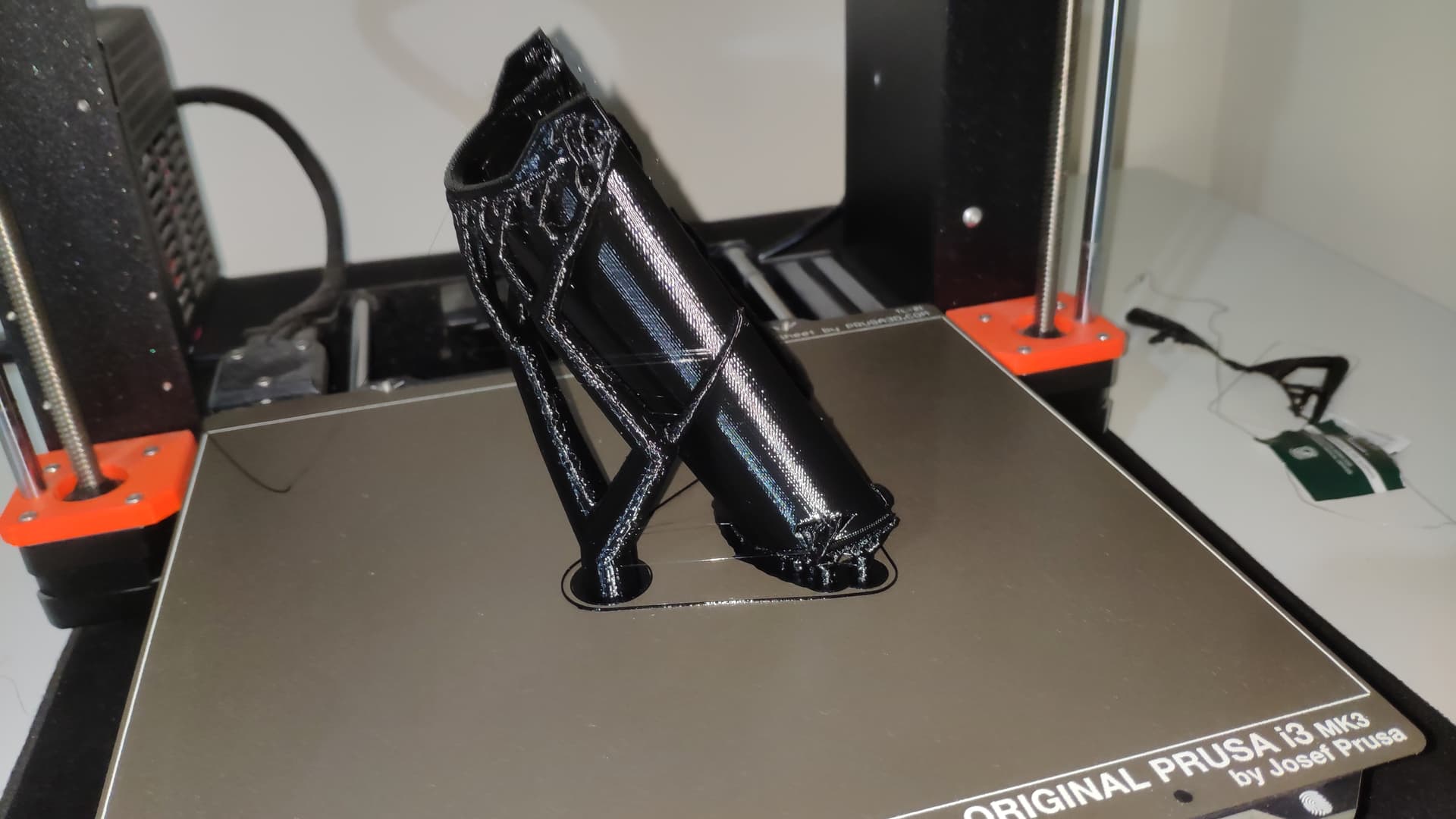

@bar Thanks man, I think I’m nearly done!
Have you tinkered with the Makita adapter at all?
It’s a reasonable amount of filament with the support needed and I’d rather not waste it if there are newer versions or if anyone has pointed out flaws.
Could you ask the people on my behalf?
**Post date:** [April 2, 2025, 3:38pm UTC](https://forums.maslowcnc.com/t/maslow-4-1-complete-kit-has-arrived-in-uk/23613/22 "2025-04-02T15:38:34Z")
I haven’t tinkered with it more yet 😕
The issue that I was having was that the filament is pretty slippery and the side of the router is slippery too so it was hard to make it not spin around the router. I think that a bit of double sided tape in there might take care of that issue, but I haven’t confirmed it experimentally.

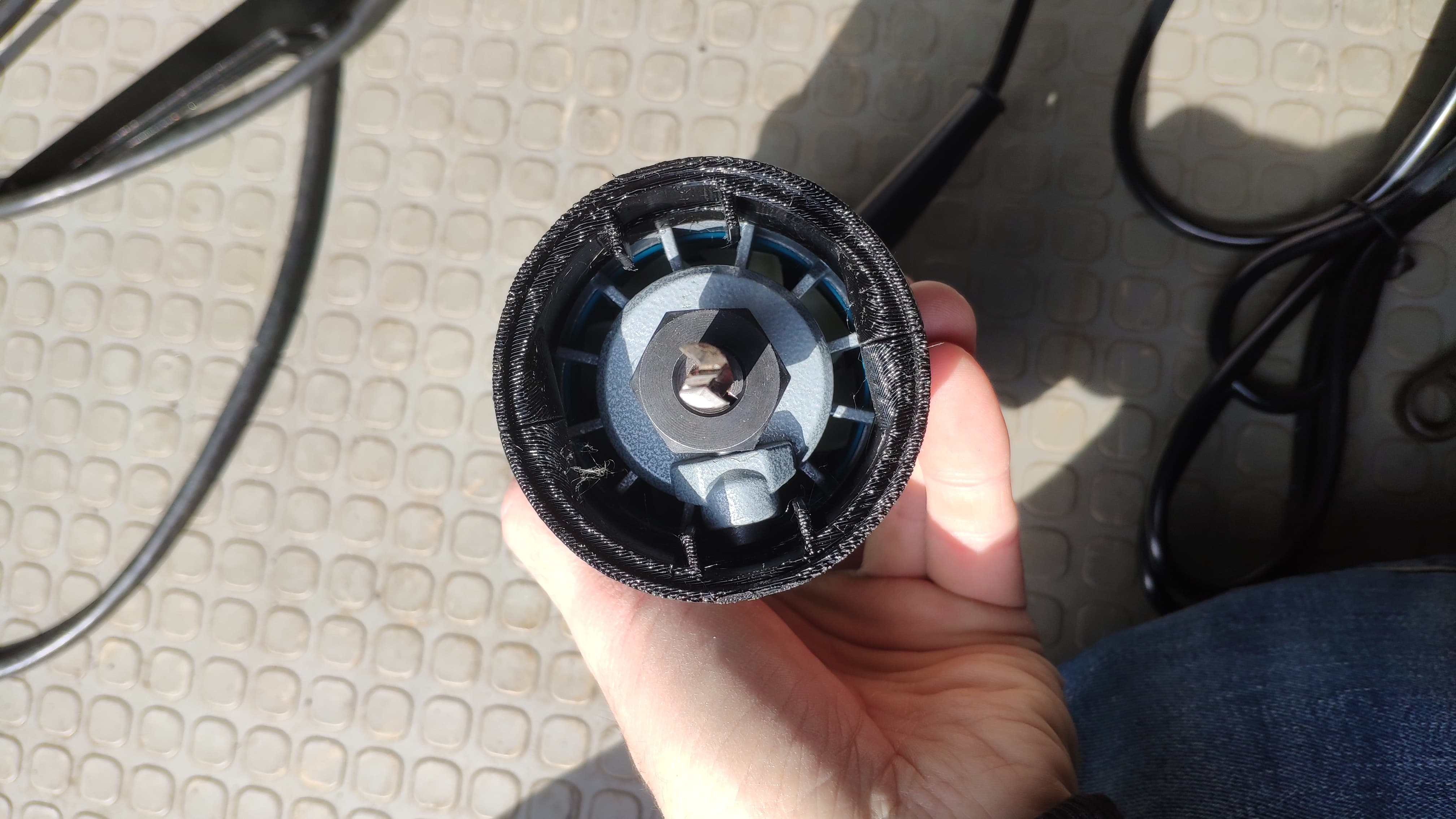

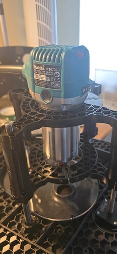

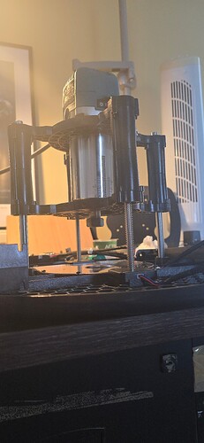

I’ve not done much since almost completing my build due to work, and I’ve not printed the Makita adaptor but this looks like it might be an issue?
 ![20250415_085812](https://canada1.discourse-cdn.com/flex031/uploads/maslowcnc/original/3X/c/b/cb235249ff5934e1ae093dd26966f97e2292bf79.jpeg)
 ![20250415_085806](https://canada1.discourse-cdn.com/flex031/uploads/maslowcnc/original/3X/c/c/cc1a2227f230b3fc8f0031ab5c087019c78597d6.jpeg)
 ![20250415_085742](https://canada1.discourse-cdn.com/flex031/uploads/maslowcnc/original/3X/b/f/bf2cf521e4883efdc6fb3cc94a3afd89ed201cca.jpeg)
**Author:** ![Beagle](https://yyz1.discourse-cdn.com/flex031/user_avatar/forums.maslowcnc.com/beagle/32/14562_2.png) [@Beagle](https://forums.maslowcnc.com/u/Beagle)\
**Post date:** [April 15, 2025, 10:38am UTC](https://forums.maslowcnc.com/t/maslow-4-1-complete-kit-has-arrived-in-uk/23613/28 "2025-04-15T10:38:06Z")
The adaptor makes up the extra (Print it,it will fit)

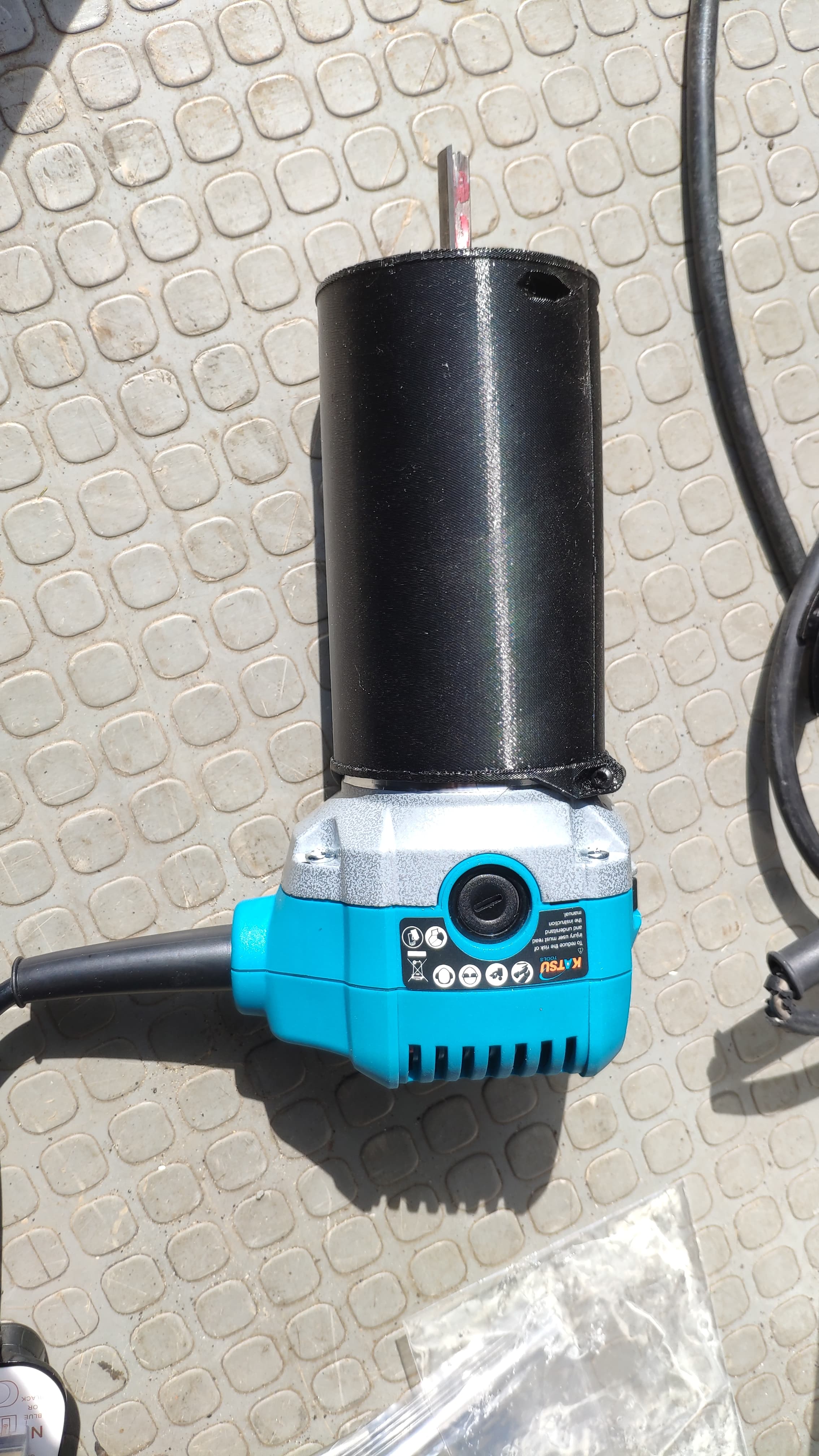

**Author:** ![Luke](https://avatars.discourse-cdn.com/v4/letter/l/7ab992/32.png) [@Luke](https://forums.maslowcnc.com/u/Luke)\
**Post date:** [April 17, 2025, 1:24pm UTC](https://forums.maslowcnc.com/t/maslow-4-1-complete-kit-has-arrived-in-uk/23613/31 "2025-04-17T13:24:14Z")

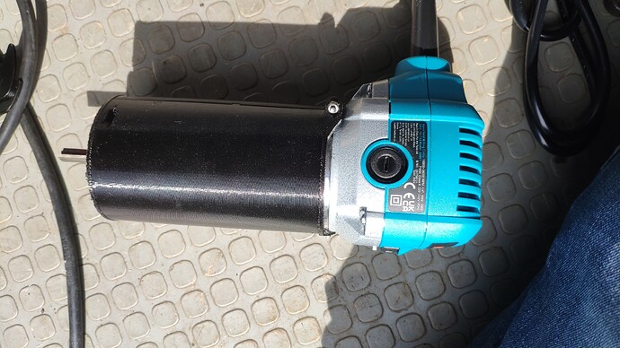

I ended up getting the Makita copy (KATSU) last week. I printed the adapter that Bar provided, and it fits really well. It does increase the length of the router, which I’m guessing is why you need to print it at an angle—to increase the strength so the extension doesn’t shear off. I finished my assembly and am now at the stage of thinking about a frame/anchors.
The router came with a locking spindle button and two spanners. I fitted my cutting bit before assembly, but I can still get the spanners in at an angle to (hopefully) change the tool.

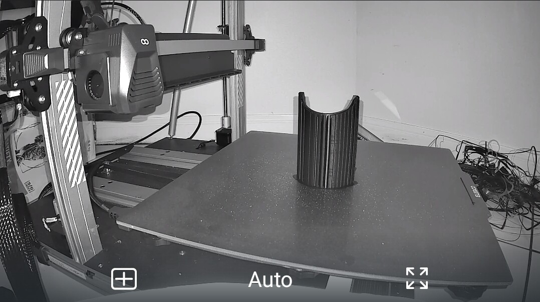

**Author:** ![TheDarkGlove](https://avatars.discourse-cdn.com/v4/letter/t/49beb7/32.png) [@TheDarkGlove](https://forums.maslowcnc.com/u/TheDarkGlove)\
**Post date:** [April 17, 2025, 2:31pm UTC](https://forums.maslowcnc.com/t/maslow-4-1-complete-kit-has-arrived-in-uk/23613/32 "2025-04-17T14:31:28Z")
Nice, thanks for that.
I actually printed one a couple of days ago but haven’t been able to get to it.

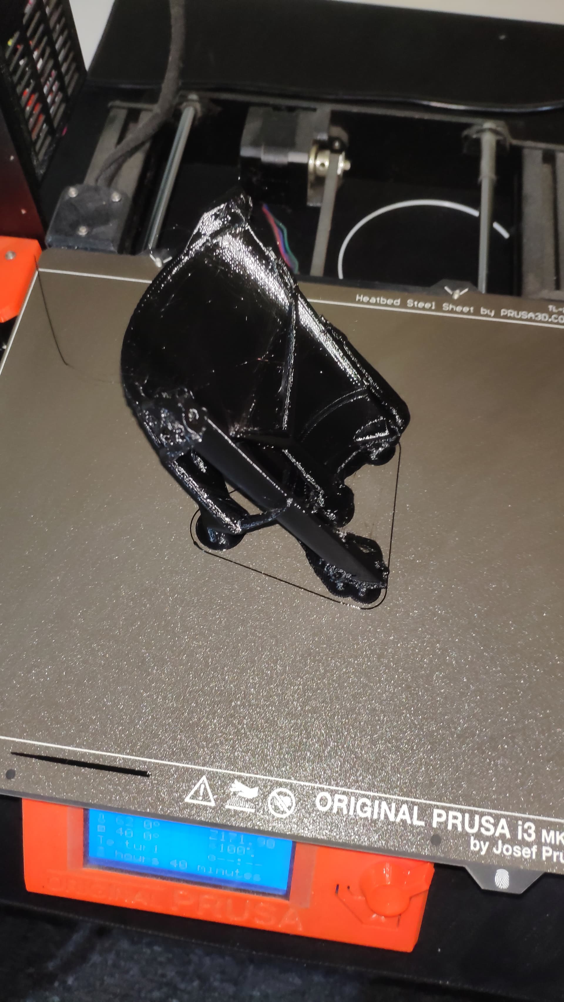

**Post date:** [April 18, 2025, 5:46pm UTC](https://forums.maslowcnc.com/t/maslow-4-1-complete-kit-has-arrived-in-uk/23613/34 "2025-04-18T17:46:38Z")
I’m very pleased with myself
