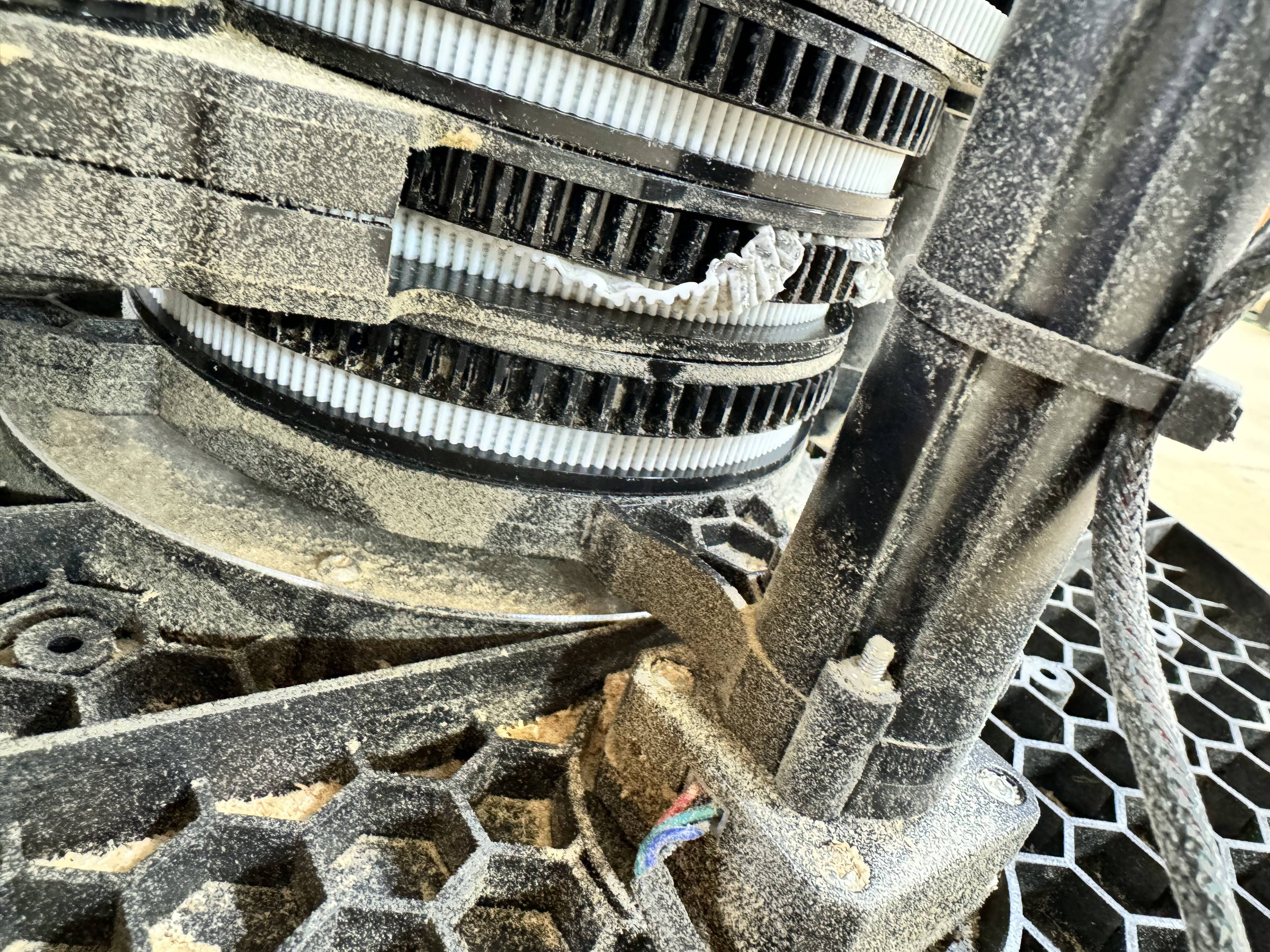

Hi. My Maslow 4 got the belt so stuck that it’s ruined. If you could send me a source for a replacement belt that would be great.
 ![IMG_0083](https://canada1.discourse-cdn.com/flex031/uploads/maslowcnc/original/3X/a/8/a8565bf61e8c363fa9f34b69551ba71d35c5952b.jpeg)

That can happen, especially when you are first getting used to the machine. DM your address to @anna and we’ll send you some spares.

The same thing just happened to me. It is still jammed I don’t know if I need to disassemble or I can run it in the opposite direction. It seems like the belts are too long and it slipped up over the drive gear. I read in other posts that they have shortened their belts by several feet.

Unfortunately when that happens the belt generally gets pretty mangled and needs to be replaced. Email your address to [Anna@maslowcnc.com](mailto:Anna@maslowcnc.com) and we’ll send you some replacements right away.

We will send you belts and spools so you don’t have to unglue them. Ungluing never goes smoothly.
There isn’t an option to individually control a motor right now. We could add it, but I think it’s likely to make things worse not better once things get really jammed up (ie you could end up with a stuck belt and a fried motor controller)

I think it was a retract all. Once I take that spool out I can see which way it was jammed and report back.
**Post date:** [March 31, 2024, 2:00am UTC](https://forums.maslowcnc.com/t/maslow-4-belt-ruined-got-jammed-in-the-gears/20251/10 "2024-03-31T02:00:26Z")
@bar trying to keep all the belts straight and untangled when they are all
moving can be fairly hard. If you could extend/retract a single arm, I suspect
that there would be fewer cases of the belts getting tangled (and then into the
gears)

@bar - the belt mangling issue during calibration seems to be a frequent problem. I just had my upper right belt destroy itself in the gears too. I didn’t actually see it occur, just saw the aftermath, but I’m sure it was caused by too much slack on the belt during calibration and the belt rode up on the gears and was crushed into them. I’ll email Anna for a replacement belt. I think fixing the slack issues during calibration is going to be critical to getting everyone working without having to send out a lot of replacement belts.

I agree. I think that we will want to tweak the calibration process and also maybe redesign that little guard which is supposed to keep the belt out of the gears.
