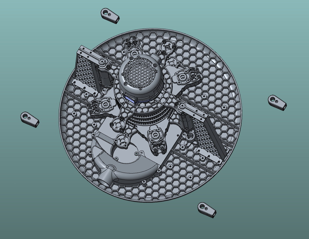

Did you output the entire assembly as a STP in addition to the parts or just the individual parts? If there’s an assembly then it just saves me time and I’m lazy 🙂
The dust collector hole appears to be out of date at least compared to the Maslow 4 I have. The dust collector hole on my unit is ~ 1.75" with a sled diameter of 1.31" The sled diameter checks out but the dust collector cover appears too small in the model.
 ![image](https://canada1.discourse-cdn.com/flex031/uploads/maslowcnc/original/3X/4/f/4fa8a3e53049d739913a0773309be77681c664fe.png)

Like the hole in the clear acrylic piece is too small in the 3D model?
**Author:** ![smarcus3](https://yyz1.discourse-cdn.com/flex031/user_avatar/forums.maslowcnc.com/smarcus3/32/26517_2.png) [@smarcus3](https://forums.maslowcnc.com/u/smarcus3)\
**Post date:** [May 24, 2024, 4:38pm UTC](https://forums.maslowcnc.com/t/maslow-4-cad-share-location/21203/5 "2024-05-24T16:38:53Z")
Yes the hole in the clear acrylic cover. 1 measured it at ~ 1.75"

I don’t have a great assembly for the whole thing…It’s on my todo list, but I’d like to spend some time and make a nice one before putting it out. If you make one feel free to share it!
> [@smarcus3](#):
I did change that part a couple times so it makes sense that I might have gotten the wrong version. I just updated that file so it should be the latest version now. Good catch!
