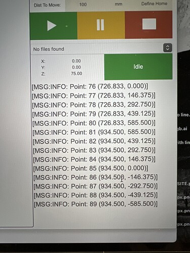

### Author: ![anesbitt](https://yyz1.discourse-cdn.com/flex031/user_avatar/forums.maslowcnc.com/anesbitt/32/4831_2.png) [@anesbitt](https://forums.maslowcnc.com/u/anesbitt)
#### Post date: [March 23, 2024, 8:32pm UTC](https://forums.maslowcnc.com/t/maslow-4-error-152-and-many-calbration-fails/20316/13 "2024-03-23T20:32:06Z")
Thanks for the help. Here is a photo of the end of the console scroll. Also do I have to take the belts of and do a retract/extend every time before a new calibration attempt. Assuming yes but didn’t know.

#### Post date: [March 23, 2024, 8:34pm UTC](https://forums.maslowcnc.com/t/maslow-4-error-152-and-many-calbration-fails/20316/14 "2024-03-23T20:34:21Z")
> [@anesbitt](#):
I am also not 100% sure, but I always hit the estop button too to power cycle everything to be 100% sure that I’m starting fresh
#### Post date: [March 23, 2024, 8:37pm UTC](https://forums.maslowcnc.com/t/maslow-4-error-152-and-many-calbration-fails/20316/15 "2024-03-23T20:37:36Z")
> [@anesbitt](#):
This is almost what I would expect 😕
There is one last step which is that I would expect it to say “Calibration Complete” at the end and then start the computation. Looking at the code I’m not seeing how it wouldn’t say that.
#### Post date: [March 23, 2024, 8:39pm UTC](https://forums.maslowcnc.com/t/maslow-4-error-152-and-many-calbration-fails/20316/16 "2024-03-23T20:39:58Z")
On the other console screen it has one more line:
Ok
Just that and nothing else.
I wonder if the wifi is inconsistent or some connection problem?
#### Post date: [March 23, 2024, 8:43pm UTC](https://forums.maslowcnc.com/t/maslow-4-error-152-and-many-calbration-fails/20316/17 "2024-03-23T20:43:03Z")
Maybe, but you aren’t the first person to run into this issue so I don’t think it’s you. I think that there is a bug, I’m just not sure what it is.
One of the big changes in v0.65 was:
> ## A more robust data hand-off system between the calibration process and the computer computing the results
> When the calibration process finishes taking measurements that data is sent to the computer for processing. This system relied on the computer being ready to receive the data and would fail if the computer had gone to sleep or the browser window was closed.
> Now the machine will confirm that the hand-off has been a success and will keep re-sending the data until it gets confirmation. This means that the calculation will resume automatically when the computer is woken up or the browser tab is re-opened.
Specifically I was hoping to prevent exactly this. In testing I was able to start the calibration process…close the browser entirely. Wait for it to finish, and then open the browser again and it would reconnect and finish.
