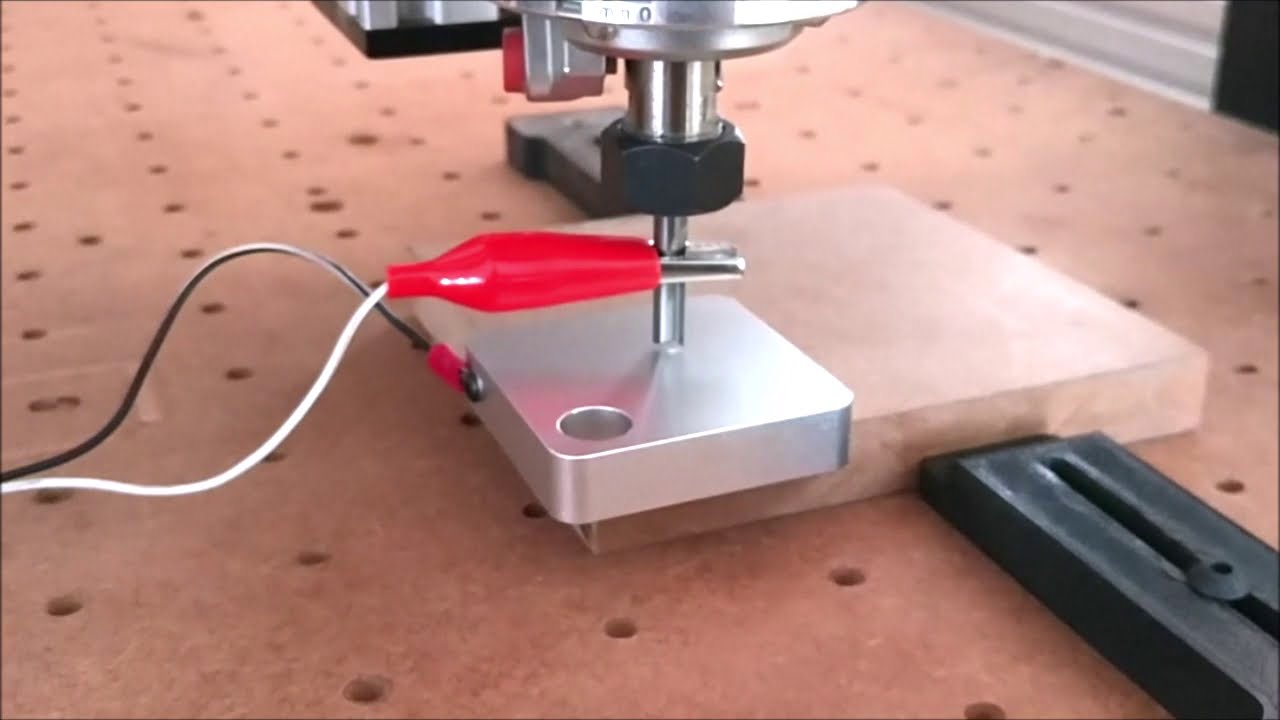

[![](https://img.youtube.com/vi/aVZYFjiEUac/maxresdefault.jpg "XYZ Touch Probe") ](https://www.youtube.com/watch?v=aVZYFjiEUac)
 ![Screenshot_20230807-110812](https://canada1.discourse-cdn.com/flex031/uploads/maslowcnc/original/3X/1/1/117f59427783e439eb05a4081c8a6433a0cbf0b5.jpeg)
 ![Screenshot_20230807-110822](https://canada1.discourse-cdn.com/flex031/uploads/maslowcnc/original/3X/9/9/99036cb8a8ae5f47da7e161810067d89249f2956.jpeg)
Some time ago I modified the work surface to make dovetail joints, but the problem was that you found exactly the zero of the x and y axes.
I thought I was drawing the piece co. Fusion for example, then fix the piece on the maslow, even at random, test the blank piece to obtain the zero and orientation of an axis, and then reorient the drawing, always keeping the origin good

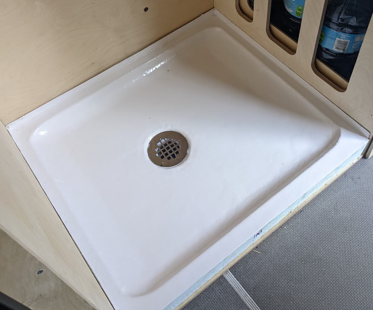

I noticed on the M4 that the Z travel is 1.9inches. Do you know if this can be extended to 3 inches to be able to cut through 3 inch material like styrofoam?

to make things like this custom size shower pan. lowest cut into the drain was 2.5 inches
 ![Screenshot 2023-08-07 165149](https://canada1.discourse-cdn.com/flex031/uploads/maslowcnc/original/3X/f/e/fe9c13aca1c29901b5ae2496d7fd04cce7c60fd0.jpeg)
 ![Screenshot 2023-08-07 165448](https://canada1.discourse-cdn.com/flex031/uploads/maslowcnc/original/3X/e/d/edb82476f6be68e995765c9ccecb5f9ef3d68670.jpeg)

@Sylvain_Dorais three inches is totally possible for a soft material like foam. The only tricky bit would be getting the stepper motors with the right length of shaft for that. If there’s a demand for that I’ll order some with the longer shafts and have them available. I wouldn’t really recommend it as a general change to make because for cutting harder materials it’s going to be less rigid with that extra shaft.
I was about to say that for a shower pan like that you would have issues with the sled falling in the hole, but you’ve got those bumps there which could support it. Was that shower pan cut on an old Maslow?

Hi Bar,
Thanks for the quick response, To answer your question, Yes the pan was cut (carved) with the Maslow. You are right about the studs (bumps), I just leave material out every 6 to 7inches so the sled traverses on top of the piece without falling. Once done, I just cut them out with a knife and sand a bit… once the fiber and epoxy is done, you can’t see the difference. I use the same process any large carves. I would love a set of longer shaft to be able to continue to do this on thick foam!

unfortunantly, the injection molded piece is unlikely to be able to be extended
like this. That said, I expect that there will be 3d printed versions that will
be available for you to print, and I _think_ from what I’m seeing that this will
be reasonable to do (especially with a smaller spindle) as I am thinking that
the main parts that benefit from the strength of injection molding vs 3d
printing will be the motor/belt carriers.
