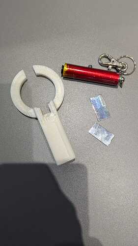

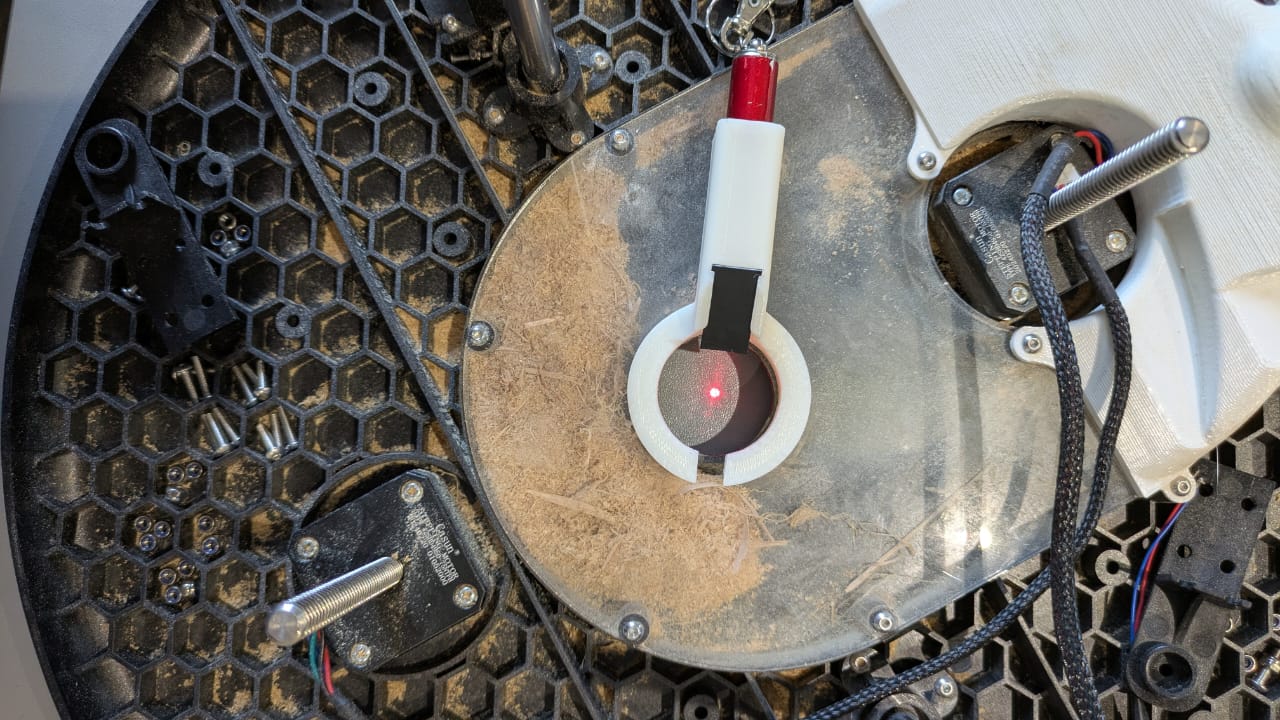

Hi there! Here is a design for an optional laser pointer to center your Maslow better. It is designed to clip into the hole in the acrylic part on top of the sled. It uses an angular mirror to deflect a laser dot to a point exactly under the drill bit. It is a simple 3d printed part, that you can print from any material (PLA/ABS/PETG). Other things you will need to assemble is a mirror surface (I use 1mm reflective coated PVC) and a common laser pointer. Please remove before starting actual cutting job or use a longer mill bit and mind the safe z-distances. Please use the design, and let me know if it is helpful and how can I improve it! Have fun!
