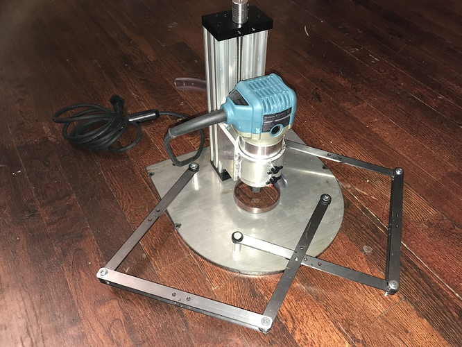

Working on the laser cut sled
weight is about 22lbs and with optional weight to make it 26 total lbs with router
Testing perimeter plastic vs cutting boards
The linkage kit seems to work well with bronze olite bearings and welded router clamp seems accurate
**Post date:** [November 2, 2018, 3:27am UTC](https://forums.maslowcnc.com/t/metal-maslow-kit-600-ships-nov-respond-below-if-interested/6312/218 "2018-11-02T03:27:11Z")
That’s a bit on the heavy side, if you can make it lighter, that would be good. We know that when you get up to 30 pounds, that is too heavy for the current motors (especially with the stock controller).
The test is to make a cut across the top of the workspace, if the motors can’t handle the weight, the cut will sag and then curve up at the end.
**Author:** ![pillageTHENburn](https://yyz1.discourse-cdn.com/flex031/user_avatar/forums.maslowcnc.com/pillagethenburn/32/407_2.png) [@pillageTHENburn](https://forums.maslowcnc.com/u/pillageTHENburn)\
**Post date:** [November 2, 2018, 6:46am UTC](https://forums.maslowcnc.com/t/metal-maslow-kit-600-ships-nov-respond-below-if-interested/6312/219 "2018-11-02T06:46:59Z")
Looking pretty good! I have a load of questions…
It looks like the center linkage bar in on the right hand side (of the picture) is upside down?
I assume the small center holes on the linkage pieces is for the chain attachment, what are the other two holes for?
Do the two linkages anchor on different planes (to keep them from rubbing where they cross) or do you rely on flex?
With a known router and z-axis setup why did you choose to make the linkages so large?
**Post date:** [November 2, 2018, 10:51am UTC](https://forums.maslowcnc.com/t/metal-maslow-kit-600-ships-nov-respond-below-if-interested/6312/220 "2018-11-02T10:51:06Z")
Actual total sled weight as shown is 18 lbs There will be two 4 lbs optional weights (not shown) to increase weight to 22 or 26 lbs. I am just assuming people will use at least one of those weights.
The reason for 3 holes on the linkage kit is to allow chain mounted via a quick release pin or center wire. I will post photo latter.
You are right the 9” on center linkages look huge on a 12” sled. I might try some smaller sizes like 7”
The cross crossing arms are spaced to be on different planes with washers offsetting them.
**Post date:** [November 2, 2018, 5:51pm UTC](https://forums.maslowcnc.com/t/metal-maslow-kit-600-ships-nov-respond-below-if-interested/6312/221 "2018-11-02T17:51:08Z")
Hows the balance point of the sled? I assume the spacers can be readily replaced with different lengths? I always seem to thick the cbeam Zaxis kits will have a high COG… but I don’t know if the weight is significant compared to the router.
**Post date:** [November 2, 2018, 5:56pm UTC](https://forums.maslowcnc.com/t/metal-maslow-kit-600-ships-nov-respond-below-if-interested/6312/222 "2018-11-02T17:56:02Z")
Correct just use more spacers to adjust. With palm router spacers need to be about 1.5” tall. Since the metal base is heavy it brings down the center of gravity significantly.
