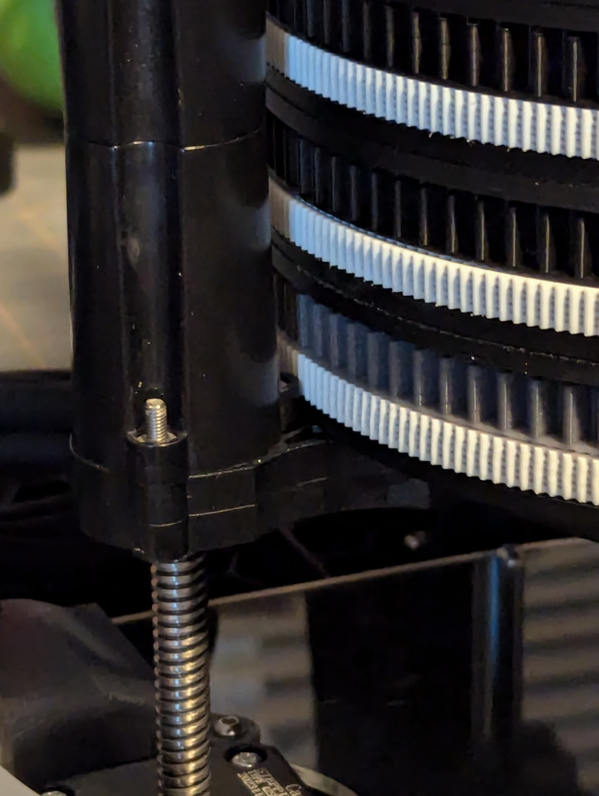

I have been working on modifying my Maslow 4 to have larger arms that hold 8.8m of belt using a full 10m belt on each arm with stops 1200mm from the ends.
 ![PXL_20241113_213330574~2](https://canada1.discourse-cdn.com/flex031/uploads/maslowcnc/original/3X/d/7/d71e91798fe3e25ac8c52bce863e7537e9614e14.jpeg)
 ![PXL_20241113_213250511](https://canada1.discourse-cdn.com/flex031/uploads/maslowcnc/original/3X/8/d/8d4fcf42ebb5f2af9e61ad30047e68aa82559890.jpeg)
This uses a 107 tooth spool and the arms are 30mm longer. I am using concrete anchor points that are 33’x18’. I am using a rotary cutter drag knife over 7 full sheets of plywood to cut synthetic fabrics. This is still in progress and I have many things to finish.

Here it is with the 10m belt on the machine to verify clearance. Unlike the standard arms the bottom arm can’t have any belt wrap on the spool out side the edge or it interferes with the bolt hole connecting the bottom plate.
 ![PXL_20241118_043313235](https://canada1.discourse-cdn.com/flex031/uploads/maslowcnc/original/3X/9/9/9905db9fa3ca631f274ca39b2cf2d685547ec1dd.jpeg)
 ![PXL_20241118_045531528](https://canada1.discourse-cdn.com/flex031/uploads/maslowcnc/original/3X/d/4/d4c5d42d32032e6b56a9f3a9daff52f3d9f2b491.jpeg)
But even with that restriction I was able to get 9.7m of cable on to my 107 tooth spool. All the cable will be cut and setup the same with the belts have the exact same number of teeth and the stop block be in the exact same tooth location and the end being the same distance away so my Belt End Extension valve will be exactly the same on each arm. If I don’t I know this will be a mess.

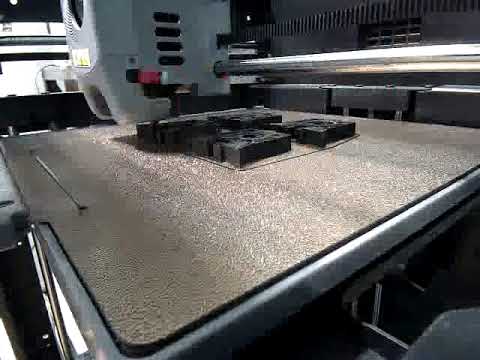

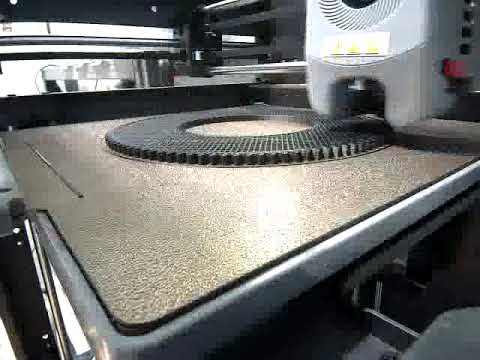

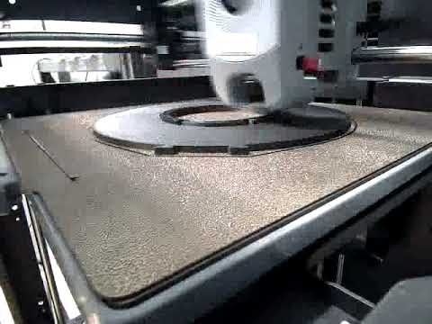

And for your enjoyment here is three of the parts printing.
[![](https://img.youtube.com/vi/K_BpRfaPXwo/hqdefault.jpg "LargeArmSplitRing Printed on FlashForge A5M") ](https://www.youtube.com/watch?v=K_BpRfaPXwo)
[![](https://img.youtube.com/vi/WjP55GSEsP0/hqdefault.jpg "Large Spool Printed on FlashForge A5M") ](https://www.youtube.com/watch?v=WjP55GSEsP0)
[![](https://img.youtube.com/vi/UiA5cjIUbwc/hqdefault.jpg "LargeBeltGuard") ](https://www.youtube.com/watch?v=UiA5cjIUbwc)

**Post date:** [November 18, 2024, 8:07am UTC](https://forums.maslowcnc.com/t/modifying-maslow-4-to-a-cut-area-of-28x6-to-cut-synthetic-fabric/22723/11 "2024-11-18T08:07:21Z")
given that a drag knife needs very little Z movement, you may want to play around with the varient I’m tinkering with in [Onshape](https://cad.onshape.com/documents/764e57e1318b9953e5986480/w/d0fb021f278db7c3ec637c49/e/d01de6be88ce3782f9f5ed0b) (look at the ‘custom spool copy 1’ tab for making the parts)
I haven’t tried printing anything yet, but running a drag knife seems like it should be a very low-force thing that would let you get away with using the lead screws as your only vertical supports (especially if you go with short ones instead of the 300mm ones I show here)
it lets you specify any size spool and how much belt you will fit on it, making sure that you have clearance. (note that the configuration option to set the tooth count doesn’t work, so you will need to clone the document, let me know if you want to get together online and go over it or if you want me to generate parts)
I also think that you could get away cutting off the screw mount that you are hitting if you needed it

**Post date:** [November 21, 2024, 1:23am UTC](https://forums.maslowcnc.com/t/modifying-maslow-4-to-a-cut-area-of-28x6-to-cut-synthetic-fabric/22723/12 "2024-11-21T01:23:38Z")
I looked at you onshape model and played with the size and realized that I don’t need the fasteners in the Center I can gain like 2 wraps and the 10m with fit without sticking out.
 ![PXL_20241120_181644355](https://canada1.discourse-cdn.com/flex031/uploads/maslowcnc/original/3X/7/9/79384378373aae22f50ec52ce393ad725443ae6b.jpeg)
 ![PXL_20241120_181707268](https://canada1.discourse-cdn.com/flex031/uploads/maslowcnc/original/3X/c/4/c4f34ed99058496b62ccf70035ffcf9ca9a62cb8.jpeg)
 ![PXL_20241120_182130524](https://canada1.discourse-cdn.com/flex031/uploads/maslowcnc/original/3X/d/7/d7cde34578f52d258f1d8705f2b27a2df451944e.jpeg)
 ![PXL_20241120_182213540](https://canada1.discourse-cdn.com/flex031/uploads/maslowcnc/original/3X/e/5/e5480c6d08b95e0308e0120a1e4924366e690055.jpeg)
 ![PXL_20241120_183851976](https://canada1.discourse-cdn.com/flex031/uploads/maslowcnc/original/3X/a/4/a4675269cd482b46f16178db2ea154ff8fbe14e4.jpeg)
or I could have 14.5ft of belt and have a 118.5mm center opening
**Post date:** [November 21, 2024, 4:40am UTC](https://forums.maslowcnc.com/t/modifying-maslow-4-to-a-cut-area-of-28x6-to-cut-synthetic-fabric/22723/13 "2024-11-21T04:40:07Z")
That’s exactly why I built that 🙂
**Post date:** [November 21, 2024, 5:34am UTC](https://forums.maslowcnc.com/t/modifying-maslow-4-to-a-cut-area-of-28x6-to-cut-synthetic-fabric/22723/14 "2024-11-21T05:34:38Z")
also note that my design flips the belt around, teeth in. and touches up the shape of the spool center to be more efficient. This gives most of an additional layer of belt on the spool, and gives you additional grip on the belt so you can unwind a bit more of the belt before you risk pulling the belt off of the spool.
