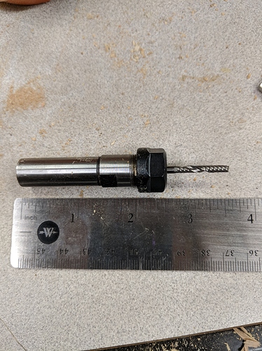

I have not used them in the Maslow yet, but I use them all the time in my Makita RT701 that is on my OpenBuilds C-Beam Machine. On the Makita, I use a custom 1/8" collet that I bought from Elaire. I cut wood, plastic, and aluminum with these bits. They don’t last all that long, but they don’t cost all that much. I’ve cut more aluminum than anything lately, but I haven’t changed bits in a while. Of course, I am cutting smaller things with the smaller machine. I have no idea how long the bits will last on the Maslow. I’ll find out eventually.
My Maslow is still very much under construction. I spent the bulk of today welding up the frame and cutting my unistrut. At this rate, it will be at least a few more weekends before it is fully functional. I am planning to use a different Z axis setup than the Ridgid base, but I will use the Ridgid motor on the Maslow because I already have one. There aren’t custom collets for the Ridgid, so I bought an ER-11 X 1/2" collet extension on Ebay, something like this one:
[https://www.ebay.com/itm/DZ-Brand-1-2-ER11-80-Collet-Extension/282137169770?hash=item41b0af8f6a:g:7CoAAOSwL7VWqNe5](https://www.ebay.com/itm/DZ-Brand-1-2-ER11-80-Collet-Extension/282137169770?hash=item41b0af8f6a:g:7CoAAOSwL7VWqNe5)
I had to cut the shank to a more reasonable length, but making something like this shorter is a whole lot easier than making it longer. Cutting disc in the grinder made short work of it. I spun it in the lathe while I cut it to make sure it was straight, then de-burred it before putting it into the router collet
Here’s the result, with a 1/8" ER-11 and a bit:
 ![IMG_20171217_162858](https://canada1.discourse-cdn.com/flex031/uploads/maslowcnc/original/2X/8/86ec41964e4ac470bb7a75d1a38dc51190bf0c0d.jpg)
Here it is installed in the router:
 ![IMG_20171217_162743](https://canada1.discourse-cdn.com/flex031/uploads/maslowcnc/original/2X/3/3a8d5a55bc3d5e6d1279f346c4d33a36cfe3fce4.jpg)
It does extend a little further than I wanted it to, but it should be OK, and that should actually help with the dust collection I have planned. I haven’t spun it up yet, but I see no reason why this won’t work. The shaft measured closer to 0.500 than the 3 router bits I checked with the micrometer (0.499 vs 0.498, 0.497, and 0.498). Still, when I do test it, it won’t be while I am looking right at it. I have seen adapters like this used on routers before, especially on router tables.
[https://www.toolstoday.com/cnc-extension-adapters-for-14-and-18-inch-shank.html?variantids=12131,0&keywords=47640/&country=US&gdffi=df1cb0f3ab644accbe5cae9671f148bf&gdfms=FED2CB427DD8426090AE90A62EAC4396&gclid=Cj0KCQiAyNjRBRCpARIsAPDBnn1kooYSSnqGyf4AlkuNEHgMwpbPTHxFCnRJEo8xEXBKBZWanpOxNQUaAjyNEALw\_wcB](https://www.toolstoday.com/cnc-extension-adapters-for-14-and-18-inch-shank.html?variantids=12131,0&keywords=47640/&country=US&gdffi=df1cb0f3ab644accbe5cae9671f148bf&gdfms=FED2CB427DD8426090AE90A62EAC4396&gclid=Cj0KCQiAyNjRBRCpARIsAPDBnn1kooYSSnqGyf4AlkuNEHgMwpbPTHxFCnRJEo8xEXBKBZWanpOxNQUaAjyNEALw_wcB)
I chose the smallest one I could find that still offered the chance to use up to a 1/4" bit. The ER-11 has inch-sized collets up to 1/4" which should serve for a lot of the work I want to do with the Maslow. ER-11 collets also are available in metric sizes, up to 7 mm, which opens up the possibility for using other diameter cutters.
Of course, your mileage may vary and so on, all the usual caveats apply. Don’t go following my lead thinking that I know what I am doing.
