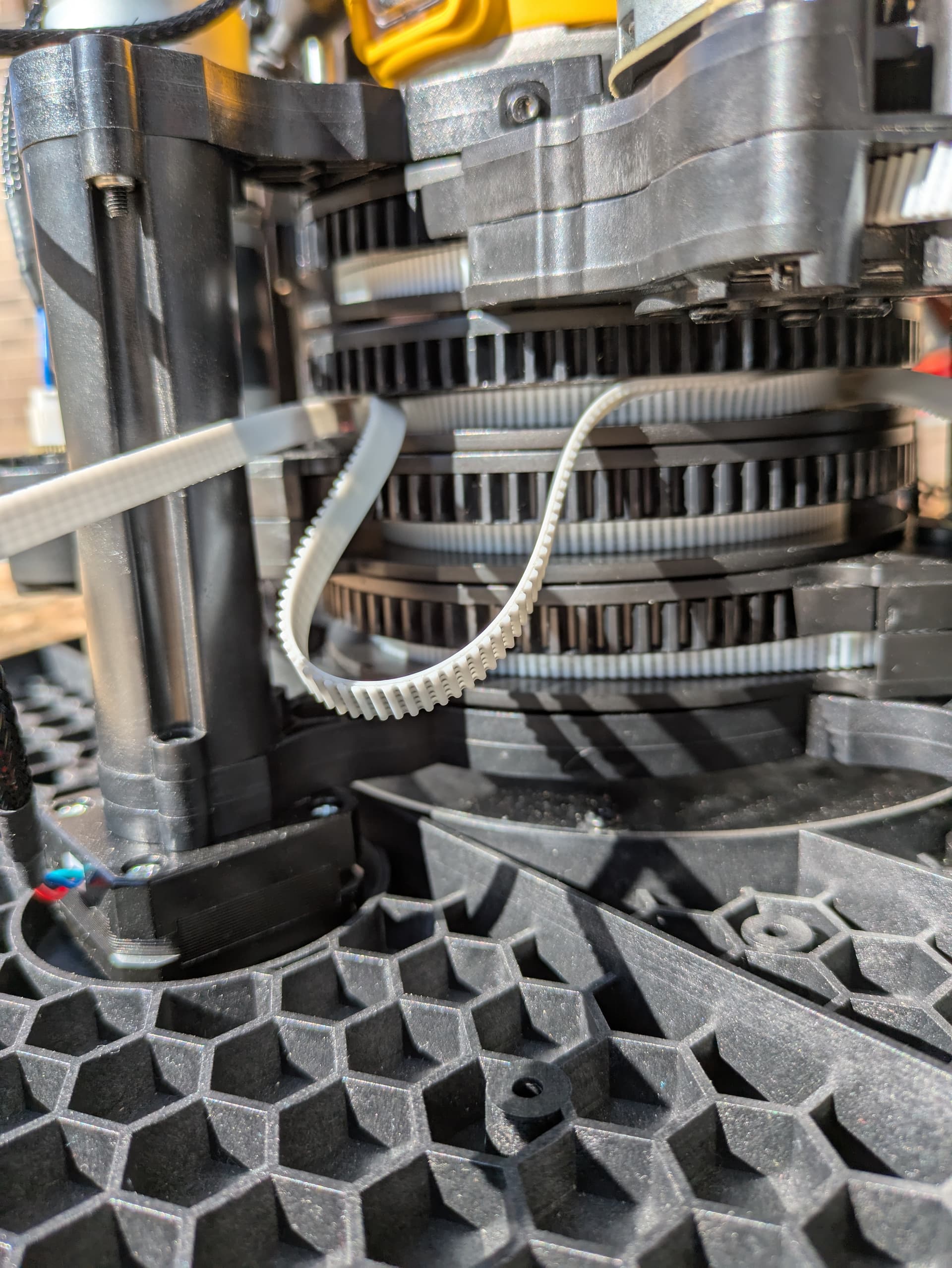

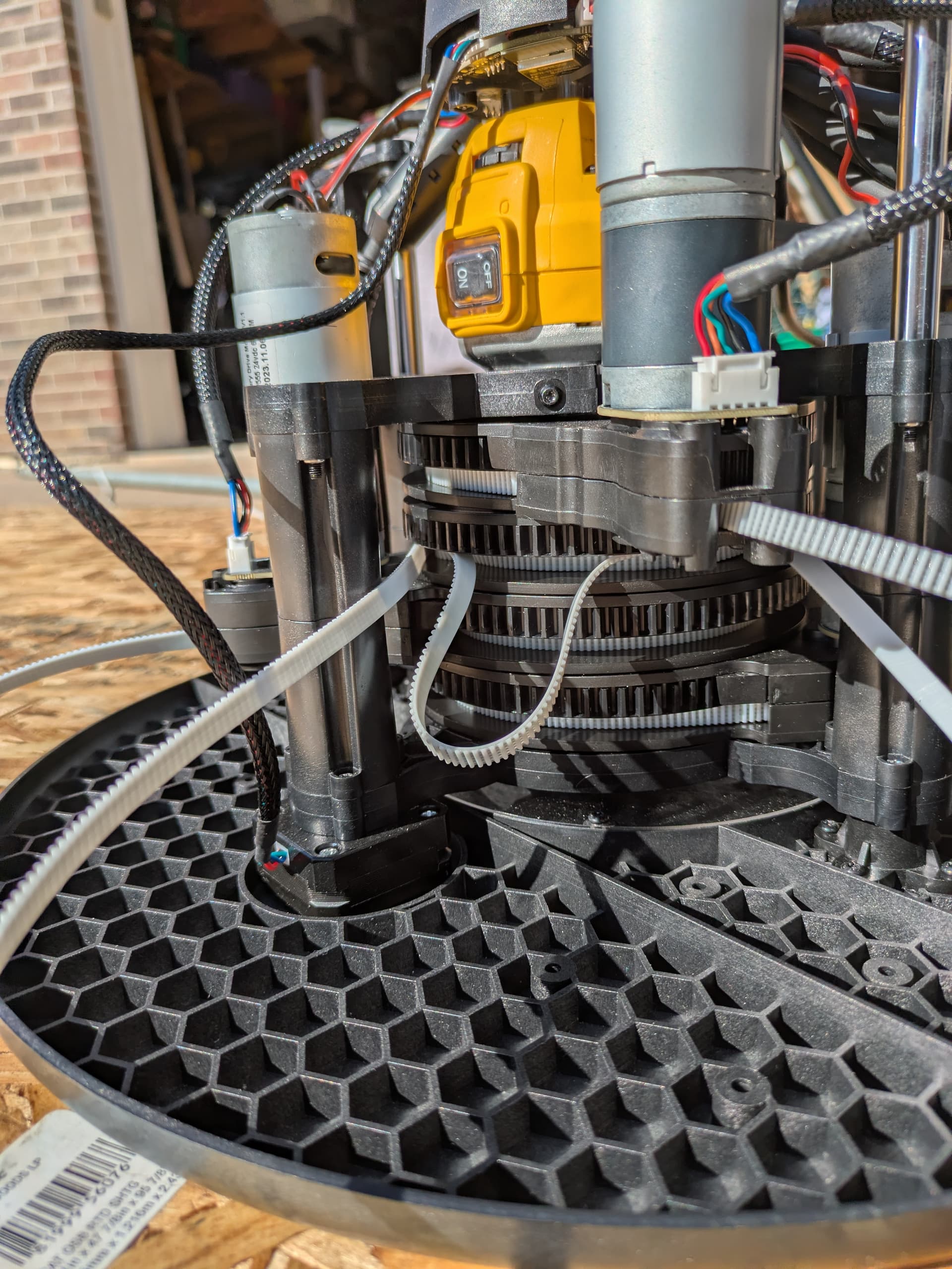

Posting here as well looks like one of the belts got turned over in the gears as it retracted and then snapped. Tearing it all down to straighten things out.

I’m fairly tech savvy and have done robotic projects before. I may be doing something stupid here but it is really not clear what. I don’t think the machine should tear itself apart from small mistakes.I don’t know that I have four hours today to take all of the spools apart and make sure the belts are straight.

Ok, pulled the belt through that had flipped over and unspooled it all the way, no idea how that happened. there is only one small fold half way and it looks vertical. the end anchor and direction look ok, so going to stick it back in and see what happens. the other one that snapped also looks ok all the way back to it’s start.

**Post date:** [October 7, 2025, 9:00pm UTC](https://forums.maslowcnc.com/t/motor-jitter-belts-loosening-during-calibration/24997/19 "2025-10-07T21:00:07Z")
I see what happened from looking at the logs:
> [@wouldchuck](#):
I 1000% agree. We’re very much still in the early phase of learning how this technology works and so we’re still encountering and fixing issues that are happening for the first time.
Taking a look at the log I can see what went wrong:
```auto
[MSG:WARN: Frame side lengths are outside valid range (500-5000mm). Top=3509.713mm, Right=4507.432mm, Bottom=5113.800mm, Left=2100.214mm. Correcting to reasonable defaults.]
[MSG:INFO: Anchor coordinates corrected. New values: tlX=-30.000 tlY=2100.000 trX=2950.000 trY=2100.000 blX=0.000 blY=0.000 brX=3000.000 brY=0.000]
Basically the frame is so big that the machine is going to tear itself apart by extending one of the belts so far that it can’t reach the other side. It’s recognizing that it’s too big and resizing, but that’s not the right behavior either because resizing just means it resizes to invalid anchor point locations. What we really want is for the machine to throw a warning and shut down completely because basically anything that it does at that point risks breaking something.
I’m working on a fix right now.

plugging your numbers in to my frame calculator at [http://lang.hm/maslow/maslow4\_frame.html](http://lang.hm/maslow/maslow4_frame.html)
this is saying that you need ~4700mm of belt, which is about 15.5 ft and the maslow only comes with ~14.5 ft (and you need to leave some amount of belt on the spool, so more like 14 ft usable
