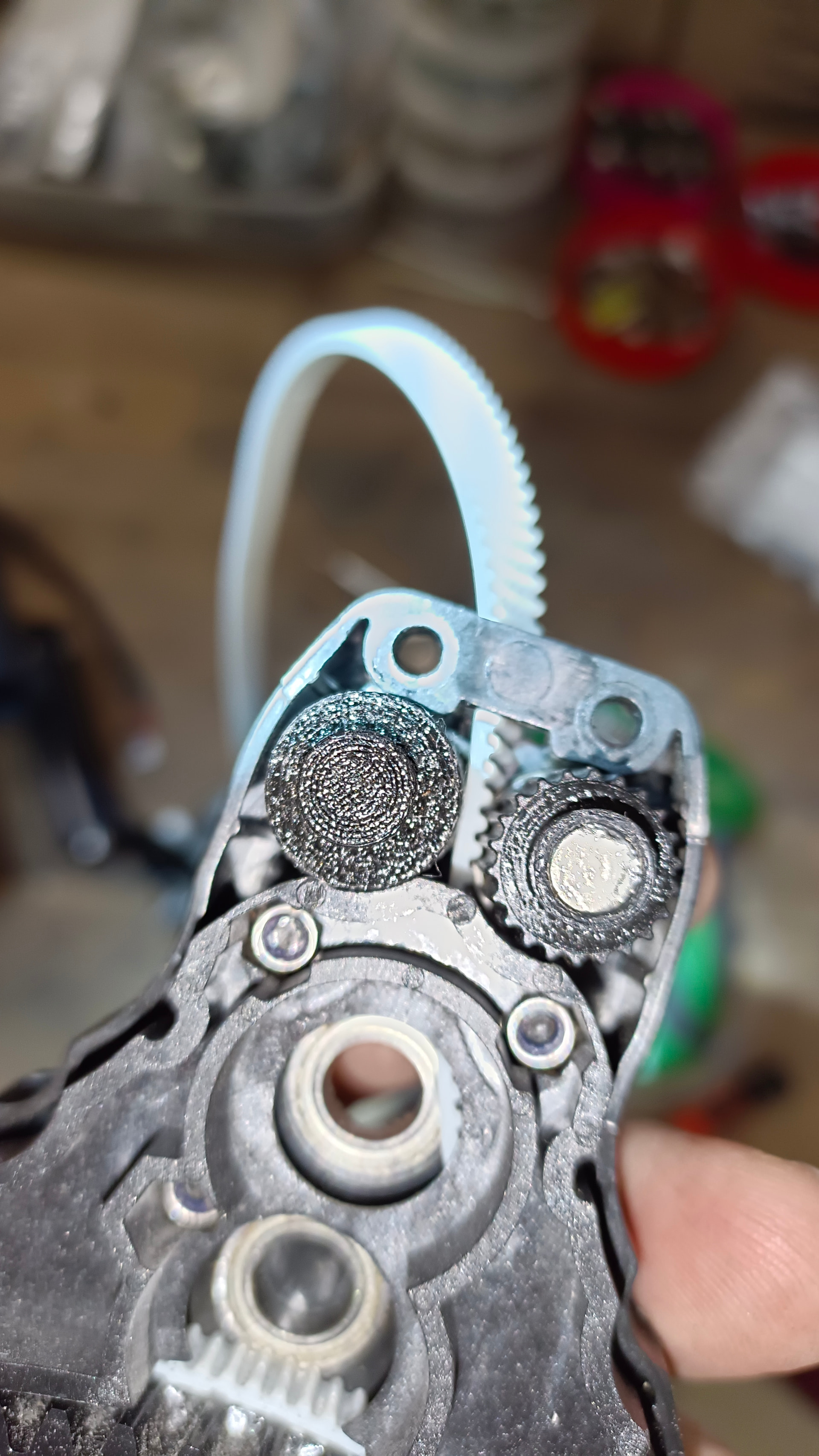

**Post date:** [December 15, 2025, 6:46pm UTC](https://forums.maslowcnc.com/t/my-actual-problems-with-firmware-1-14/25207/33 "2025-12-15T18:46:08Z")
> [@JURA23](#):
> Apart from the problem with Gcode and error 66, I finally cut something.
> I edited the video, it is 16x accelerated. cutting cladding panels for the van into 6mm plywood then into 6.5 hexa lamino plywood with a 3.125mm cutter. 2.5mm passage, so 3 passes.
I love the way the black wood looks while it is cutting! Great work!
> [@JURA23](#):
> I lost connection during the hexa plywood.
Do you have the debug mode which shows the motor currents turned on?
I’ve seen that result in issues because the machine is sending so much extra data. I’d recommend turning it off except when using it for debugging.

 ![IMG_20250819_175919](https://canada1.discourse-cdn.com/flex031/uploads/maslowcnc/original/3X/0/a/0a0c776e81d6011af101fb702e14ecb0b6f72730.jpeg)
> [@bar](#):
yes I watched the motors at work.
But now that I know it’s running well, I can turn it off.
