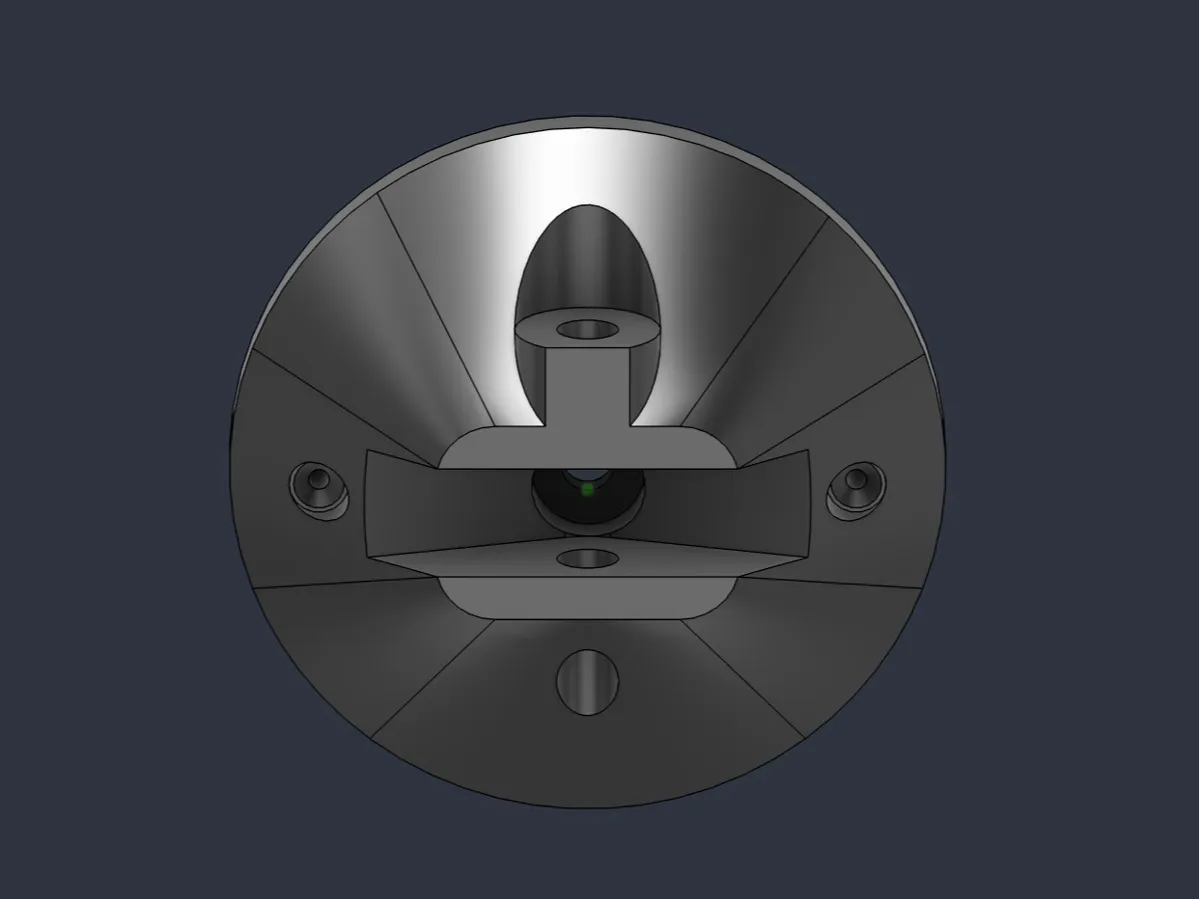

Hi everyone,
Finally got my Maslow 4.1 up and running. Thought I’d share my setup and workspace in case it’s useful for others or gets some improvement ideas.
I have a dedicated workshop space. I’m planning to set up a work table so I can cut on the table instead of on the floor. For this, I made adjustable holders with slots — allows precise height adjustment. I also designed quick-release mounts that clamp with a single bolt — convenient and secure. Photos attached.
You can download the model here.
> **[Maslow wall anchor - Free 3D Print Model - MakerWorld](https://makerworld.com/en/models/3229507-maslow-wall-anchor)**
> Download this free 3D print file designed by airjt. These adjustable wall mounts were designed for my Maslow 4.1 workshop setup.I am building a dedicated work table for cutting with the Maslow above the floor. To support and accurately level the...

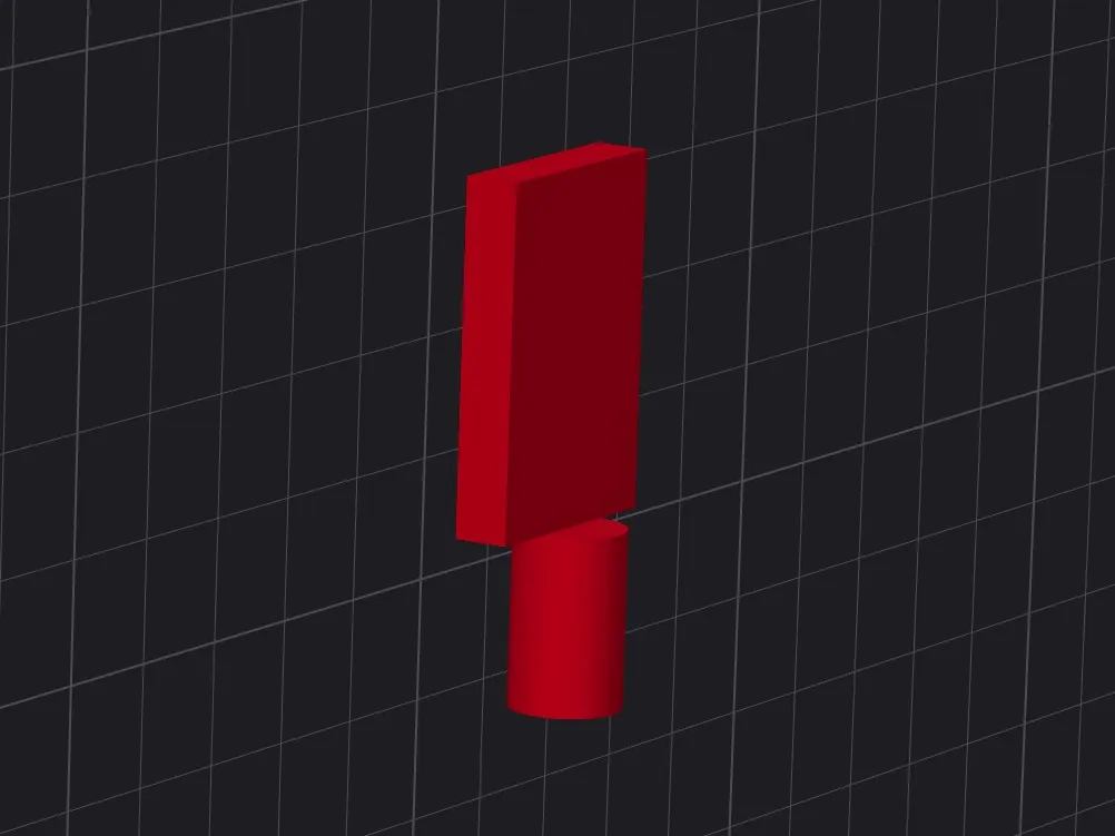

For the anchors, I made a special stop that makes measuring easier — works with both laser and regular tape measures. On one side I place the laser, on the other side it hits a special paddle/reflector. Very convenient for accurate measurements.
> **[Maslow Anchor Distance Measuring Stop - Free 3D Print Model - MakerWorld](https://makerworld.com/en/models/3229542-maslow-anchor-distance-measuring-stop)**
> Download this free 3D print file designed by airjt. This measuring stop is designed for accurate and repeatable distance measurements between the anchor positions in a Maslow 4.1 setup.The part inserts directly into the wall mounts and creates a...

As you can see in the photo, a metal washer is embedded in the anchor - I inserted it during printing. This reinforces the bolt mounting point and prevents the plastic from deforming under load.
