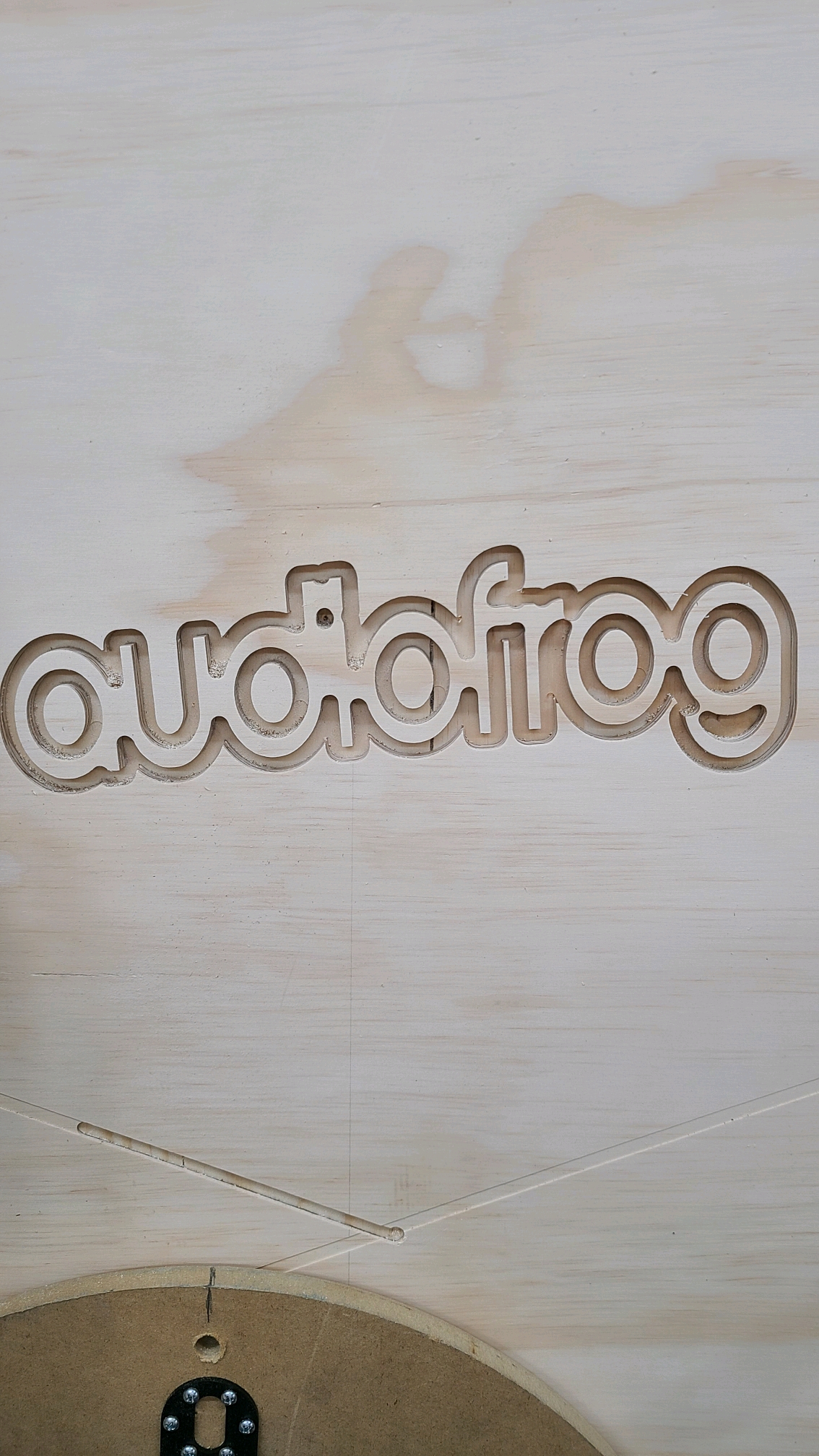

Alright I thought I had it calibrated correctly but my first trial cut is not quite level. What could be the cause and how can I correct it?

Looks like you may have jumped a sprocket tooth. Do you mark the chain and sprocket in ground control as is recommended in web control?

Chain skip is a definite possibility.
> [@How To: Manually Reset Chains, the Easy Way](https://forums.maslowcnc.com/t/how-to-manually-reset-chains-the-easy-way/9702):
> Every now and then you may find that you need to readjust the chains back to a known position. This could occur if you power/connection issue and the controller lost it’s position, had a chain skip, took apart something for some reason, etc… Fortunately, there’s a way to reset the chains without a lot of work. During calibration, after you set the sprockets vertical, you extend the chains out to reconnect to the sled. If your “Extend Chain Distance” is a multiple of a full revolution of the s…
Also, it often helps to run the calibration multiple times (2… sometimes 3 times) as each time it improves the accuracy of the machine, but the improvement diminishes with each calibration as it gets closer and closer to the optimum solution.
