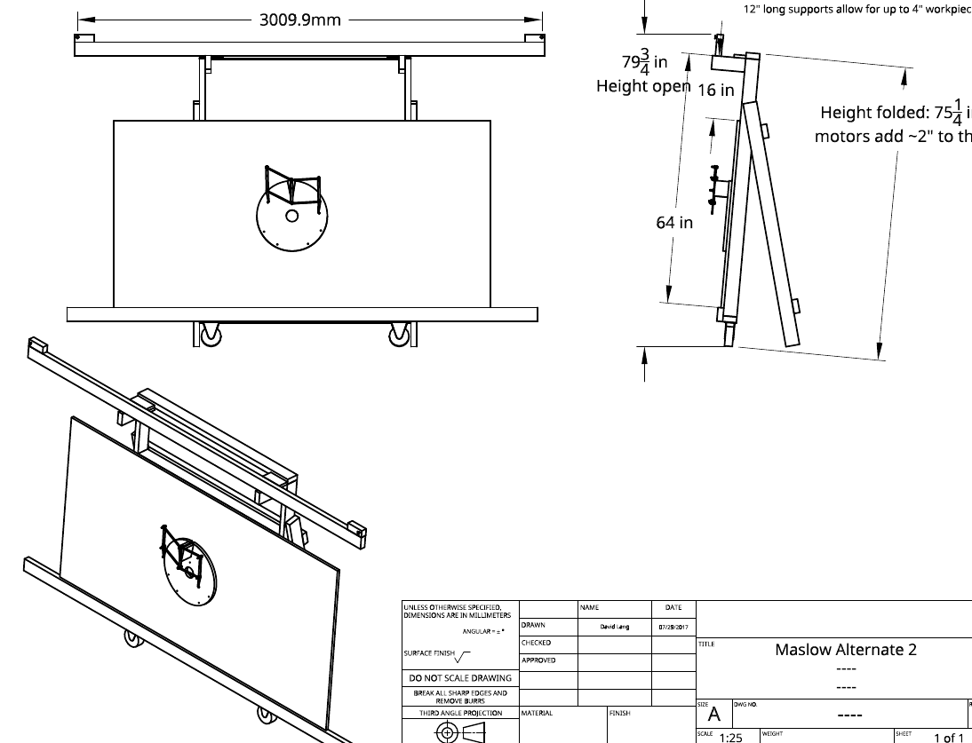

I have been working on a folding design for a while, and earlier on did an A-frame top-beam design. The A-frame design doesn’t have all the refinements of the folding one.
The A-frame design enlarges the A-frames from the stock maslow and still uses the plywood as structure.

The folding version I like a lot more, it’s built almost entirely out of 2x4s (with one potentially being a piece of unistrut) and the only thing it uses plywood for is the sled and brick mounts
 ![Maslow%20Alternate%202](https://canada1.discourse-cdn.com/flex031/uploads/maslowcnc/original/2X/f/fd4fc89ea88be24627e65cd6f948aa39177564cc.png)
The 2x4 cut list is pretty simple:
 ![Maslow%20Alternate%202%202x4%20cut%20list](https://canada1.discourse-cdn.com/flex031/uploads/maslowcnc/original/2X/c/c63aba0085a4098deb5def32cede163bf8ffed4b.png)

For the folding version, I put wheels under it so that when it’s folded, I can wheel it into the garage on edge. It would be pretty trivial to add fixed legs and fixed braces to convert it from a mobile design to one that’s fixed. There’s enough wood left in the last 2x4 to do this sort of thing

the whole thing is in onhape at [https://cad.onshape.com/documents/e635c24e358635f51da4b399/w/5a63b67113542f248fbe6d7b/e/7cf092bea21763650fb0c54c](https://cad.onshape.com/documents/e635c24e358635f51da4b399/w/5a63b67113542f248fbe6d7b/e/7cf092bea21763650fb0c54c)
