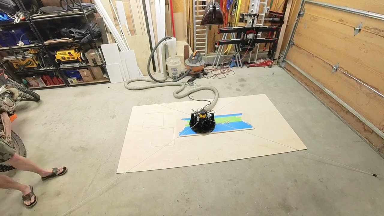

Back again to share some more of my experiences. After my initial tests/cuts above, I wanted to do a bit longer cut with some pockets. The company I work for is rolling out some new branding and our new logo and font seemed like a perfect fit, so I decided to make a sign out of 1/2 birch plywood that I had left over from another project. I made at time lapse of that if you’re interested:
[![](https://img.youtube.com/vi/ME7KRFQcvAA/maxresdefault.jpg "Making a sign with the Maslow 4") ](https://www.youtube.com/watch?v=ME7KRFQcvAA)
My dog helped a lot. Seen here holding one of the belts for me:
 ![Screenshot 2024-07-17 at 1.08.50 PM](https://canada1.discourse-cdn.com/flex031/uploads/maslowcnc/original/3X/7/8/78df4cd239faf3f5987fee151e16511e06a61657.jpeg)
Starting with this cut, I’ve been keeping notes on all my settings. I ended up using the following settings:
**Material** : .5" birch plywood
**Bit** : 1/8" spiral down cut
**Router speed** : 4.5
**Feed rate** : 40 in/min
**Plunge rate** : 12 in/min
**Depth/pass** : 0.05"
The sign is 26" wide by 6" tall and all the lettering and logo are pockets. Total cut time was 1 hour 5 mins. I then sanded and painted all the pockets. I am very pleased with the quality of the cut and how the signed turned out over all. I wish I could share a picture, but the new branding won’t be rolled out for a few months, so I can’t share anything publicly at the moment. ☹
Just for to note, I feel like I could easily up the feed rate to 45 in/min with the setup I had.

In your video, is that painters tape I see on the cutting surface? Was it to help with keeping the edge clean?
**Author:** ![rtadlock](https://yyz1.discourse-cdn.com/flex031/user_avatar/forums.maslowcnc.com/rtadlock/32/24777_2.png) [@rtadlock](https://forums.maslowcnc.com/u/rtadlock)\
**Post date:** [July 22, 2024, 10:27pm UTC](https://forums.maslowcnc.com/t/new-user-experience-and-first-cut/21850/9 "2024-07-22T22:27:49Z")
Actually my thoughts were I knew I was going to paint the logo and lettering, so I was hoping to avoid having to cut out the tape with an x-acto knife. Thought was I’d have perfect cut tape and voila! Turns out it didn’t really work that well and I ended up just pulling the tape off and re-masking it and cutting it.
I’ve never made a sign before, so maybe there is a good way to do it. Seems like mask → cut → spray paint/hand paint → peel and you’re good. I’ll have to keep playing with it.
Having said all that, and knowing my original plan didn’t work, we can just say it was there to help with a clean edge, which I feel it did as the edges of the letters and logo are very nice and the wood I used has a veneer on it that didn’t tear out or anything… 🤷‍♂️
