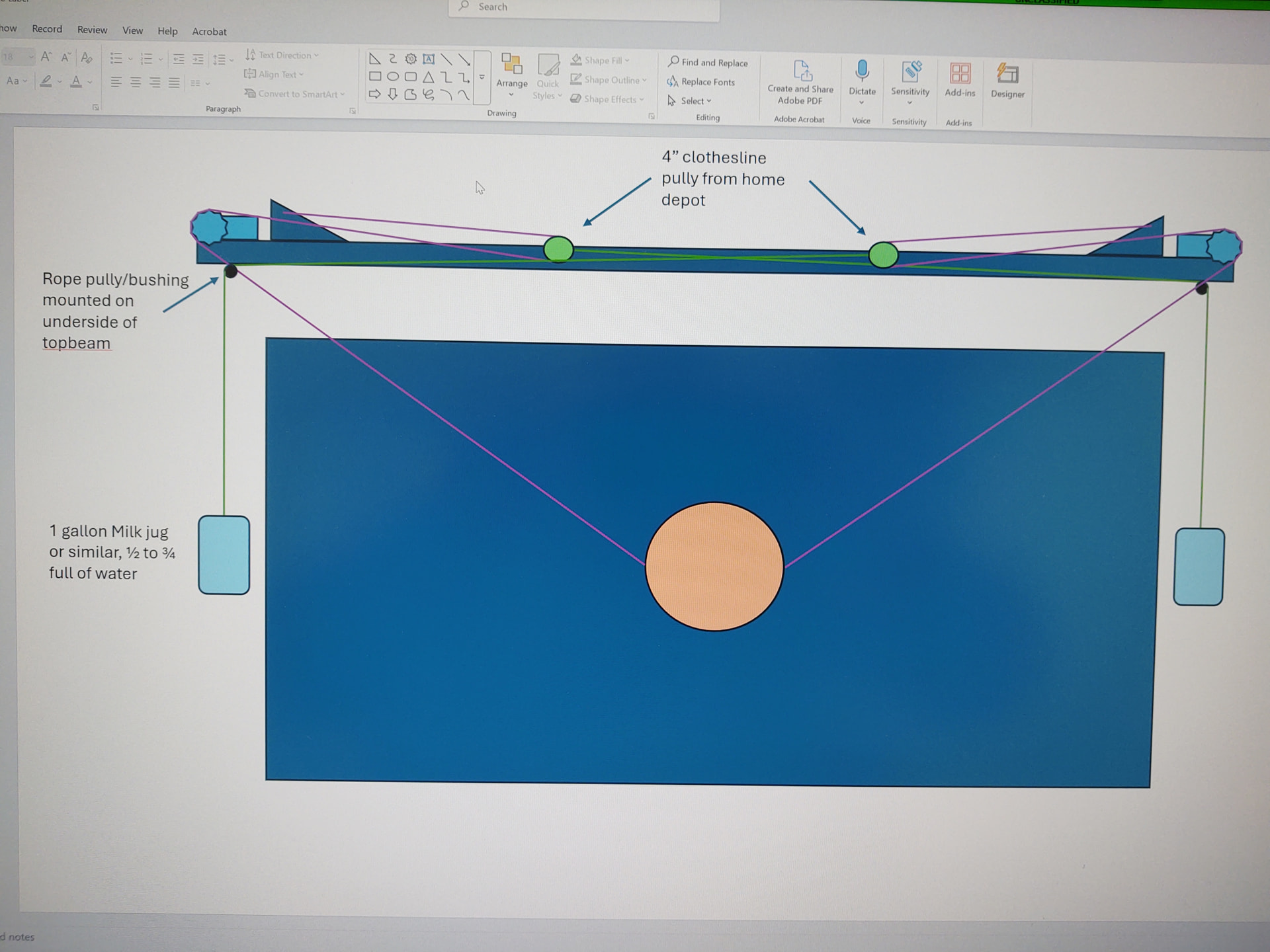

### Author: ![TimS](https://yyz1.discourse-cdn.com/flex031/user_avatar/forums.maslowcnc.com/tims/32/17329_2.png) [@TimS](https://forums.maslowcnc.com/u/TimS)
#### Post date: [November 12, 2025, 10:16pm UTC](https://forums.maslowcnc.com/t/original-chain-maslow-small-z-motor/25132/6 "2025-11-12T22:16:28Z")
I suggest abandoning the bungies and going with weights, like milk jugs filled about half full with water.
 ![IMG_20220821_162934087](https://canada1.discourse-cdn.com/flex031/uploads/maslowcnc/original/3X/d/9/d9c7ae38827c2b5d2f693f9e05198124e2373717.jpeg)
### Author: ![HeartlandTechie](https://yyz1.discourse-cdn.com/flex031/user_avatar/forums.maslowcnc.com/heartlandtechie/32/29495_2.png) [@HeartlandTechie](https://forums.maslowcnc.com/u/HeartlandTechie)
#### Post date: [December 7, 2025, 6:33pm UTC](https://forums.maslowcnc.com/t/original-chain-maslow-small-z-motor/25132/7 "2025-12-07T18:33:59Z")
Could you give me a better diagram of what you are doing there? That looks very intriguing. My weights just hang down, but this looks better to engage the chain/sprockets?
#### Post date: [December 11, 2025, 5:10pm UTC](https://forums.maslowcnc.com/t/original-chain-maslow-small-z-motor/25132/8 "2025-12-11T17:10:14Z")
![IMG_20251211_090927329](https://canada1.discourse-cdn.com/flex031/uploads/maslowcnc/original/3X/f/2/f221aad89937559d996f4f02018932b07938cad6.jpeg)
 ![IMG_20251211_091442367](https://canada1.discourse-cdn.com/flex031/uploads/maslowcnc/original/3X/3/b/3b31818b19140f5a0bf87a2c50d95e6c8ea05898.jpeg)
#### Post date: [December 11, 2025, 5:15pm UTC](https://forums.maslowcnc.com/t/original-chain-maslow-small-z-motor/25132/9 "2025-12-11T17:15:41Z")
Hope these diagrams help explain it better
#### Post date: [December 12, 2025, 12:52am UTC](https://forums.maslowcnc.com/t/original-chain-maslow-small-z-motor/25132/10 "2025-12-12T00:52:54Z")
instead of the bushings at the sides, you can get a sweep like
[https://www.homedepot.com/p/Cantex-3-4-in-90-Degree-Bell-End-Elbow-R5233824/202043345](https://www.homedepot.com/p/Cantex-3-4-in-90-Degree-Bell-End-Elbow-R5233824/202043345)
and run the rope to the weight through it.
