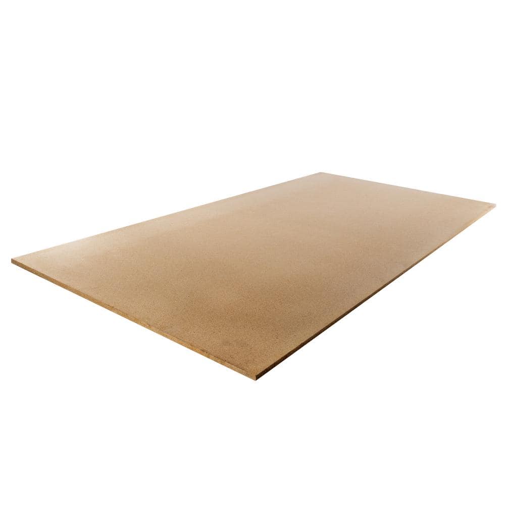

First, my constraints were 1) couldn’t bolt into the concrete 2) we wanted to get this used M4.0 up and running ASAP to see if it would even do what we need it to without spending time building a frame. So, I 3d printed the frogmouth anchors (seemed like less trip hazard. had to sand the inside so anchor could rotate smoothly inside) and bought 4 sheets of this 4x8 UL particle board from home depot. $26ea. 3 make up the frame and one is the spoilboard. (I realize now you could technically omit that last one and just let your 3 frame pieces BE the spoilboard.)
> **[TEMSTOCK 3/4 in. x 4 ft. x 8 ft. Tem S UL Particle Board 3shd12490970000 -...](https://www.homedepot.com/p/TEMSTOCK-3-4-in-x-4-ft-x-8-ft-Tem-S-UL-Particle-Board-3shd12490970000/311373992)**
> Provide the best and ultimate fun to your outdoor space at home by selecting this affordable Unbranded 3/ Tem S ULEF Particle Board ().

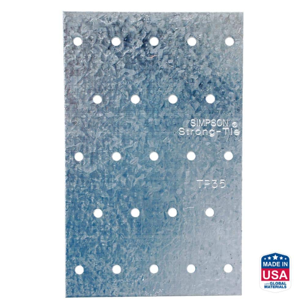

Attached together quickly with these
> **[Simpson Strong-Tie TP 3-1/8 in. x 5 in. 20-Gauge Galvanized Tie Plate TP35 -...](https://www.homedepot.com/p/Simpson-Strong-Tie-TP-3-1-8-in-x-5-in-20-Gauge-Galvanized-Tie-Plate-TP35/100375154)**
> Find the SIMPSON STRONG-TIE TP35-R Galvanized 20-Gauge Steel Tie Plate TP35-R, staggered nail pattern 20-gauge galvanized steel reinforce wood-to-wood connections on flat members at The Home Depot
And put some car batteries on each corner to make sure frame wouldn’t flex too much.

I like the concept. Quick and easy for sure. How are the corner anchors attached to the MDF? Im not sure how well wood screws will hold up under tension.

It is just wood screws for now… 7x) #8 x 3/4" Long, haven’t had any stripping (yet)! Probably should have put a nice layer of glue too.
