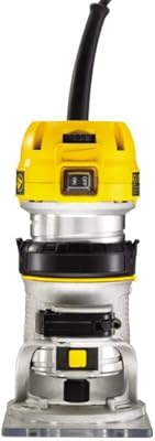

according to DeWalt website
they sell a DWE6000 here
but i am yet to find any dewalt retailers here that actually stock it
is this router ideal ?
> **[DeWalt D26200 1/4in Compact Fixed Base Router 230 Volt DEWD26200: Amazon.co.uk:...](https://www.amazon.co.uk/DeWalt-D26200-Compact-Router-DEWD26200/dp/B004ISXKC0/ref=sr_1_9?dchild=1&keywords=dewalt%2Brouter&qid=1588994000&sr=8-9)**
> Free delivery and returns on all eligible orders. Shop DeWalt D26200 1/4in Compact Fixed Base Router 230 Volt DEWD26200.
