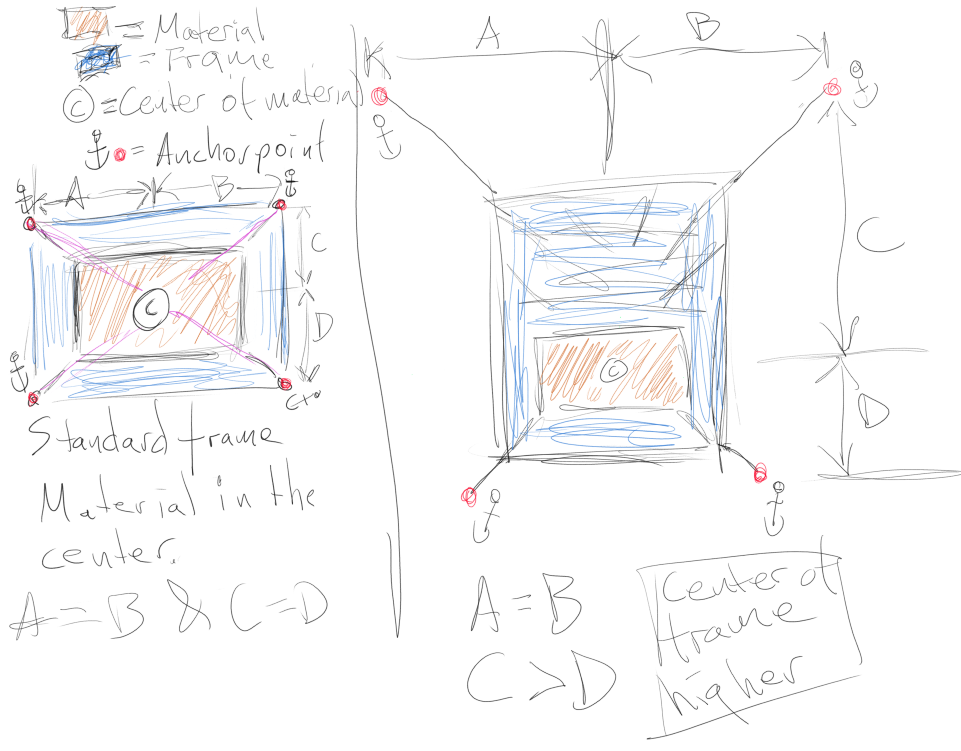

@bar: During the build, there has been a few eye-openers regarding size and flex for sure. And some theories have popped into my sawdust filled brain. They might already have been discussed, and maybe even answered?
1- Am I right in assuming that the old Maslow had less restrictions in regards to movement in the outer corner-edges?
2 - Did that lead to more accuracy at the edges even with a smaller frame?
3 - What would happen if we were to move the center of material further down, as in an asymmetric placement of the material in the Y-axis. Could that be configured in FluidNC?
4 - How would asymmetric placement of the bottom anchors compared to top anchors affect the angles of the arms and belts? Apart from needing longer belts on two arms.
For example:
 ![Asym_Frame](https://canada1.discourse-cdn.com/flex031/uploads/maslowcnc/original/3X/8/3/83965c2079657bb044c8c66c5a232bce9d9fde10.png)
3 -
**Post date:** [November 9, 2024, 10:25pm UTC](https://forums.maslowcnc.com/t/regarding-stiffness-of-a-foldable-frame-and-installing-a-500w-brushless-spindle/21886/18 "2024-11-09T22:25:37Z")
take a look at [http://lang.hm/maslow/maslow4\_frame.html](http://lang.hm/maslow/maslow4_frame.html) for the red areas, that is based on the allowed angles and distance between adjacent anchors. The green area is based on the allowed angle and distances between opposite anchors (so the green lobe in the top right is based on the angle and the top left and bottom right anchors) All the calculations re in the html (it’s done in svg), I would be willing to work with someone who wanted to adapt it to non-rectangular anchor positions.
the old version of the maslow didn’t have the 4 vertical posts, so it didn’t have the same problem with the angles. However it had much weaker motor drivers and a smaller power supply, so you could run out of power at the top center. And in the bottom corners you are entirely dependent on gravity to move you towards the outside edge.
Also, with only the two chains, there was no way to self-calibrate the way the maslow 4 does, so you had to very carefully measure where the motors are, so in practice, the maslow 4 is more accurate than just about anyone was able to get with the earlier version
As you go to use your machine, put a camera pointing at the anchor corners, I suspect that they will flex sideways to the arm a bit.
**Post date:** [November 10, 2024, 12:15am UTC](https://forums.maslowcnc.com/t/regarding-stiffness-of-a-foldable-frame-and-installing-a-500w-brushless-spindle/21886/19 "2024-11-10T00:15:34Z")
> [@Tore](#):
Quite the opposite! Having the lower belts lets is maintain tension closer to the corners
**Author:** ![Tore](https://yyz1.discourse-cdn.com/flex031/user_avatar/forums.maslowcnc.com/tore/32/25202_2.png) [@Tore](https://forums.maslowcnc.com/u/Tore)\
**Post date:** [November 10, 2024, 6:43pm UTC](https://forums.maslowcnc.com/t/regarding-stiffness-of-a-foldable-frame-and-installing-a-500w-brushless-spindle/21886/20 "2024-11-10T18:43:58Z")
Thank you @dlang and @bar. I have used the page a lot to find out how big my frame should be 🙂 It’s a really nice tool.
I guess I had the right idea when thinking about the angles, but failed to consider the tension of the belts.
With regards to the flex of the arms, it will get more support from horisontal beams. The anchors are 4500 and 3000mm apart. It should fit a full 2440x1224 plywood in the green zone. The “material-area” is fine-tuned to have the center and corners in the exact same height.
The model is a quick prototype based on the available materials. Looking forward to get the Maslow set up and test it properly to see where I need to improve it.
