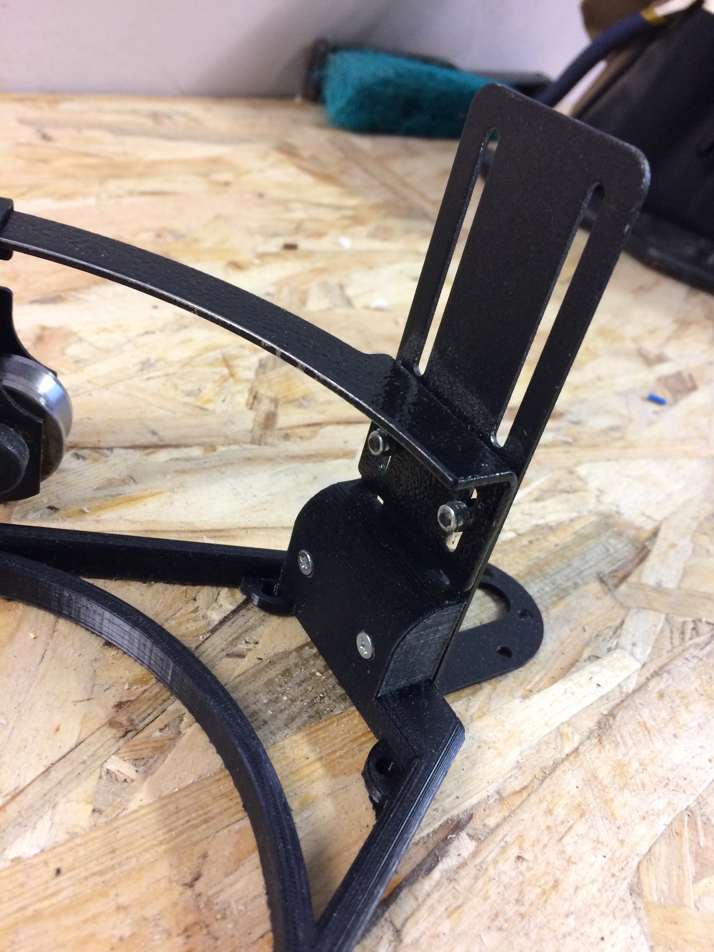

I want to address one accuracy error source - misalignment of router bit and ring axis. Here is my take on that challenge - forcing both into align position.
I design a “frame” which hold router and legs of ring in proper position:
 ![08](https://canada1.discourse-cdn.com/flex031/uploads/maslowcnc/original/2X/f/f7238ccf76ad54182fe3919f21744c9d116ac5b3.png)
And printed it in PLA - now legs are perpendicular to sled, ring is forced into rigid position and router (in my case it is AEG) sits exactly in center;
 ![IMG_6397](https://canada1.discourse-cdn.com/flex031/uploads/maslowcnc/original/2X/5/552bd1c6b6490e9c9c9d01d3d3225fc81e68b1b4.jpeg)
Here is full assembly;
 ![IMG_6401](https://canada1.discourse-cdn.com/flex031/uploads/maslowcnc/original/2X/a/a4503ffb4b01a6b741c8dcbde42552826a2a1c13.jpeg)
And two closeups with details
 ![IMG_6400](https://canada1.discourse-cdn.com/flex031/uploads/maslowcnc/original/2X/9/9b6512532d30e663b80d248876040c3c3924caad.jpeg)
 ![IMG_6399](https://canada1.discourse-cdn.com/flex031/uploads/maslowcnc/original/2X/0/0bdf3a8ac71962f0cf2b7742fa5b8da546c71137.jpeg)
If you like it let me know how upload stl file.
Stay tuned for test runs, but first I am rebuilding my table.

What size is the part as I suspect that I may not be able to print this part on my 3D printer?
Is it possible to generate the part in another format / design so that we can cut them with the Maslow?
### Author: ![TomD](https://avatars.discourse-cdn.com/v4/letter/t/b4bc9f/32.png) [@TomD](https://forums.maslowcnc.com/u/TomD)
#### Post date: [January 28, 2019, 4:17pm UTC](https://forums.maslowcnc.com/t/ring-and-bit-alignment-printed-kit/8577/11 "2019-01-28T16:17:31Z")
Frame fits to 300mmx300mmx40mm printer bed (in my case Creality CR10s)
Once @bar will fix Garden bug I will post stl file.
It should be easy to create “contour cutting toolpath” from that stl file and generate Gcode (Fusion360 - Manufacture menu). I can imagine using 5 - 10mm plywood to make couple of slices and glue them together.
Under one condition! You Maslow is accurate and precise - good calibration is a must.
