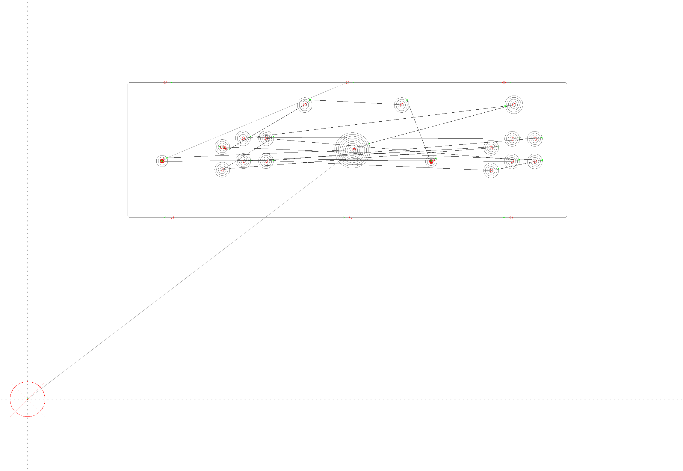

Been cutting a few arcade cabinet control panels, I designed in photoshop, converted to SVG then brought my design into makercam. I used a pocket operation for the buttons and joysticks and an outside profile cut for the outside cut.
The issue I’m having is when cutting in groundcontrol it will do a small pass on one button hole then move to another and another until all of them are at the same depth then it repeats until it routes all the material out. Unfortunately because it’s doing this, it’s taking nearly 4 hours or more to cut a simple control panel. I don’t mind that it’s making a lot of shallow depth passes but I do have an issue that it only makes one pass on a button hole then moves on to another. The moving of the sled from one to another and back again is so slow. I’d rather it just work on one hole until it’s done then move on to another.
So my question is at what point in the design process can I edit this so it cuts more efficiently and how?

You can try a gcode optimizer… i linked one I found in a thread somewhere here… you can also try Easel. Even though it’s intended for specific products, you can use it to create gcode that will work with maslow. I found that it’s much more otimized than what makercam puts out.

A G-code optimizer! Of course! Thank you so much! I’ll try that and if it doesn’t work out I’ll try easel. Thanks very much!

I agree. I am going to try the optimizer… But until then, making the holes EACH THEIR OWN operation will prevent what you described above. I have experienced this. It is a result of what is quicker in design. In this case, however, taking the time to assign all cut criteria separately will save much unnecessary z-action and travel. Hopefully the optimizer makes all this moot! 🕶

I see, so your saying to select each hole one at a time and make it its own profile rather then selecting all holes and making one profile? This will at least help the traveling salesman? So if my assumption is correct, when I select all holes and make one profile, the software just does whatever it feels like? I wonder if creating the profiles in the order I want them cut works? At least now I have some things to play around with and test.

UPDATE:
I went back to my photoshop design and fixed some issues from the first design and then took it into makercam and made sure to assign each button its own profile and in the right order. I also found a G-Code optimizer from XYZBot that did even better. Here are the results before and after.

Yeah it was pretty easy, i just uploaded my code from makercam, hit start and it goes until you stop it. My original (new redesign with individual profiles) was already pretty optimized. The first cut I made which failed amazingly at hour 12 was a travesty. I’m cutting the new optimized design and I’m about 2 hours in at 52% so already a 50% improvement. I estimate a 4 hour and 30 minute runtime, which would be better if my bit wasn’t getting dull. Tomorrow I’ll change out my bit and try to optimize the pocket profiles even more. At least I’m learning the software.
