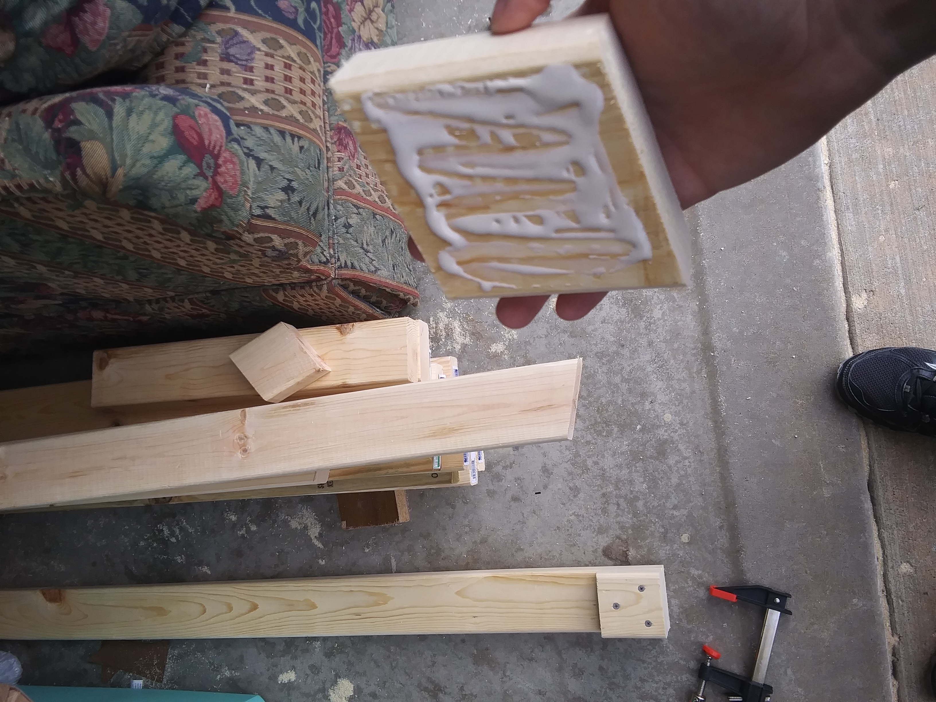

First things first, Attach the Square block to the bottom of the rear upright make sure it’s squared to the wood, and flush with the bottom edge.
 ![20190203_144315%5B1%5D](https://canada1.discourse-cdn.com/flex031/uploads/maslowcnc/original/2X/8/8779402e08ffc90ab25ef1a79e741e89618a330b.jpeg)
