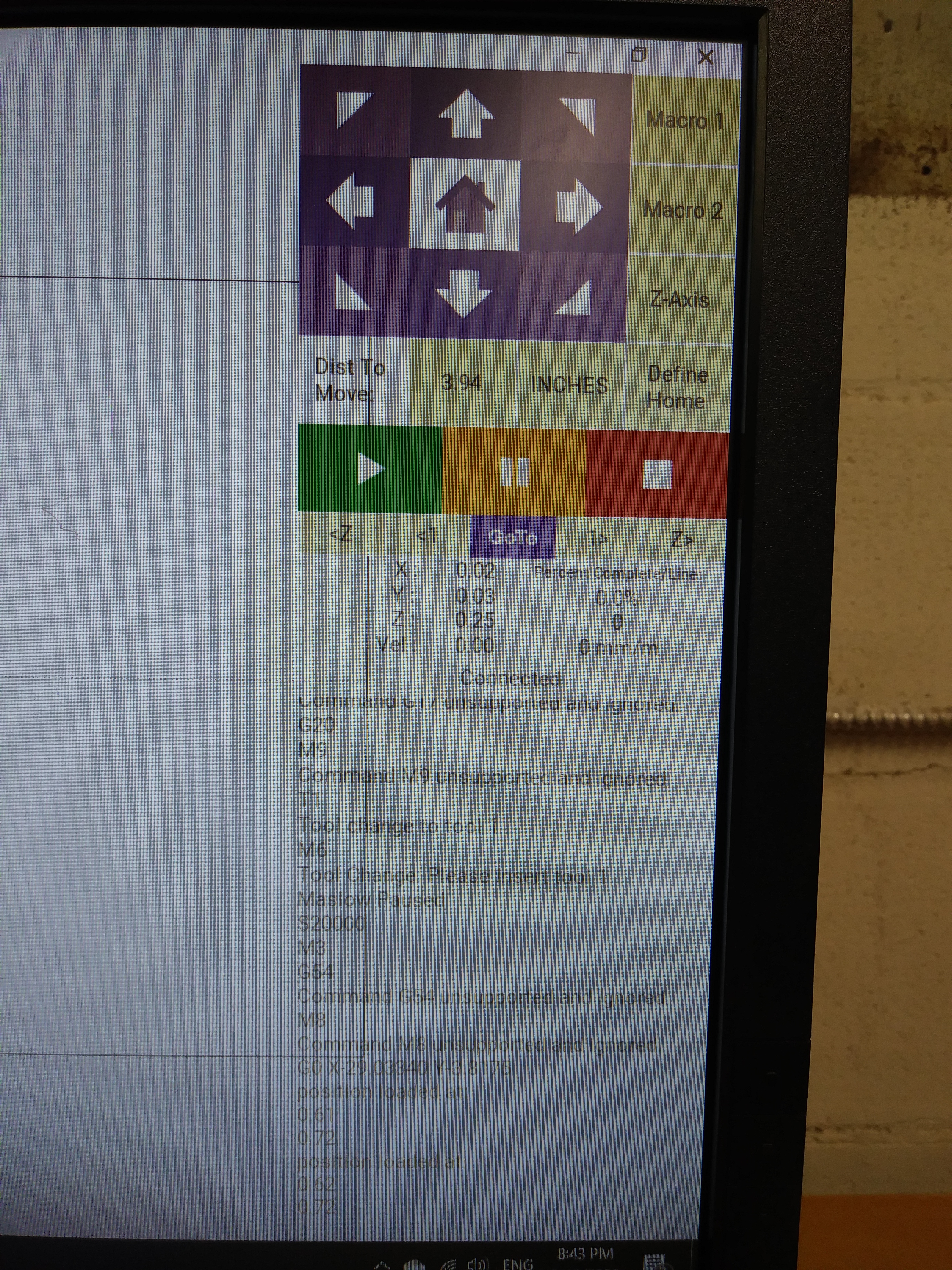

![20200512_204329](https://canada1.discourse-cdn.com/flex031/uploads/maslowcnc/original/3X/b/5/b501edbc43e8b7a2cdd9bd06e4c4a8c002ac7322.jpeg) ![20200512_204400](https://canada1.discourse-cdn.com/flex031/uploads/maslowcnc/original/3X/4/9/491ba016be9de729af25cd3adefbc299bd7d0ff1.jpeg) ![20200512_205908](https://canada1.discourse-cdn.com/flex031/uploads/maslowcnc/original/3X/a/d/ad151418375bd460b959d84851a9859b554b2711.jpeg)
Just upgraded to meticulous z-axis and finished some calibration only to get an error that my sled can’t keep up. Attached are the messages I’m receiving with regards to my g-code. My g-code is exported from fusion 360 and it was running fine before I upgraded my z-axis. I relaxed the tolerance in the advanced settings for the alarm (from 2 to 10), but it still wouldn’t budge an inch. The sled refuses to move currently, but the calibration process went perfectly.
I’m wondering if weight would be an issue with regards to sled…

Everything is plugged in and motors work fine, but i’m still getting error messages. I even tried removing weight to see if that was the issue. I’m seeing info in the forums about posting through Maslow. I usually post through easel, but it sounds like there may have been some updates that necessitates me posting through Malsow now. I downloaded the file, posted the g-code through Maslow, tried to open the g-code through ground control and GC cannot find it.
Upon further inspection, it appears the file is NOT a .NC file type. It is a 0 file type…That sounds like something went wrong. Am I missing something here?
I am not a coder, but do I now need to learn to read the text file of g-code to properly identify lines of code for future issues? If so, any good resources to understanding the commands?

Try opening your gcode file in notepad and see if you can read it. It will likely have some M##, some G##, some X##, Y##, I##, J##, Z##, and F## where ## is a number. Oversimplifying: it is just lines of numeric coordinates or speeds. Lines in () are comments and are ignored.
Sometimes if you use a non maslow post processor, it may not set your file extension (must be .nc .ngc .text or .gcode - according to webcontrol file filter) and i may include commands that are not compatible with maslow.
If opening and the text looks reasonable, change the file extension to .nc or .gcode and try again.

I’ve relaxed the tolerance to 30mm and have raised, reduced, etc. of the max feedrate. The primary errors I’m receiving are command lines not being supported and ignored. Once I resume cut, then I get the ‘sled cannot keep up’ error message. This is with the G-code attached, which I have posted from fusion 360 through the easel filter thingy.
The next step will be trying to post from fusion 360 using the Malsow filter thingy (idk the terminology) to get a proper .NC file or something that Ground Control recognizes. The last time I did that it gave me a .0 file type (see attached).

I thought I found it, but I guess I’ll have to double check and triple check if it’s the correct one or if there’s a newer version.
If you look at the original photos in the post, you can see I get errors immediately with regards to unsupported command lines. Once I “resume cut” it gives me the sled error. The whole time the motors don’t move and the sled doesn’t budge.
That being said, motors work fine during calibration.

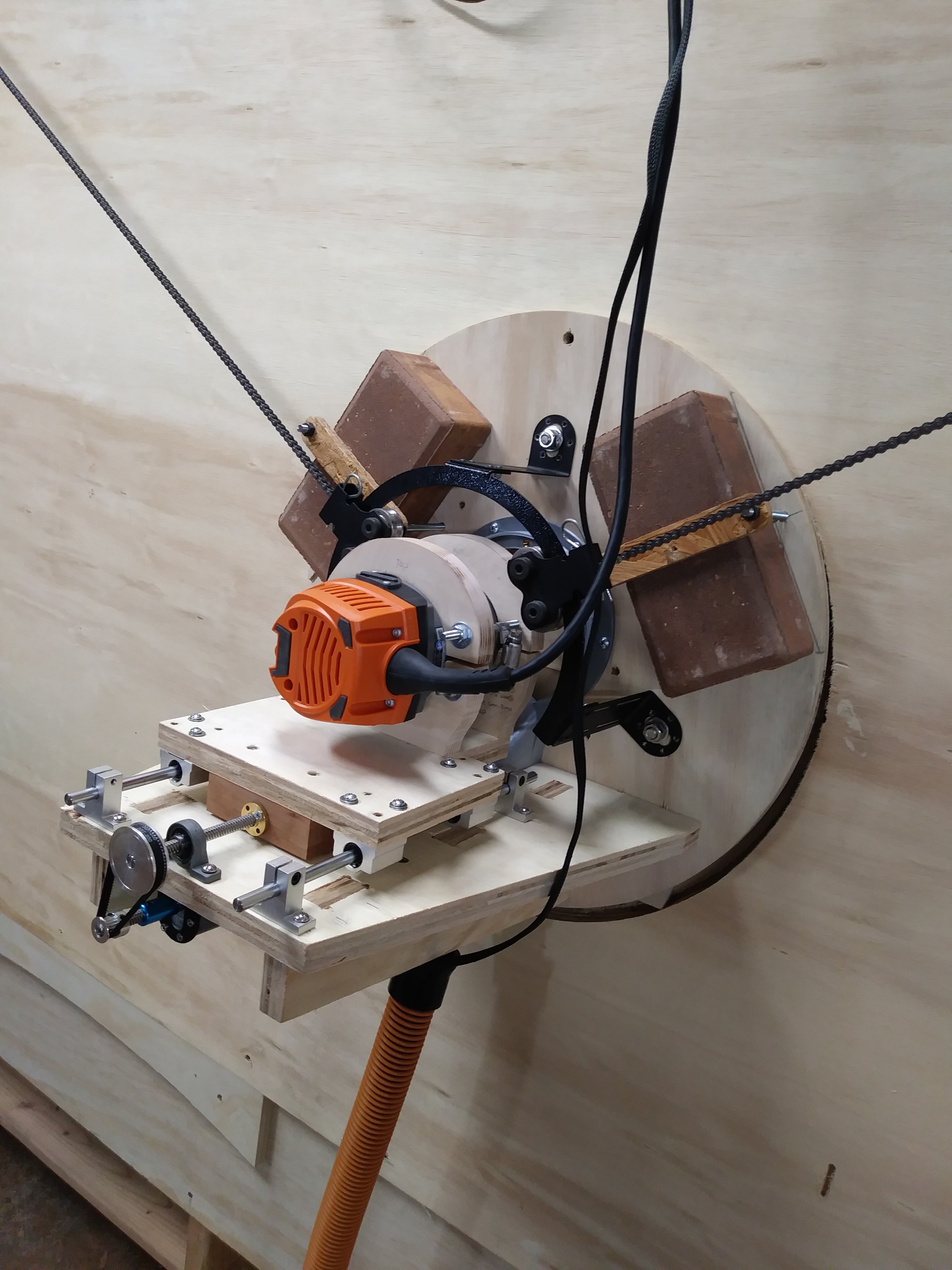

![20200520_233340](https://canada1.discourse-cdn.com/flex031/uploads/maslowcnc/original/3X/a/8/a8a864e2377e02c17f975878f0b3001f4ed18b4f.jpeg)
Above is my first test cut since I upgraded the z-axis (It’s the logo of my makerspace). I need to tinker with the hardware on the sled a bit more, but overall I’m happy with the result.

 ![20200527_213434](https://canada1.discourse-cdn.com/flex031/uploads/maslowcnc/original/3X/c/0/c02c153fd0dbda4beb4e8633ab3810b7d7aebf53.jpeg)
Added some better weight to the sled and secured the ring supports to keep them from flexing.
I attempted to cut the pvc sled base this evening, but got the old “sled cannot keep up” error again. After checking the file multiple times, I attempted to calibrate; no motor response. Tested motors; they all failed.
I’m assuming the sled cannot keep up THIS time due to the motors failing. Any ideas?

When they all fail it’s almost always an issue with the board not getting power. Is the green power light on on the board illuminated and the blue light on the power supply also illuminated?

your sled looks good. I’m curious why you placed your belt gears the way they are. You could have a z-axis pitch of 24 if you swapped the pulleys places with the 60 on the motor and the 20 on the lead screw. This will dramatically increase your z axis speed an justify the whole upgrade (in my opinion). As you have it, you have a pitch of 8 with a 3:1 reduction = 2.6666. The axis will actually run slower than the rigid z axis set up (3.17) like you have it. Perhaps trying it like this might be a a speed improvement:
 ![image](https://canada1.discourse-cdn.com/flex031/uploads/maslowcnc/original/3X/4/4/44326cf294d4d7218d2df41ec28e6255e793bbb6.jpeg)
The motors have more than enough resolution to support this z axis setup. As far as the not keeping up error, double check your vacuum tube isn’t binding and pinning the sled. The only legit sled not keeping up error I had was when the z axis motor wire got caught on a cut section of the work piece and the sled couldn’t move.
A second option is to make sure the “sled not keeping up” error setting is higher than the default of 2. In webcontrol, look for it under one of the settings menus. Change it from 2 to 20 and retry.

It was indeed a power issue! connections were a bit loose for the power block.
I will now look into reversing the heads of the pulleys for better z axis speed and to recalibrate the z-axis. Hopefully this will solve all my z-axis issues.
