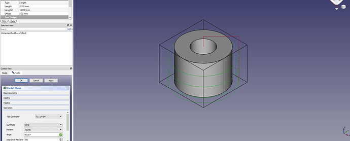

**Author:** ![Archie\_Slate](https://yyz1.discourse-cdn.com/flex031/user_avatar/forums.maslowcnc.com/archie_slate/32/14381_2.png) [@Archie\_Slate](https://forums.maslowcnc.com/u/Archie_Slate)\
**Post date:** [October 6, 2019, 10:19pm UTC](https://forums.maslowcnc.com/t/step-by-step-guide-to-creating-gcode-for-the-maslow-with-freecad/5279/29 "2019-10-06T22:19:55Z")
I am having trouble with the “path pocket”. I clicked the button that seems to be correct but I have different selections then shown on screenshot:
 ![gcodetutpocket](https://canada1.discourse-cdn.com/flex031/uploads/maslowcnc/original/2X/f/f9cdfe5f3c18bb50ed973897c2eb3db61addcec6.png)
Edit: I was looking at wrong screenshot. Noticed the 2nd photo isn’t selectable so when I hit the next arrow from first one, it skipped ahead 3 screenshots to the next selectable one. Unfortunately I’m still stuck as the second screenshot is too small for me to read
 ![poc](https://canada1.discourse-cdn.com/flex031/uploads/maslowcnc/original/2X/5/5dc742c3c97de72c420d67f410bfe7f304a144dd.png)
**Author:** ![Walt\_Moorhouse](https://yyz1.discourse-cdn.com/flex031/user_avatar/forums.maslowcnc.com/walt_moorhouse/32/7512_2.png) [@Walt\_Moorhouse](https://forums.maslowcnc.com/u/Walt_Moorhouse)\
**Post date:** [October 7, 2019, 6:58pm UTC](https://forums.maslowcnc.com/t/step-by-step-guide-to-creating-gcode-for-the-maslow-with-freecad/5279/30 "2019-10-07T18:58:14Z")
Archie,
When making this tutorial, I just left the defaults in the options you have indicated.
However, I was working on a new piece over the weekend and noticed that in the newest version of FreeCAD, I’m having issues with Path Pocket. I’m using 3D Path Pocket now. The button is on the far right of the Create Path toolbar, or you can go to the Path menu then select 3D Pocket and try that. If you’re still having issues, try using a smaller diameter router bit in the tool setup. If the tool diameter is wider than the path it is trying to make, it won’t make the path.
Let me know if that helps!
~Walt
**Post date:** [October 7, 2019, 10:51pm UTC](https://forums.maslowcnc.com/t/step-by-step-guide-to-creating-gcode-for-the-maslow-with-freecad/5279/31 "2019-10-07T22:51:36Z")
Thanks Walt, I’ll give it a try when I get home.
Edit from home: Used “3D Path Pocket” and it seems to be working

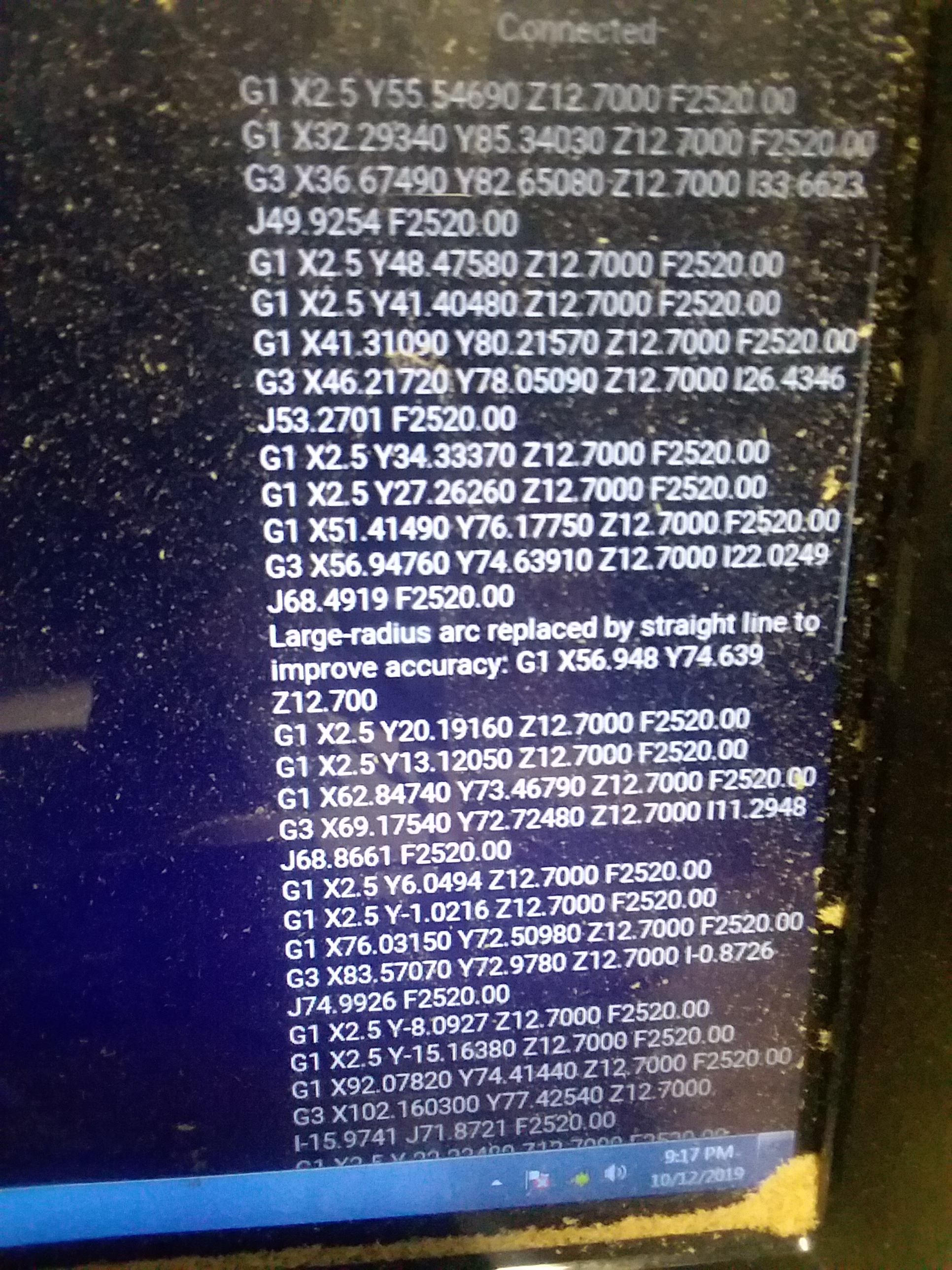

**Post date:** [October 13, 2019, 1:57am UTC](https://forums.maslowcnc.com/t/step-by-step-guide-to-creating-gcode-for-the-maslow-with-freecad/5279/35 "2019-10-13T01:57:26Z")
Was able to create gcode and run project but Ground Control changed a curved line to straight one for “improved accuracy”. My best guess is it did this because the details were too small for my 1/4" bit but not really sure.
 ![20191012_211645](https://canada1.discourse-cdn.com/flex031/uploads/maslowcnc/original/2X/c/c4fb0344f0336e2973cf43f8c19bb7b6ffab53e9.jpeg)
**Author:** ![SnailPowered](https://yyz1.discourse-cdn.com/flex031/user_avatar/forums.maslowcnc.com/snailpowered/32/14208_2.png) [@SnailPowered](https://forums.maslowcnc.com/u/SnailPowered)\
**Post date:** [October 14, 2019, 12:40am UTC](https://forums.maslowcnc.com/t/step-by-step-guide-to-creating-gcode-for-the-maslow-with-freecad/5279/36 "2019-10-14T00:40:36Z")
Yeah, it says that a lot on the Maslow M when you’re cutting it as well, and that’s not overly straight in any direction but it cuts well lol I wouldn’t be worried about it, personally.

Lol nice trick. I posted to FreeCad forums as well and it seems the pocket issues were caused by my use of b-spline to create the curve. Changed sketch to two half-circle arcs and path pocket worked just like your demo. 👍
**Post date:** [October 14, 2019, 5:50am UTC](https://forums.maslowcnc.com/t/step-by-step-guide-to-creating-gcode-for-the-maslow-with-freecad/5279/39 "2019-10-14T05:50:00Z")
it’s not uncommon for CAM to require a little clearance between the bit and the
next line to be cut (not allowing you to go exactly the width of the bit), how
much clearance is usually configurable if you dig deep enough.
