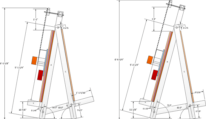

I made it thicker towards 44x94.

remember, the original frame was 2x4s weak side forward, so a 2x3 strong side forward is going to be stronger.
These are images of the design I was working a few hundred posts back. You can see how the CoG at 10 degrees could be worrisome. 15 degrees is much more comfortable… hopefully comfortable enough. The pivot point is the back edge of the front leg. The motor and top beam is behind the pivot point at 15 degrees but not at 10 degrees. We should check this on the actual design, though.

My biggest concern is that right now the design is using an angle bracket, is
that correct? There is not time to add that bracket to the upcoming batch
which will be an issue.
That was an attempt to simplify and error proof the top beam mounting, we can
still use the 2x4 or stacked/bolted blocks.
I think that if the top beam is flat as opposed to standing up there should be no problem with the assembler screwing it down. I think that without a drill press or a portable drill guide it would be difficult to get a bolt straight through 7" of 2x without coming out the side.
note that it’s only needing to go through 3.5" of 2x4, not 7" (lag bolt through one board into the other), so it’s not quite that bad, but I agree laying it flat makes it easy.
extending the kicker to 30" makes it hit the ground right about 15 degrees. any steeper than that and we need to move the bottom of the work area higher or not have the legs symmetrical (which I think significantly complicates the build)
I haven’t checked that the legs still work at that angle. I’ll do that later tonight.
Please let me know if I should just leave it at 10 degrees and not fight it :slight_smile:
