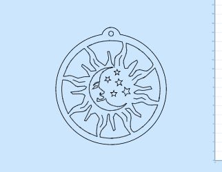

Ok, I am working on another cut. I told makercam to put tabs in. But while watching Maslow cut, I am seeing no signs of the tabs be left in.
I left it be the default, 5" apart and. 25 x. 25
I did not see a visual representation of them. And in watching now… They were not present in the gcode.
 ![20170820_172531](https://yyz1.discourse-cdn.com/flex031/uploads/maslowcnc/original/1X/f520142198dcacabdb5aeae1b2313c0032b837b4.jpg)
**Post date:** [August 20, 2017, 9:38pm UTC](https://forums.maslowcnc.com/t/tabs-in-makercam/501/2 "2017-08-20T21:38:37Z")
the tabs will only affect how the maslow cuts for the last layer of the cut.
**Post date:** [August 20, 2017, 9:42pm UTC](https://forums.maslowcnc.com/t/tabs-in-makercam/501/3 "2017-08-20T21:42:36Z")
You add the tabs after you’ve done the calculate step, right? After you open the file in GroundControl, you can see each place with a z-axis movement as a red circle. The tabs should show up there.

Yes, I calculated all, then selected my outside cut and told makercam to add in tabs. I then exported out and loaded into GC. Zooming in, I do not see any tab cuts.
I did get it setup now to cut the letters out first then the outside shape. So at least I should get a good cut this next attempt.

You need to tell MakerCAM how far apart to put the tabs, not how many. Use the diameter of what you’re cutting to get 3 (pi is pretty close to 3, plus didn’t a state have a law to make it 3?)
It doesn’t allow for your bit size, so add one bit diameter to the tab width to allow for the radius on both sides.
Iirc you subtract the tab thickness (I like around a sister that) from the work thickness for the depth over the tab. There’s a short YouTube video (it’s not just for cats anymore!) on tabs in makercam

It’s really easy, set the bit, set the thickness, I always at about 1or2 hundredths to the material thickness to make sure I get through. Then up on the menu in machine, click on advanced, and you can generate and download your Gcode. The Gcode runs in GC nicely. No issues for me.
You can edit points in the design by double clicking on a line in the design window. It has a 3d view of the cut. I suggest also clicking the simulate in lower right. If you then hit the ‘hide material’ you can see the cuts/toolpaths it creates. This way you can see if words or lettering/numbers are fully being cut, or smaller details.
I recommend watching Mo, her tutorials are sometimes long, but easy instruction. They sell compatible materials and bits through the site, and the projects are shareable with others. There is a projects area that you can cut and change other projects to suit your needs. Play with it and have fun.
Try this little deco, cut it or add to it if you like.
> **[New sun moon stars .5 .125 12in](https://easel.inventables.com/projects/chzn-tbJDoLXVbSKqECleg)**
