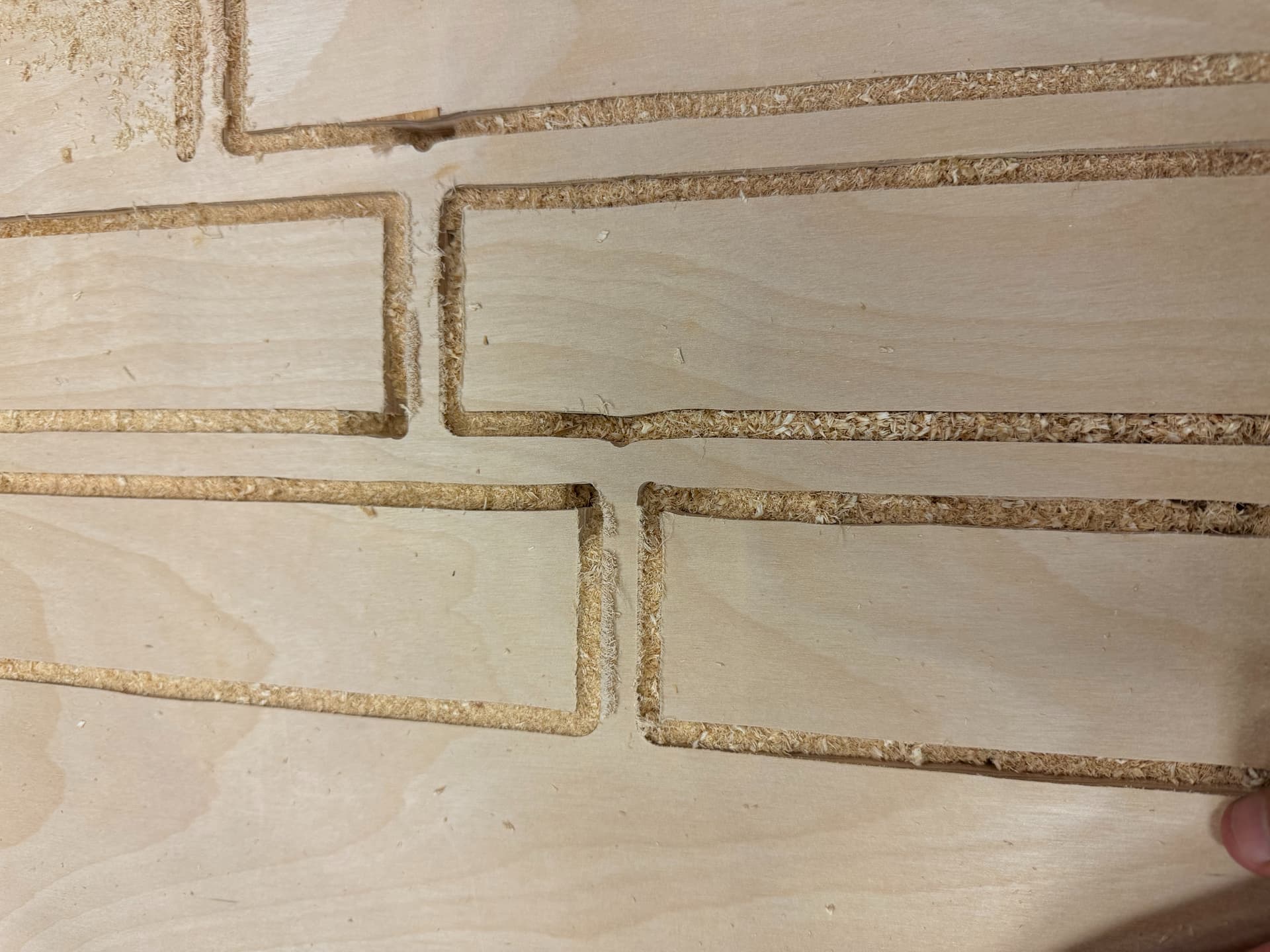

Hi all,
I am running a fairly long job on the Maslow4, and I noticed that there is some inaccuracy, namely that lines that are supposed to be straight are curved near the start of the cut.
I am cutting 3/4" plywood, and I realized that when generating the Gcode, I never marked the flag to keep the cutting bit down. As a result, when cutting out a contour, it runs the depth at -0.3", then moves to +0.2", then cuts at -0.55, back up to +0.2, then -0.8, then up to +0.2 to move to the next piece.
I have set up the maslow using cement anchors, meaning that the Z- anchoring is way lower than the cutting surface.
I have observed that the tension in all 4 belts is correct at the top of the Z axis (+0.2"), but as soon as it plunges down, the trailing belts are very loose.
Is it possible to make some software adjustment for tension when moving down the Z-axis, as the current behavior isn’t great?
The software does adjust the belt length for the Z position, but that requires
that the Z offsets in the maslow.yaml are correct and that the Z axis is all the
way down till it stops moving when you do the calibration is done.

no, Z stop is the point where the router is all the way down with no bit in it
(run it until the Z steppers both just humm and can’t turn any more)
that should be set before you do calibration.
Z offset is SUM(material thickness + spoilboard thickness + spool offset from
base with the z stop at zero
then when you put in a bit, you set Z home as the point where the bit is just
touching the workpiece

thanks so much for the clarifications!
Turns out I miscalibrated it by running the calibration with a bit inserted - will fix that tonight.
