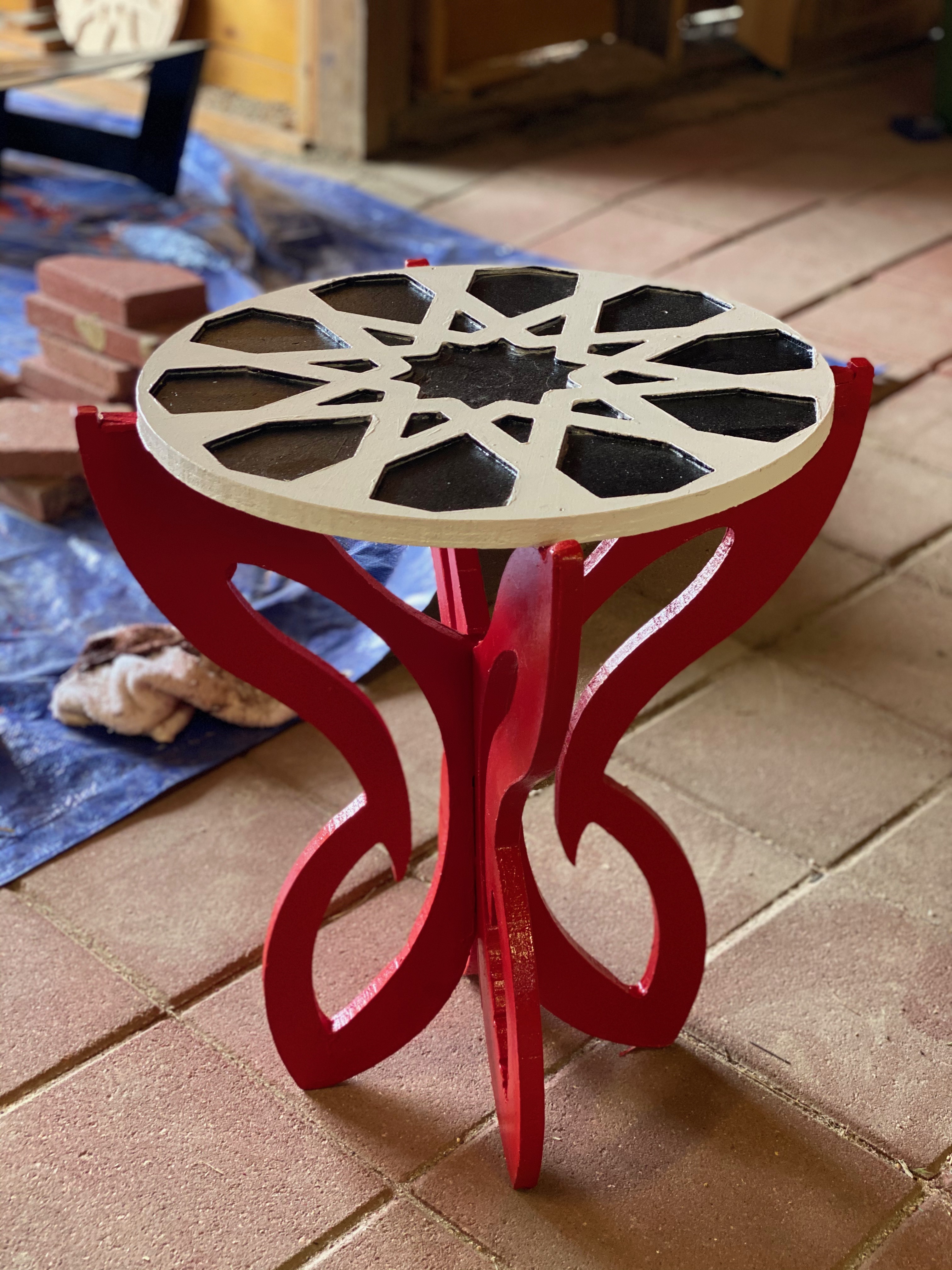

I bought a bunch of bits and have been experimenting with them. So far, I think the 2-flute spiral downcut is my favorite. It can run at a relatively low RPM and is relatively cheap, yet leaves a nice top surface. However, I’ve found that the upcut or compression bits seem better at holes.
My partner has started to learn the sanding/painting process. Her painting background translates well, but she’s learning to work with new materials. She’s humble, but I think they look great:
 ![butterfly-table-](https://canada1.discourse-cdn.com/flex031/uploads/maslowcnc/original/3X/4/1/417bcfcf7abe9ab6b937ce7b9400aa43bf7c9dd9.jpeg)
