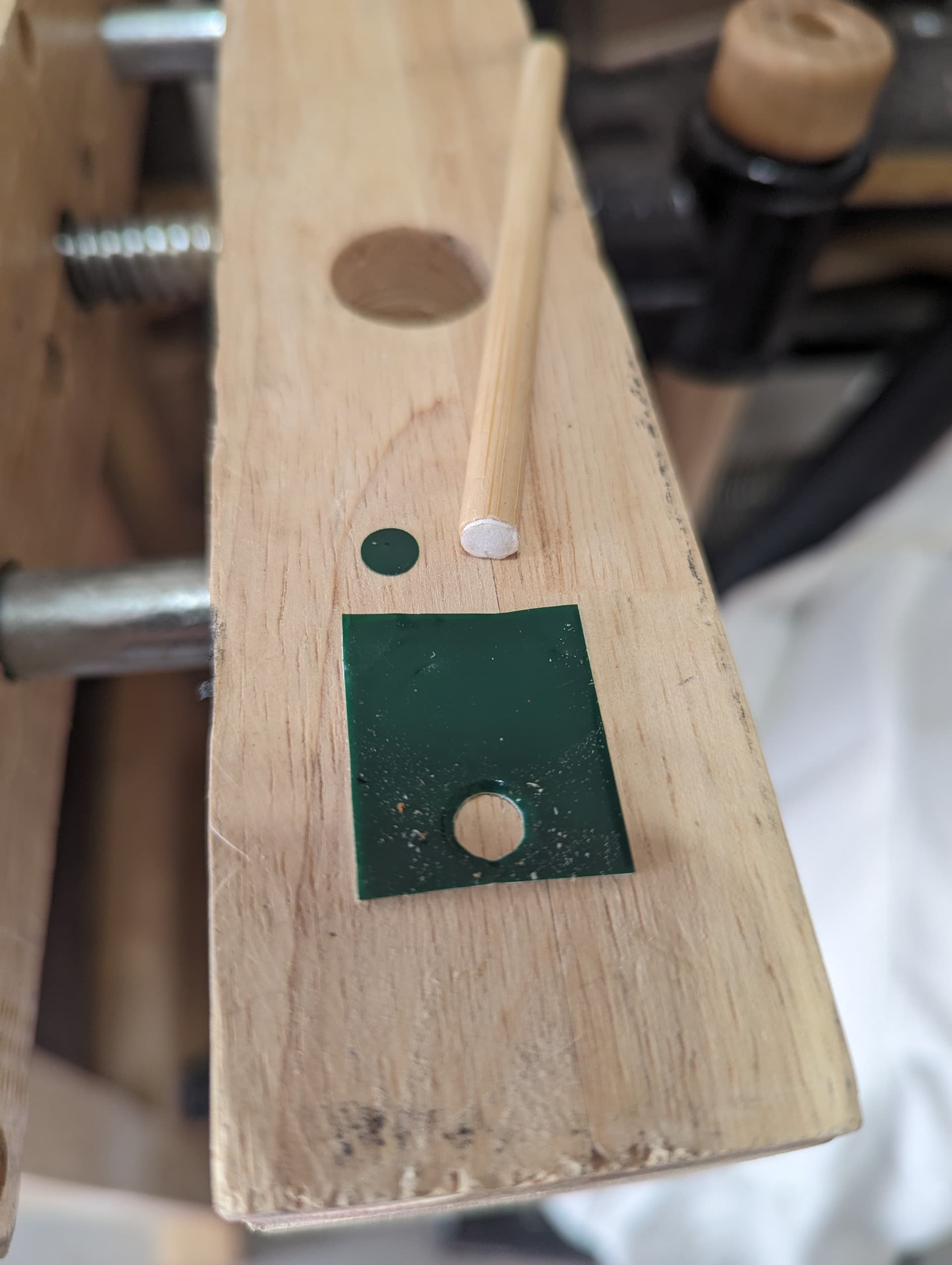

Just about finished assembly.
 ![PXL_20240422_220503533](https://canada1.discourse-cdn.com/flex031/uploads/maslowcnc/original/3X/d/7/d7ce515a0bc6379208f3a487a2cb8d7b218dea5d.jpeg)
A few suggestions/ideas:
Before starting, if you don’t have a 2mm Allen wrench handle, make yourself one from a 3/4" dowel or 3d print one. I took a 1" length of dowel, drilled a 2mm hole through it end to end then added a saw kerf on one end going half way down. Insert the provided Allen wrench into it and you will save yourself a lot of time and frustration.
 ![PXL_20240422_190926881](https://canada1.discourse-cdn.com/flex031/uploads/maslowcnc/original/3X/4/1/419875be9ace497a0313388e1d859366fb4953c5.jpeg)
Assembling the arms
I found that placing the rollers into the same half as the gears when putting two arm haves together was easier. I also used a small rubber mallet to encourage the two halves to mate together, being very careful to ensure everything was in it’s proper place and position beforehand.
A small rubber mallet also makes inserting the belts into the belt ends much easier (tap lightly).
Assembling the router
A 1/4" dowel will hold the nut in place while assembling the uprights, allowing you put the bolt in from the top. You only need about a 6 inch length. (Maybe future kits will provide one?)
-Mike
**Post date:** [April 22, 2024, 10:24pm UTC](https://forums.maslowcnc.com/t/til-assembly-suggestions/20760/2 "2024-04-22T22:24:56Z")
Those are excellent suggestions!
I especially like the Allen wrench handle…brilliant!

**Post date:** [April 22, 2024, 10:42pm UTC](https://forums.maslowcnc.com/t/til-assembly-suggestions/20760/3 "2024-04-22T22:42:49Z")
Thanks! You could also use a cork if you had one laying around.

**Author:** ![NKT](https://yyz1.discourse-cdn.com/flex031/user_avatar/forums.maslowcnc.com/nkt/32/24061_2.png) [@NKT](https://forums.maslowcnc.com/u/NKT)\
**Post date:** [April 30, 2024, 11:12pm UTC](https://forums.maslowcnc.com/t/til-assembly-suggestions/20760/5 "2024-04-30T23:12:11Z")
I, too, gave up on the allen key and got a 2mm “driver”. It is much better!
I also agree with your suggestion for the belt/gear assembly. I found it quite easy tbh - put your foot on the loose end, on the floor, then you can tension, position, and adjust with two hands before clamping together.
