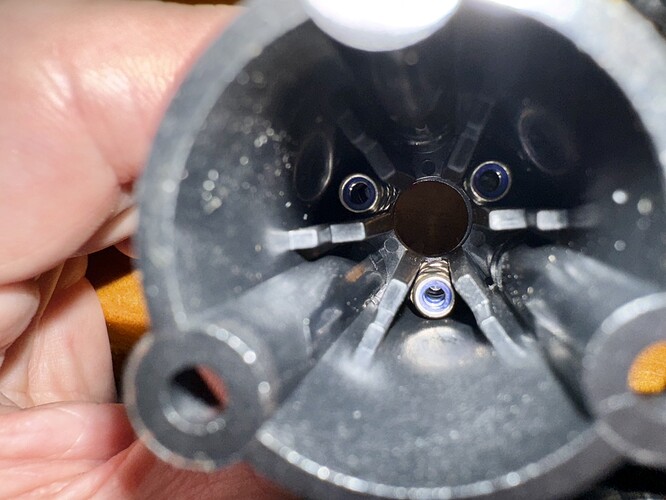

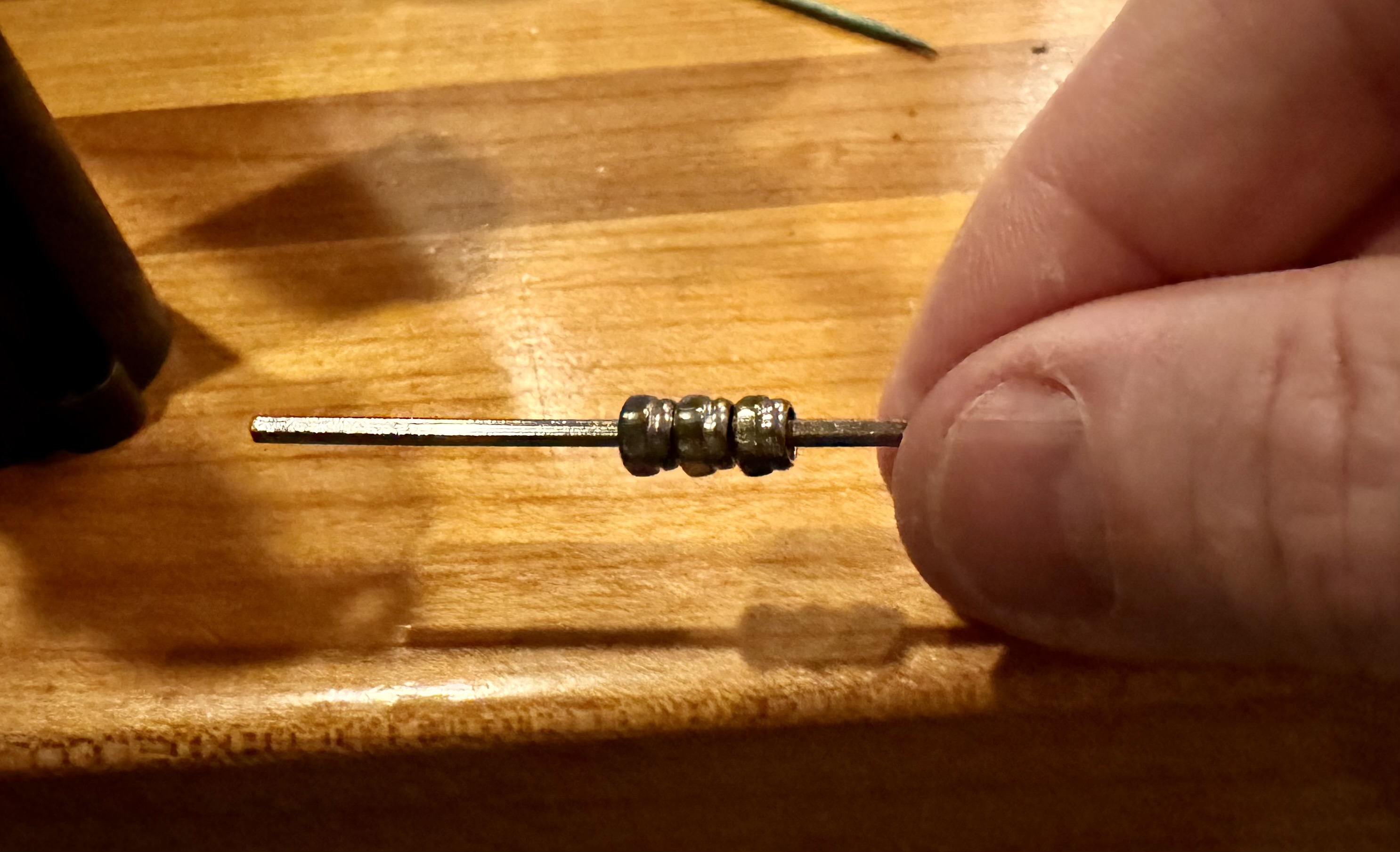

Here’s a tip for putting uprights together that made them a piece of cake!
Start by putting 3 nuts on the allen wrench to guide down into upright.

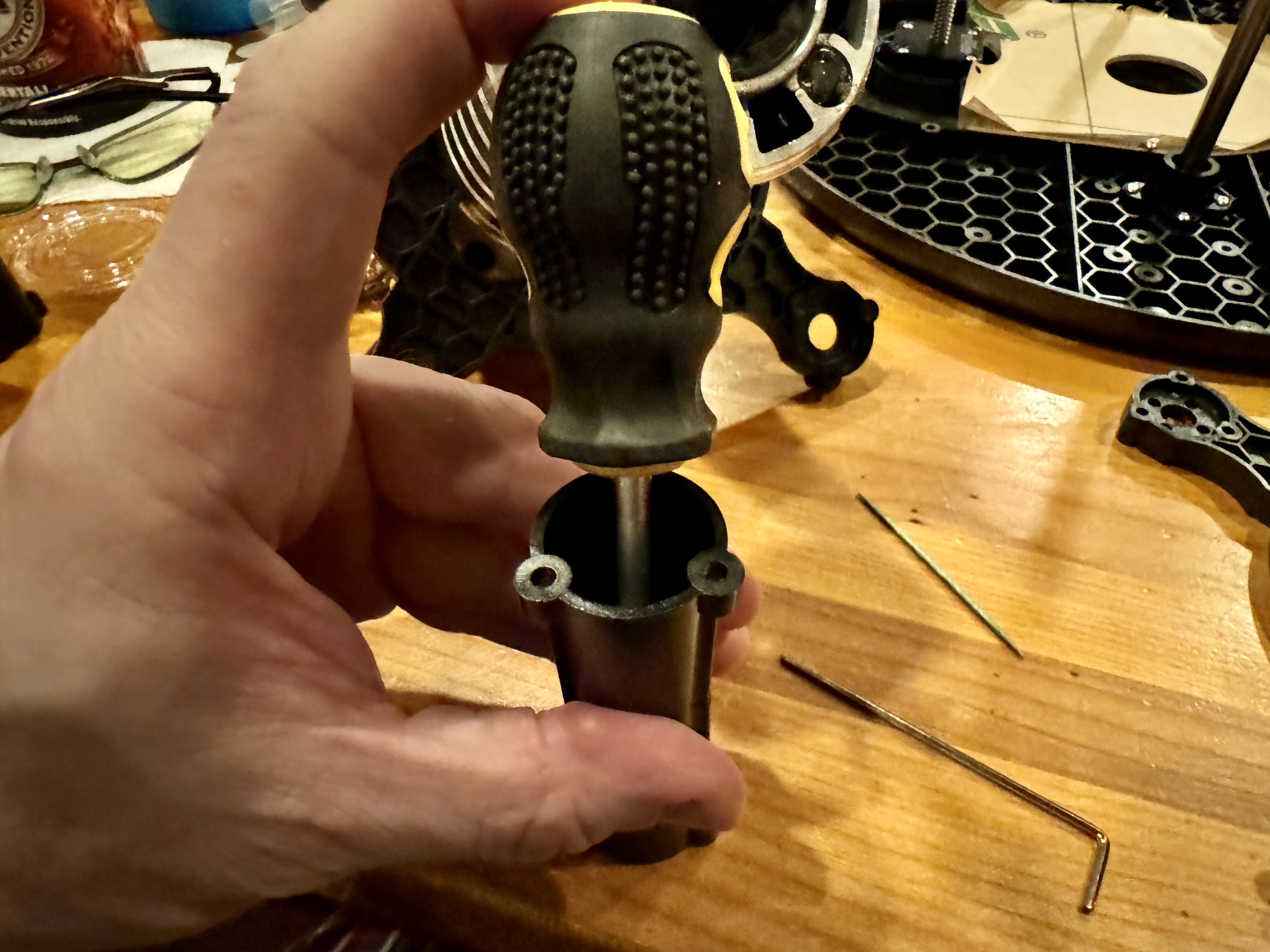

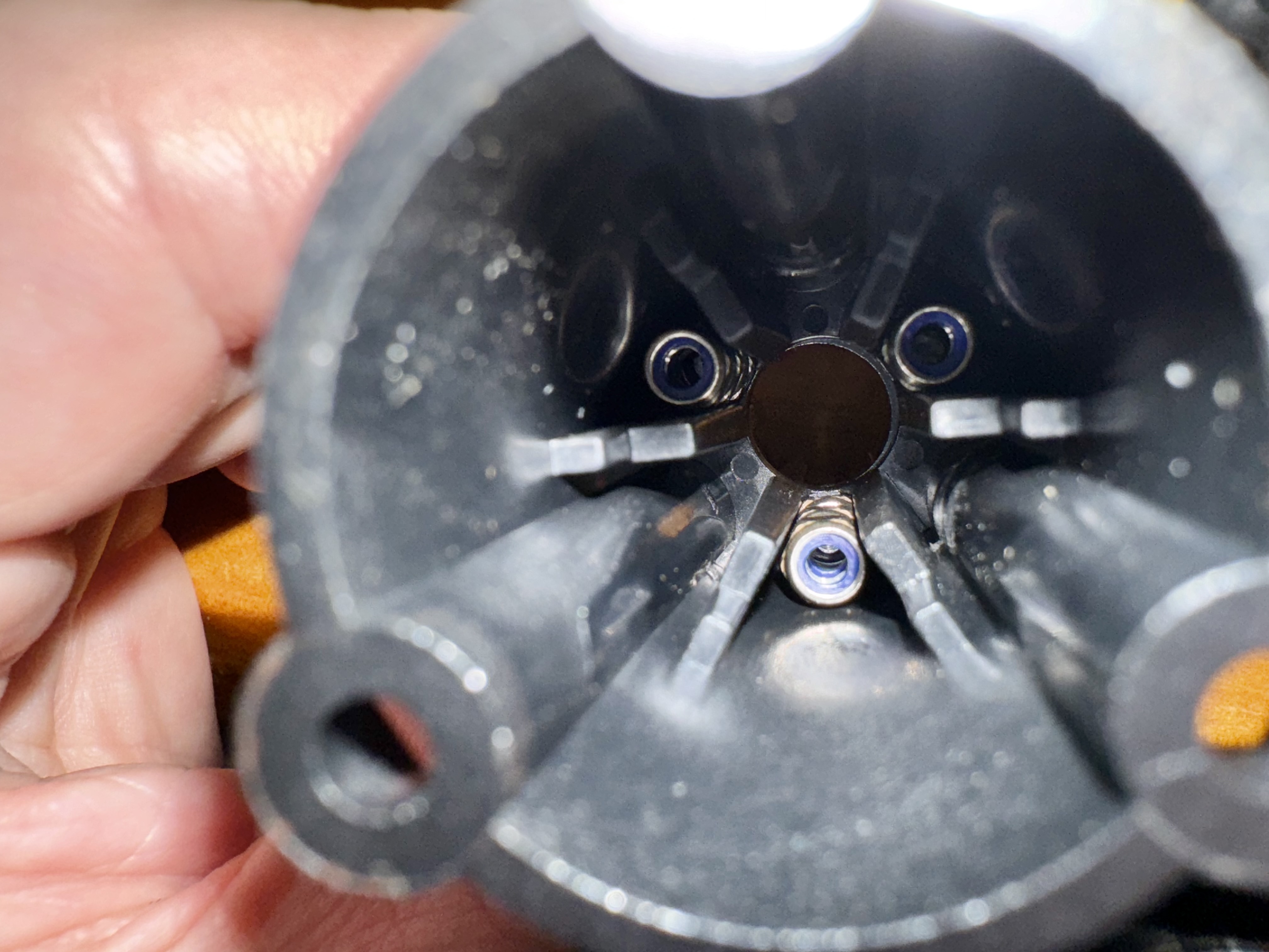

Then I used a stubby phillips screwdriver to hold the nuts down. The phillips fits right into the hole of the set of nuts.
 ![IMG_6739](https://canada1.discourse-cdn.com/flex031/uploads/maslowcnc/original/3X/4/d/4df808dd613a36377f3a91ede63bab47882fafd8.jpeg)
You can then very easily start each screw, then dump the extra nuts out, and tighten the screws up.
