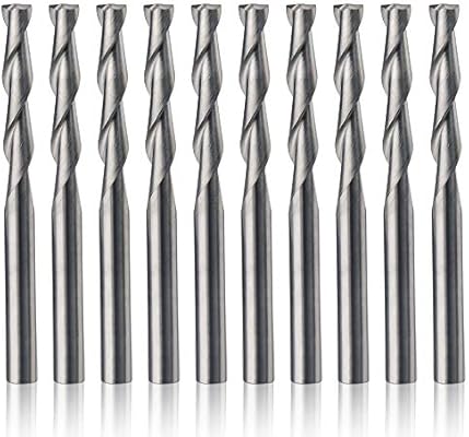

What kind of end mill should I use?
That depends on the job at hand, but I’ve been enjoying using these 1/8th inch end mills for general cutting. They are cheap and well made.
I prefer the suggested from the Wiki -
[https://www.homedepot.com/p/Diablo-1-4-in-Up-Spiral-Router-Bit-DR75101/204073552](https://www.homedepot.com/p/Diablo-1-4-in-Up-Spiral-Router-Bit-DR75101/204073552)
- correction ( I would suggest metioning these are 1/8th inch and depending on the router you have you may need to buy and additional 1/4 to 1/8 inch addaptor, this is inclludded with the suggested RIDGID Model # R22002 but may not with other brands )
I also suggest you add an option to include a “Starter Bit” with the kit in the store.
I will be getting a set of bits from Maslow as soon as I have my mine up and running.
Perhaps A deluxe kit could be offered with a “Set of Bits”

HD says those are 1/4, not 1/8".
FWIW I got a 1/2" collet set from MLCS that includes 1/8". Looks good but haven’t tried it yet. Have a fair collection of 1/8 endmills for the Zenbot Mini, sourced from the Drillman on eBay, that work well with the ZB. Plan to try them on the maslow

"What kind of end mill should I use?
That depends on the job at hand, but I’ve been enjoying using these 1/8th inch end mills for general cutting. They are cheap and well made."
this is the one shown in the FAQ -
> **[HQMaster CNC Router Bits 3.175 Router Bit 1 8 End Mill Flat Nose Carbide Endmill...](https://www.amazon.com/gp/product/B010NI39WO/ref=oh_aui_detailpage_o02_s00?ie=UTF8&psc=1)**
> HQMaster CNC Router Bits 3.175 Router Bit 1 8 End Mill Flat Nose Carbide Endmill Two Flute Spiral Upcut Milling Cutter Tool Set for Wood PVC MDF Hardwood 10Pcs - - Amazon.com
- I like the one shown in the Wiki because it’s 1/4 inch and it’s stated they work for a good 2 weeks non stop. This is why I chose to wait for that one.
I have the 1/8th inch ones shown above for my Shapeoko 3 - but I figured starting with 1/8th inch is asking for trouble as a noob it’s probably easier to break them. I’m learning 2 different CNC routers at the same time.
This all took place before the bits were added to the Maslow site.
Can anyone weigh in on 1/4 vs 1/8 inch and durability?

I’ve only run 1/8" engraving bits on my machine so far. Haven’t had any issue with breakage on the machine, but when I went to change tools on my last run the wrench slipped and I broke the tip off the engraving bit when it fell into my steel hardware cabinet next to it. Note to self: make sure there’s no steel within slipping distance when changing tools in the future 😛
Personally, I find the [1 flute 1/4" bits](http://www.maslowcnc.com/store/singlefluteupspiralbit) from the Maslow store are perfect for the machine. I tried 2 flute 1/4" bits first and the machine doesn’t have enough feedrate for them. The bits just end up wearing out rather quickly. I wore one out just trying to do calibration tests and cutting my first sled. Maybe it would seem like too much of a plug, but I would recommend the 1 flute bits make it to the FAQ.

I pretty much exclusively use the bits we had made at this point so I am totally biased, but I do like the 1/4 inch bits more because you can take off more material with each pass. I have also used 1/2 inch bits for doing larger pockets.
1/8th inch bits can be nice because they are CHEAP. I would like to explore using something like a rotozip bit to cut all the way through material in one pass at some point in the future.
