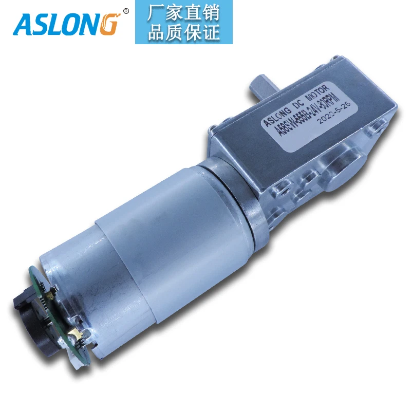

Thinking of upgrading the XY motors in the kit.
These new motors have all metal gears and double ball bearings. they are about the same speed. I’m going to see if Aslong can put on a new connector to match the exsisting cables. if not I can get adapter cable made I guess.
> **[US $36.5 |Self lock Mini DC Worm reduction case With Hall Sensor555dc worm...](https://www.aliexpress.com/item/32870598689.html?spm=2114.12010615.8148356.27.7287cb87tNk1F0)**
> Smarter Shopping, Better Living! Aliexpress.com
 ![IMG-4444](https://canada1.discourse-cdn.com/flex031/uploads/maslowcnc/original/3X/1/2/12b393ef80caead391288d5ead3b05118feeaf27.jpeg) ![IMG-4445](https://canada1.discourse-cdn.com/flex031/uploads/maslowcnc/original/3X/b/2/b201ca160b88487d9529f2da5a081d5724f94fce.jpeg) ![IMG-4446](https://canada1.discourse-cdn.com/flex031/uploads/maslowcnc/original/3X/9/e/9e43bddca01d985ac8ece296bcbd1e57279c78d4.jpeg)
This is the motor currently used:
[http://www.etonm.com/products\_detail/productId=89.html](http://www.etonm.com/products_detail/productId=89.html)
It just has bare metal shaft, no bearings on either side and one plastic gear.
I need to test them out and see how long they last.
any suggestions for good testing methods?
I would imaging cuting at the top middle would be the most stressful test and best way to quickly see if any issues come out?
any motor experts out there let me know what you think please.

Just my 2 Fils, the RPM is just a fraction smaller then the [current]([https://github.com/MaslowCNC/Electronics/blob/master/Documentation/Data%20Sheets/ET-WGM58AE-1220.6(20171108003-H16035）%20Model%20(1).pdf](https://github.com/MaslowCNC/Electronics/blob/master/Documentation/Data%20Sheets/ET-WGM58AE-1220.6(20171108003-H16035%EF%BC%89%20Model%20(1).pdf)) motor. Thinking that we soon will have acceleration and deceleration planing, would it make scene to look for new motors that can provide more speed?
Edit: Do you have a data-sheet with the ‘on load torque’?

**Post date:** [August 27, 2020, 6:41pm UTC](https://forums.maslowcnc.com/t/upgrading-xy-motors-to-double-bearings-and-all-metal-gears/14450/4 "2020-08-27T18:41:45Z")
> [@Metalmaslow](#):
> higher voltage
That would mean new power supply and perhaps new motor shield. Can’t find a data for the TLE5201, but the 9201 seems to handle 28V, can’t tell about the other components on the board. Changing from 12V to 24 should speed them up I guess. 🙂

For reference, the original motor was ET-WGM58AE-1220.6 (20171108003-H16035).
etonm is listing a **ET-WGM58A-1220.6** with (E missing) with higher specs (no-load and on-load) than in the data sheet we have and a **ET-WGM58A-1227.6** with specs almost matching the current motors more.
