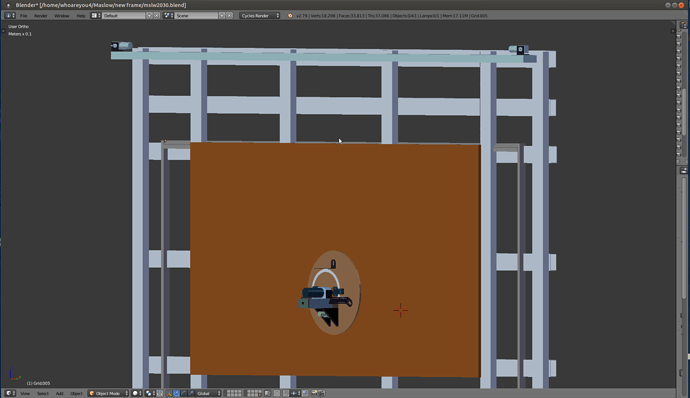

@Gero, @WoodCutter4, @Keith this is an image of what I have. I need to clean it up a bit and then I’ll post the blender file. I have pulled out the colored pieces that I had to make (other than cutting wood). The blue motor stand is a 3d printed part and works with the existing z-motor, the Yellow piece was 3d printed, and turns out to be useless (but it looked cool), the red plate is 1/4" steel (from Home Depot). It has holes that mate the spindle to the aluminum carrier. Getting that drilled/threaded right was the hardest part. **I think there’s a better place to post/share this (help me out!)** so I’ll post the complete model there, along with info about the purchased parts.
 ![Selection_397](https://canada1.discourse-cdn.com/flex031/uploads/maslowcnc/original/2X/a/a37d9a0b5b0769eb04a3dad9acaa77ef0fb71830.png)
This is an 18" dia sled; 5/8" thickness.
I’m actually going to drop mine down to about 17.75" x 3/4" because I got a sheet of HDPE for about $30 that I think will work well.
I need to work on speeding up the z axis travel because this thing is light and could go much faster than the Rigid. I think Z could travel as fast as that motor can drive it (certainly in +z). Thoughts on that would be appreciated too.
Dave
