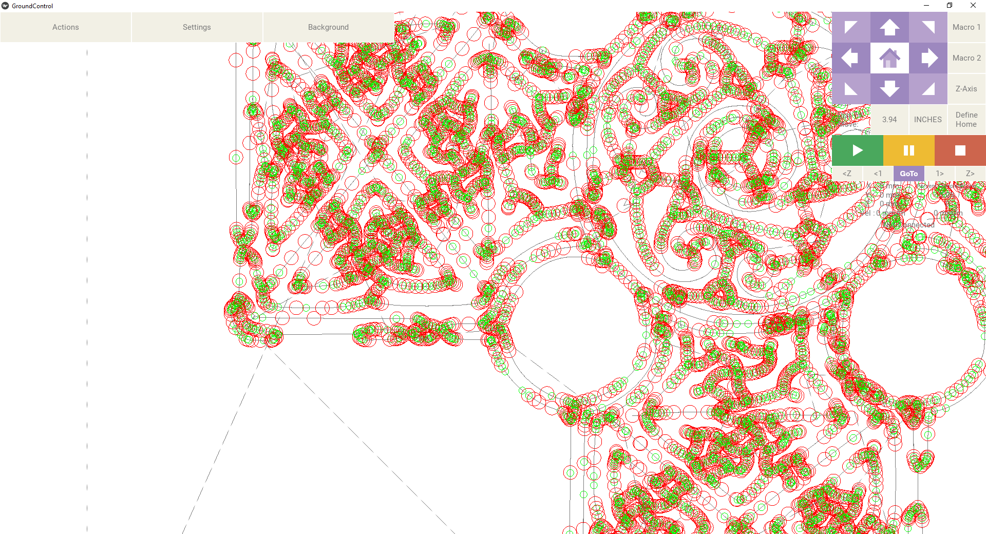

Then, since I’m learning and experimenting, I figured, do a complex one of a celtic cross with lots of knot work, but now it is super slow, after several hours it is only up to 6%. Here is the path (or a bit of it) in Ground Control:
 ![image](https://canada1.discourse-cdn.com/flex031/uploads/maslowcnc/original/2X/6/6f5b13439a196cd647d7daba2a94f282ad627a90.png)
GCode looks like this:
G90

As you can see, it’s extremely detailed.
Any suggestions of what I might have done wrong?
### Author: ![Gero](https://yyz1.discourse-cdn.com/flex031/user_avatar/forums.maslowcnc.com/gero/32/17487_2.png) [@Gero](https://forums.maslowcnc.com/u/Gero)
#### Post date: [January 21, 2019, 9:01am UTC](https://forums.maslowcnc.com/t/v-carve-super-slow-and-too-detailed/8555/2 "2019-01-21T09:01:49Z")
Are you using the original z-motor with the Rigid router? The large amount of z-moves is what is slowing thigs down. Without and hardware upgrade there is hardly a chance to speed Z up. Nice work though.
Edit: Around 15000 lines of g-code GC might crash due to an assumed memory limit in rendering to many z-moves on the screen. Reference: [Random jumps down when running gcode](https://forums.maslowcnc.com/t/random-jumps-down-when-running-gcode/1564/17?u=gero)

Thanks for your reply - yes, it’s the original Z-Axis with Rigid router.
I guess going forward I’ll have to check amount of detail and speed before starting a cut.
