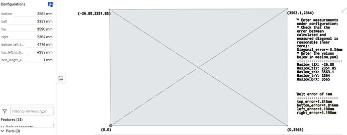

#### Post date: [December 9, 2025, 7:03pm UTC](https://forums.maslowcnc.com/t/version-1-15-testing-and-feedback/25263/24 "2025-12-09T19:03:54Z")
This is super helpful! Thank you for taking those measurements!
From my calculations I’m finding (Mostly for my own memory so I don’t forget):
TLX: 26.879
TLY: 2351.84
TRX: 3563.1
TRY: 2363.99
BRX: 3565
#### Post date: [December 9, 2025, 9:29pm UTC](https://forums.maslowcnc.com/t/version-1-15-testing-and-feedback/25263/25 "2025-12-09T21:29:49Z")
yep, same results from my onshape based calculations. much better than the prior numbers I was using.
