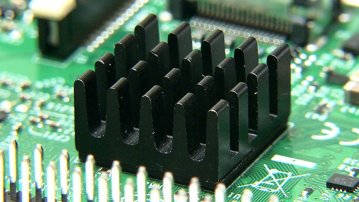

So I ordered a Pi 4 - not 1 but 2, I got the big Mama expecting good things. Spoiler - This is the biggest Turd of PC I’ve recently experienced.
First I tried to download “Buster” the new OS - It only took 6 hours. I tried to download Noobs, the package is incomplete and won’t boot. That was only 4 hours to download. After trying 4k HDMI cables that work with my other video tools, No 4K screen, I must have tried 30 diffrent combinations. Finally I say F\*ck it - I hull out a 22 inch 1080p monitor - Bingo it boots. I get a desktop and 3 seconds in the PI locks up. Basically it keeps overheating, I’m using the PI Foundation case and Power Brick. I took the top case off. I can keep it running if I blow on it. I’ve rebooted at least 35 times getting through a basic boot, config, browsing. I got to a config option to “enable 4k” not impressed, 4k is no go on a 40 inch 4k LG Computer Monitor, & a 50 inch Vizio TV even after Enabling 4K support.
It’s 80F degrees where I’m at. I’m totally disappointed, if I have to buy a $35 cooling solution for a $35 computer it’s a wash. I think they let this one out too soon. No doubt a better management profile will come out later, it will throttle back the “upgrades” to drop the heat. Every 2 minutes the USB bus froze my keyboard required a unplug and plug to gain a UI again.
I think I will try to return both of them and eat the $60 in shipping. Hardware has big problems, software is not ready. Don’t buy this.
Be ware currently USB booting is not available on the new hardware. Also the CPU will burn to the touch at idle usage the entire board gets hot.
All of the peripherals I’m using work with the Pi 3B+, The range on the keyboard dropped from 20 ft to 3 inches. There is some seriously bad interference coming off this board.
Take my review with a grain of salt. With a heat sink and fan it might work better, but a pig with lipstick isn’t a date.

Yes, it needs heatsinking. get yourself a decent heatsink and it will be faster than the pi 3. without one, it will throttle and be slower.
> **[Raspberry Pi 4 Benchmarks - Heatsink Edition](https://www.cnx-software.com/2019/06/27/raspberry-pi-4-benchmarks-heatsink-edition/)**
> A Raspberry Pi 4 with heatsink is shown to perform much better for multi-threaded benchmarks compared to using the board "naked".
you should be able to use any old heatsink you have lying around, it doesn’t need to be anything special, but it does need to get the heat away from the lidded chip faster. really, they should come with a heatsink, but it shouldn’t cost more than $5-10 if you don’t already have one lying around.

OK - from pervious testing I had a 2 fan heatsink for the Pi in my junk pile. I put it on the new pi4 a $15 add on. Surely it will work better now right? The heat is still coming through the bottom of the board. It locked up after 3 minutes playing video in a window from CNN. Yea I use CNN for testing not Youtube. It just goes black on the screen and can stay down for more than half a minute. What an awesomely useless interface.

Pi 4 now much happier -
> **[Amazon.com: Enokay Raspberry Pi 3 Model B B+ Dual Fan with Raspberry Pi Heatsink...](https://www.amazon.com/Enokay-Raspberry-Model-Dual-Heatsink/dp/B07LBRWGCN/ref=sr_1_6?keywords=pi%2Bheatsink%2Bfan&qid=1562726974&s=gateway&sr=8-6)**
I had to clip off the POE header to install it.
I ran the updates for the OS
I got and installed the firmware update:
[https://www.raspberrypi.org/forums/viewtopic.php?f=28&t=243500&p=1490467&hilit=vl805#p1490467](https://www.raspberrypi.org/forums/viewtopic.php?f=28&t=243500&p=1490467&hilit=vl805#p1490467)

You can check your temperature with this command:
/opt/vc/bin/vcgencmd measure\_temp
