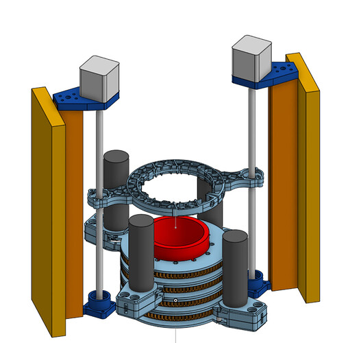

Here is a twist on the maslow idea. This uses ‘standard’ leadscrew steppers (not low profile and using a standard leadscrew length rather than a special order) and gives about 4in (just under 100mm) of Z travel, which would make bit changes much easier. The clamps also cannot run off the top and we can put homing sensors/stops at the top to be able to home away from the workpiece.
It has slightly better side/top angles than stock (instead of about 40 degrees with the stock maslow, this gets about 30 degrees for arms where there isn’t a leadscrew and about 35 degrees where there is, unless we make the ears to the screw leads thinner)
by trimming off the ears and using the lead screws instead of the guide rods, we eliminate the angle problem in the corners.
This gives us full green coverage on a 4x8 sheet of plywood on a 10’x7’2" (3048x2184mm) frame
The vertical braces have right angle braces, so would be far more rigid than the current towers. those braces are about 4" wide (and the arms will hit the clamps before the belts hit the braces) which gives room to mount power supplies, electronics, etc.
I don’t know if the 8mm lead screws would be weak enough to be a problem. The force is applied to the router so they don’t have to handle cutting forces, just dragging the sled along. but if the arms end up riding on a cylinder attached to the base, all they need to do is to move the spindle up and down with the cylinder handling all the forces (requires a code change to support)
I haven’t worked on dust collection, if you do use a rigid cylinder, could you suck up past the spindle (cooling the spindle in the process)???

This looks excellent!
I think it might be a good idea to extend the gray motormount piece so that they also connect to the yellow straight pieces for a healthy dose of extra rigidity, need to carve a slight recession in the yellow pieces so it can simply be glued together using a couple of clamps. The gray motormounts could also have some slight recessions to help get a firm and properly set mounting position, with the use of ply and wood glue I do not think screws are needed at all.
Very good job!

Would be much more resilient against certain forces if there was at least one guide rod per lead screw.
You all know that guy that needs a bit of extra consideration from time to time, his name is Case, Justin Case.

how much force is involved and are the 8mm lead screws rigid enough? adding 6mm
guide rods would not be a significant win, how large would you want to add?
aligning the lead screws and the guide rods adds a thing that can be done wrong,
so if we can get away without it, that is a win.

The stepper mounds do have a recess to notch into the towers. I designed both square and diamond mounts (initially looking for the motors to interfere with the steppers less, but then decided that there was enough height to just have the Z axis stop so the motors clear the mounts). With the square mounts, you could mount the motors below the mount, leaving less stuff to catch at the top (at the cost of the towers being taller) you could also put bearings on the towers just above the top clamps to add rigidity to the leadscrews (reducing their unsupported length from 300mm to 200mm)
 ![image](https://canada1.discourse-cdn.com/flex031/uploads/maslowcnc/original/3X/5/2/529a4c54784eef3c10cabda4fc217a8f638c3163.jpeg)
There is a lot of room to tinker with dimensions, use a dado in the yellow pieces, etc. Those tower pieces were shown as straight just as that was the simplest to model.
But the best way to make improve the rigidity is to make a cylinder that is solidly mounted to the sled and ahve the arms ride on that rather than going up and down with the spindle
