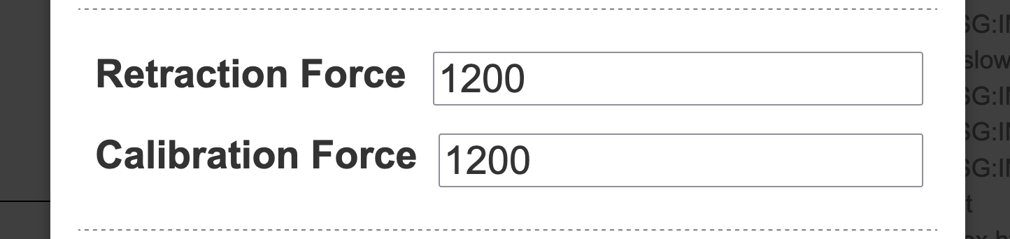

I have noticed that the maslow doesn’t always have all arms respond to initial movements.
For example, when I am releasing the tension a lot of times, only three out of four arms will respond and I will have to click the button again to get the fourth arm to respond. The same thing with retracting belts, sometimes there are one or two arms that don’t respond on the first click.
This has got me wondering about my calibration. I really have no idea what is going on during calibration. From what it looks like, there’s usually one or two arms that is slack, but it does not seem to follow a pattern, so this makes me think that maybe my calibration is off or so low because at some of the different points some arms are not pulling in the tension when they should or not releasing when they should.

That makes some sense because what is happening when you release tension is that it’s giving the arms the option to extend if there is some force pulling on them, but it’s not actually driving the motors to extend the belts. If one (or more) arms doesn’t have any tension on it it won’t release.
> [@Allen1](#):
This I think has more to do with the retraction force setting. Bumping up the amount of force that the machine uses when retracting the belts should fix that:
 ![image](https://canada1.discourse-cdn.com/flex031/uploads/maslowcnc/original/3X/e/f/efdf6d1a06330bed823d3ebaaf1f803695bbb2de.png)
If you are having issues with calibration it could help to increase the calibration force too.
